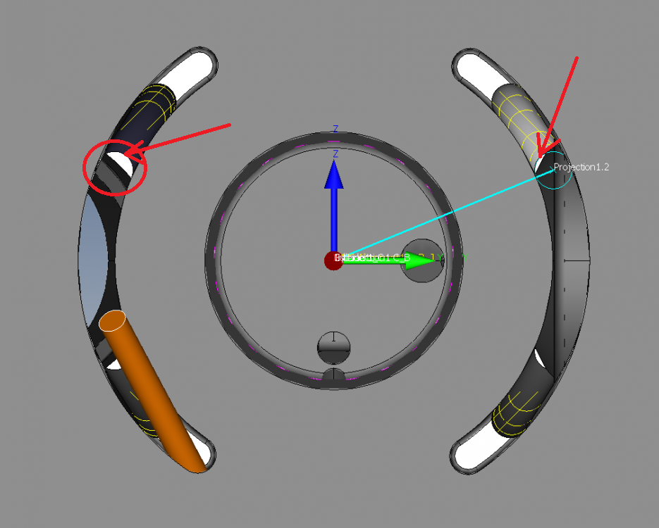

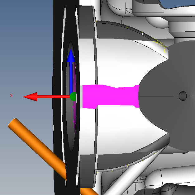

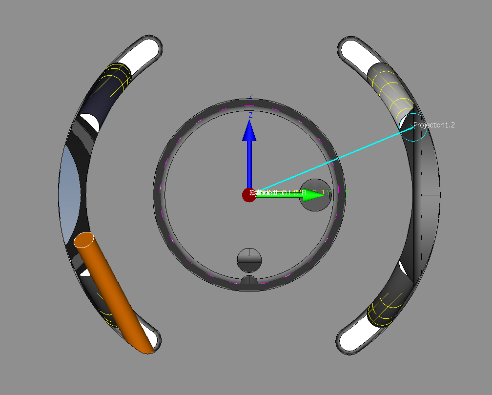

[Ri...] Posted May 20, 2025 Share Posted May 20, 2025 The blueprint wants the end of the depth of a curved feature to be 22.5° rotated from the Y axis (Normal to X). See slot1 image simulating the angular location. The problem I am having is figuring out how to measure the feature to produce the theoretical values as I have displayed. Creating the nominal values, easy peasy (Although I have found my geometry is off by about .0007 in Y and Z, I think it's a model error). The endmill that produces the feature is normal to my X axis, this is what generates the small flat (Plane) at the bottom (End of feature). I can't figure out how to create a measured circle to represent the end of the feature, even my freeform scans are normal to my X axis, as created from Sections of the model. The plane at the end of the feature is very small, not scannable or capable by points other than a single point for its depth. I have a couple screenshots to share. This is hard to describe, hopefully someone may be able to follow this. 1 Link to comment https://qualityforum.zeiss.com/topic/23485-need-assistance-with-some-geometry-of-a-model/ Share on other sites More sharing options...

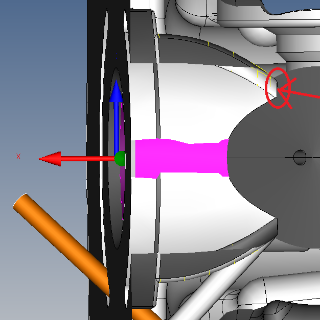

[Ch...] Posted May 20, 2025 Share Posted May 20, 2025 Rick, are you reffering to this arc, see attached marked up pics.. If you're measuring a FFS for profile and the model is not correct, I would kick back to Engineering. Is this is a curved cylindrical feature?, this would definitely be a challenge. Is there a surface at the bottom of it ? Since FFS does not really intersect with anything well, your best option might be to slice the CAD to create perhaps 3x 3d Lines down the curved cylinder. Measure a plane at the end, and hope that the 3D lines give you an intersection with the plane. When I need to use a plan for an intersection but do not have enough room for more than one point, I simply measure one point, select the plane from the CAD make it THEOretical then makes its actual Z the same as the measured point. From there use the 3 intersection to make a circle to find your angle. Crafty - but just might work. 1 Link to comment https://qualityforum.zeiss.com/topic/23485-need-assistance-with-some-geometry-of-a-model/#findComment-132453 Share on other sites More sharing options...

[Ri...] Posted June 2, 2025 Author Share Posted June 2, 2025 We don't have Curve, just FreeForm. What I ended up doing, is creating three lines near the bottom along the slope to create points projected to the theoretical plane and then create a circle. Offline, it works. I will have to wait to try this online and see how it goes. There isn't a lot of curve on that surface for the last .100 of that helix path so I am hoping for the best. 1 Link to comment https://qualityforum.zeiss.com/topic/23485-need-assistance-with-some-geometry-of-a-model/#findComment-133065 Share on other sites More sharing options...

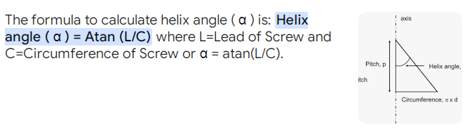

[Ma...] Posted June 2, 2025 Share Posted June 2, 2025 Please sign in to view this username. So you want to get angle of helix? That's your 22.5°? That could be possible to calculate if you can get upper circle and lower circle. If you add a middle circle, then you can assume fixed axis -> now you have a radius. With starting circle and ending circle you have your start angle and end angle - so now you can calculate length of radius. With length and depth you can calculate that angle. 1 Link to comment https://qualityforum.zeiss.com/topic/23485-need-assistance-with-some-geometry-of-a-model/#findComment-133067 Share on other sites More sharing options...
