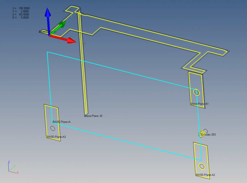

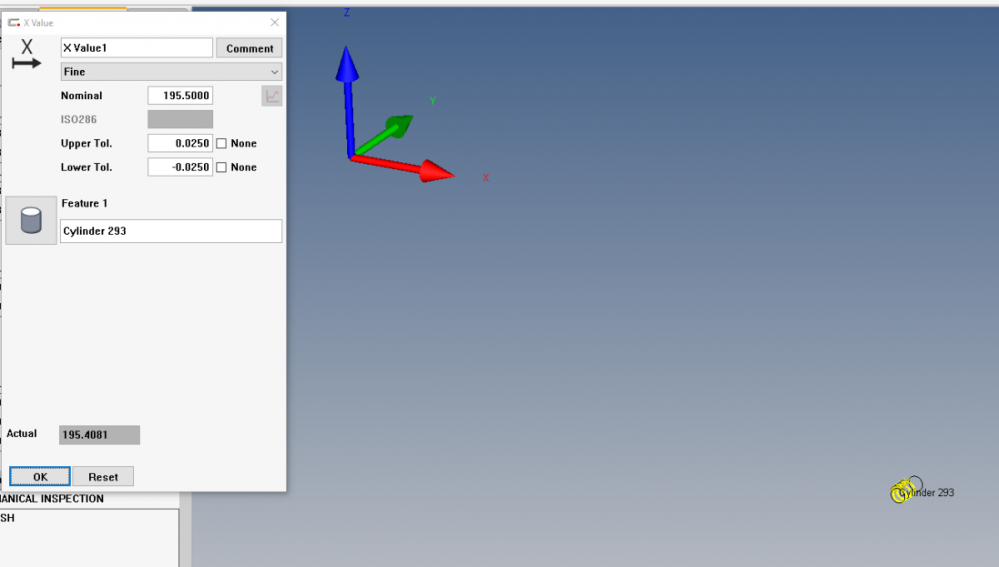

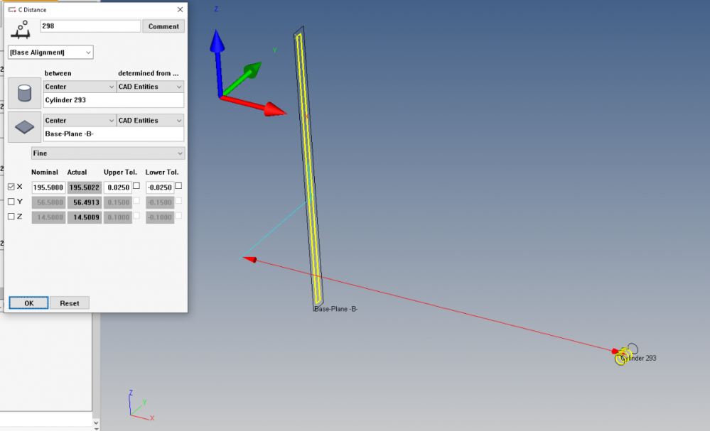

[Ca...] Posted May 20, 2025 Share Posted May 20, 2025 There is a .004'' discrepancy from caliper x distance vs just x callout. Caliper is using base alignment from plane(plane is use for planer rotation and zero on x) to hole x distance callout. I'm assuming just x call out of hole is also using base alignment so why the discrepancy? Link to comment https://qualityforum.zeiss.com/topic/23489-caliper-vs-xyz-distance/ Share on other sites More sharing options...
[Cl...] Posted May 20, 2025 Share Posted May 20, 2025 Check the caliper distance evaluation. It could be set to Maximum or Minimum. Link to comment https://qualityforum.zeiss.com/topic/23489-caliper-vs-xyz-distance/#findComment-132483 Share on other sites More sharing options...
[Ca...] Posted May 20, 2025 Author Share Posted May 20, 2025 (edited) I have and they are evaluated at center. I found the .004'' difference. X callout is center of base alignment to hole whereas caliper distance is center of plane B to hole. Edited May 20, 2025 Link to comment https://qualityforum.zeiss.com/topic/23489-caliper-vs-xyz-distance/#findComment-132485 Share on other sites More sharing options...
Popular Post [Ma...] Posted May 20, 2025 Popular Post Share Posted May 20, 2025 Please sign in to view this username. Sorry, but you have a mistake there. If you want to have same result you have to use that Base-Plane -B- as rotation in space or at least as planar rotation and as X origin. Value on X,Y,Z is from origin of feature - for plane it's one of corner. Using caliper distance and "Center" is from center of feature, so if that -B- plane is not perpendicular to plane -A- and -C- then there will be always something. 5 Link to comment https://qualityforum.zeiss.com/topic/23489-caliper-vs-xyz-distance/#findComment-132491 Share on other sites More sharing options...

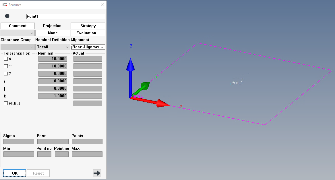

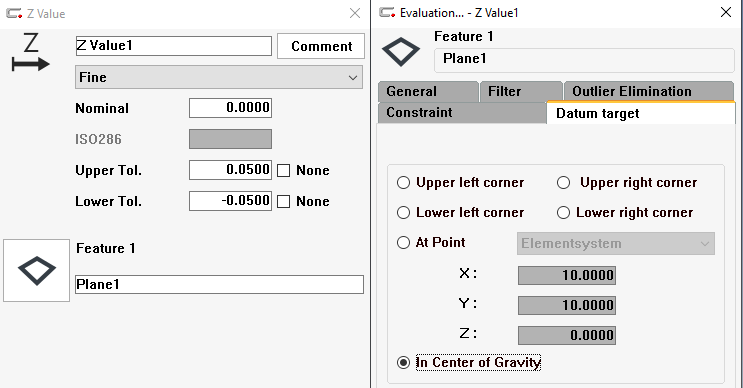

[Ma...] Posted May 22, 2025 Share Posted May 22, 2025 Please sign in to view this quote. Either you recall "Plane" to a "Point" feature or edit a "Plane" element in Characteristics tab where you can select which point of a plane will be evaluated. 1 Link to comment https://qualityforum.zeiss.com/topic/23489-caliper-vs-xyz-distance/#findComment-132621 Share on other sites More sharing options...
[Ma...] Posted May 22, 2025 Share Posted May 22, 2025 I will just add, that result may vary, because of measured points. So it's the same as using point with recall measured points. Link to comment https://qualityforum.zeiss.com/topic/23489-caliper-vs-xyz-distance/#findComment-132623 Share on other sites More sharing options...
[To...] Posted May 22, 2025 Share Posted May 22, 2025 Please sign in to view this quote. Good job Mateusz.... I never noticed that before. Does anyone remember this option being located in the feature, i.e. back in the 2000's? Or, is my brain starting to fade?...lol Link to comment https://qualityforum.zeiss.com/topic/23489-caliper-vs-xyz-distance/#findComment-132635 Share on other sites More sharing options...
