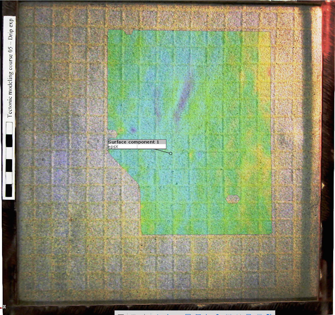

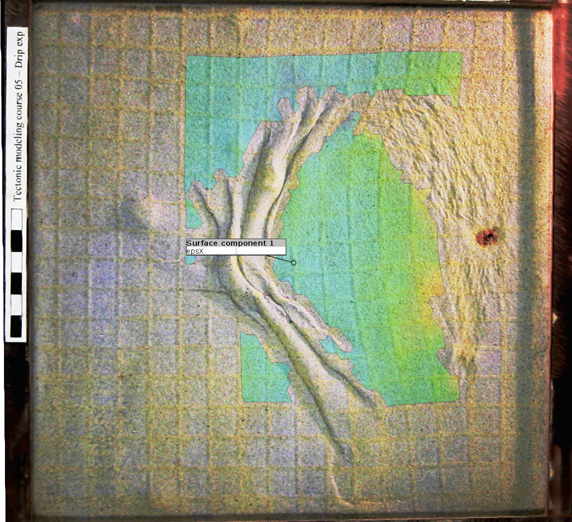

[Ca...] Posted May 24, 2025 Share Posted May 24, 2025 Hello, I’m trying to perform a strain analysis on an analogue tectonic experiment, but it seems that Zeiss Correlate avoids the areas where heavy deformation occurs. Is there any way to fix this issue? These are actually the most important regions for the experiment. Also, since the experiment was conducted in 2006 without considering optical strain measurement, the pattern quality is quite poor. However, there are very clear grid lines, if that helps in any way. Link to comment https://qualityforum.zeiss.com/topic/23517-unwanted-skipping-of-deformed-areas-during-strain-analysis-%E2%80%93-how-can-i-fix-this/ Share on other sites More sharing options...
[Mo...] Posted November 12, 2025 Share Posted November 12, 2025 Hello Can, As I can see from the distorted image, the distortion in the second image is too great, which leads to a destruction of the facets. You can try larger facets with larger spacing, but this has a negative local effect. You can also try adjusting the interpolation while constructing the surface component, but with a value of 1 or 2, as this will affect your solution. Of course, I'm not sure if this will work, but you can try it. Regards Mohamed Link to comment https://qualityforum.zeiss.com/topic/23517-unwanted-skipping-of-deformed-areas-during-strain-analysis-%E2%80%93-how-can-i-fix-this/#findComment-141823 Share on other sites More sharing options...
