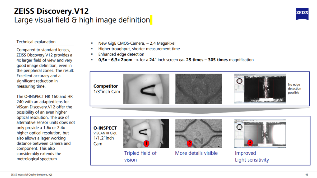

[Ja...] Posted May 29, 2025 Share Posted May 29, 2025 Hello All, Concerning (10) Magnification Settings on the O-Inspect ( 0.5x to 6.3x) is there document or reference table available which lists the approx. magnification for each level? For example, the first level on the O-Inspect (0.5x) may equal (10x) magnification? Our engineering department has been asking for an rough estimate for each level. Thanks in advance. Link to comment https://qualityforum.zeiss.com/topic/23579-o-inspect-magnification-question/ Share on other sites More sharing options...
[To...] Posted May 30, 2025 Share Posted May 30, 2025 I found this on-line. Note the mag reference to a 24" screen Link to comment https://qualityforum.zeiss.com/topic/23579-o-inspect-magnification-question/#findComment-133007 Share on other sites More sharing options...
[Ja...] Posted June 2, 2025 Author Share Posted June 2, 2025 Tom, Thanks for providing this information. It is a great reference, particularly for the lowest and highest level on the O-Inspect. Link to comment https://qualityforum.zeiss.com/topic/23579-o-inspect-magnification-question/#findComment-133055 Share on other sites More sharing options...
