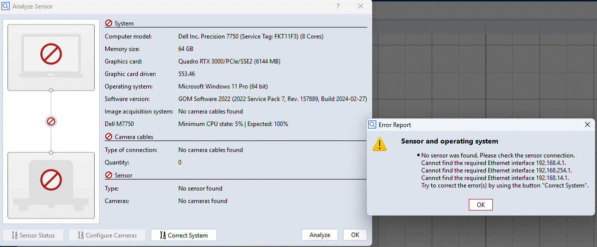

[Au...] Posted June 3, 2025 Share Posted June 3, 2025 Hello, I upgraded the laptop the ATOS Q camera is using to windows 11. Since then, every so often when I turn on the camera it does not initialize and when I go to help > System Analysis > Sensor and after it doesn't find it I have to click on Correct System and restart the computer. After that it works. The Camera is attached through the thunderbolt connection straight to the laptop. Below is the error I get when it looks for the camera. Any help would be great. Link to comment https://qualityforum.zeiss.com/topic/23593-intermittent-no-sensor-found-error/ Share on other sites More sharing options...
[St...] Posted June 4, 2025 Share Posted June 4, 2025 Hi Austin, it seems that the ethernet device is not set up correctly. Have you tried to use the correct system button? That should fix your issue. Link to comment https://qualityforum.zeiss.com/topic/23593-intermittent-no-sensor-found-error/#findComment-133171 Share on other sites More sharing options...
[Au...] Posted June 4, 2025 Author Share Posted June 4, 2025 Yes I have to use the correct system button every time this comes up. it fixes it for a few days but then it comes back again. Link to comment https://qualityforum.zeiss.com/topic/23593-intermittent-no-sensor-found-error/#findComment-133191 Share on other sites More sharing options...
[St...] Posted June 19, 2025 Share Posted June 19, 2025 Hi Austin, Hardware issues are hard to fix via the forum. Please contact you local partner/SSC to get help. Link to comment https://qualityforum.zeiss.com/topic/23593-intermittent-no-sensor-found-error/#findComment-134071 Share on other sites More sharing options...
[Ja...] Posted June 20, 2025 Share Posted June 20, 2025 I havent used win 11 with atos systems , but as a guess iit sounds like the ip addresses for your card are being reset every time you turn on your pc. This could be that the settings in the card arnt set to havs a fixed ip adress , an external it policy thing or perhaps windows itself. Agree hardware issues are extremely difficult to resolve without physically diagnosing. Link to comment https://qualityforum.zeiss.com/topic/23593-intermittent-no-sensor-found-error/#findComment-134125 Share on other sites More sharing options...
