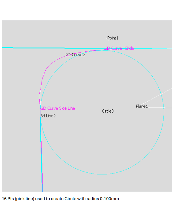

[Su...] Posted June 4, 2025 Share Posted June 4, 2025 I have a valve leaf .381mm thick. The edge radius is .095mm. Probe is 1.5mm. I need to measure the radius. I measured a 2D Curve on the edge radius and made a theoretical circle with the points to get radius. I lessened the probe pressure from 100 to 50(too low?). Is this correct measuring process? Is there a better way? Using a Contura Select with a Vast XT Gold. Link to comment https://qualityforum.zeiss.com/topic/23599-measuring-a-small-radius/ Share on other sites More sharing options...
[Ma...] Posted June 4, 2025 Share Posted June 4, 2025 Keep slow scanning speed and play with density of points - then it's ok. 50nM is ok too. Are you having any problems with stability of results? 1 Link to comment https://qualityforum.zeiss.com/topic/23599-measuring-a-small-radius/#findComment-133183 Share on other sites More sharing options...

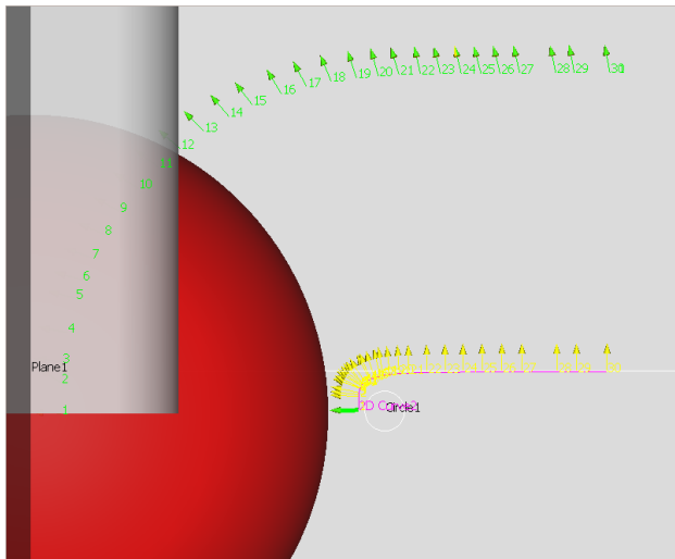

[Cl...] Posted June 4, 2025 Share Posted June 4, 2025 (edited) If it is a small circle segment <180°, then under the circle feature evaluation, constrain the two axis (Which ever work-plane the feature is in). In addition, I would use single points instead of a curve. If the thin material is wavey, I would probe single points on the top surface at the same coordinates as the radial points and use a formula to get the correct Z value to help compensate for variations in Z due to the waviness. Edited June 4, 2025 1 Link to comment https://qualityforum.zeiss.com/topic/23599-measuring-a-small-radius/#findComment-133187 Share on other sites More sharing options...
[Su...] Posted June 4, 2025 Author Share Posted June 4, 2025 Working without a print, guessing at some feature angles and radius at profile area. Since the area is so small not sure if scan is perp to the part. Scan speed at 1.0 tends to jump a bit but deleting those flyers leaves me with 16 pts on the curve to construct a circle. Nitrile probe and not ruby, smallest probe I have. Yes, <180 coming in at 88.1deg. Not sure if my result is 100%. Link to comment https://qualityforum.zeiss.com/topic/23599-measuring-a-small-radius/#findComment-133201 Share on other sites More sharing options...
[Ma...] Posted June 4, 2025 Share Posted June 4, 2025 I would invert direction of scan - from 30. point to 1. point. I would also do inital bestfit to have this curve measured as close to the real part as possible. 1 1 Link to comment https://qualityforum.zeiss.com/topic/23599-measuring-a-small-radius/#findComment-133203 Share on other sites More sharing options...
