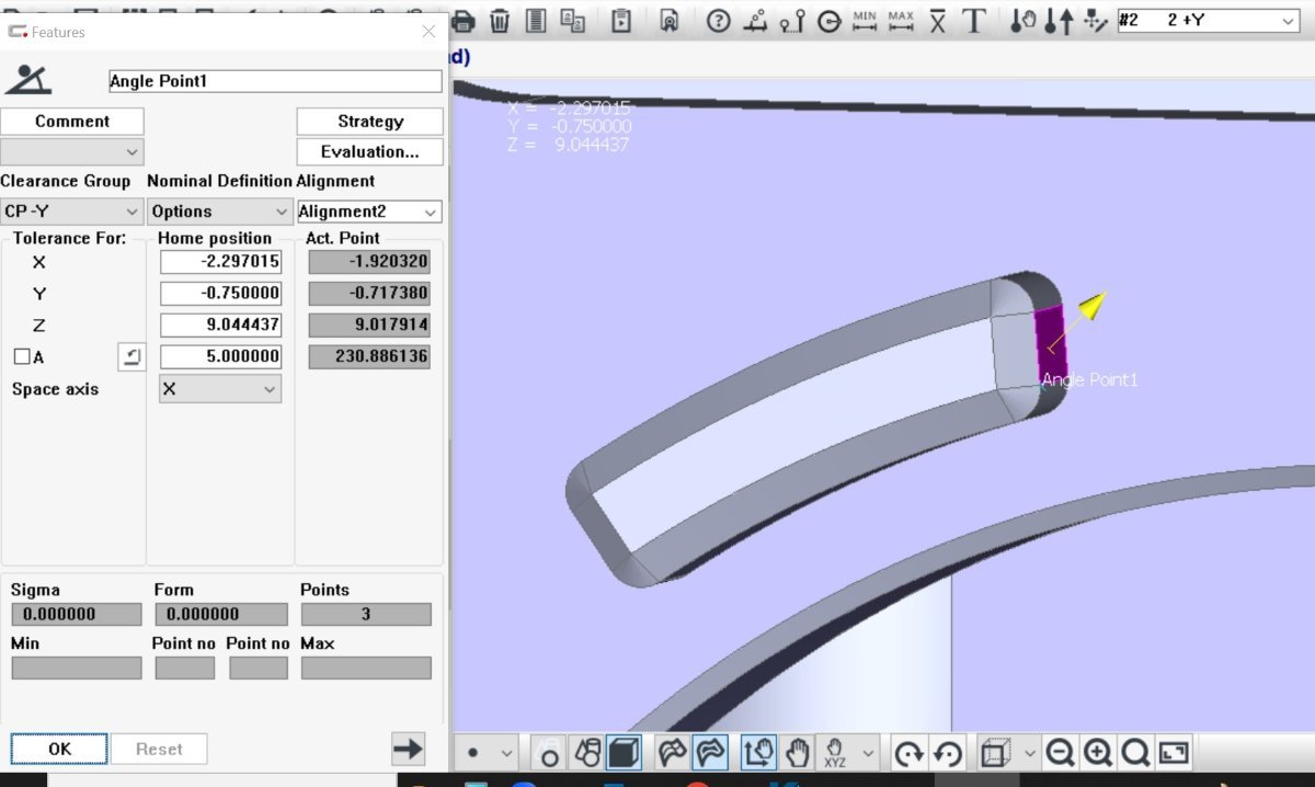

[To...] Posted June 5, 2025 Share Posted June 5, 2025 Can anyone explain how to use an Angle Point? I was successful in creating Radius Points for the radii but the angle point, not so much, Nothing in the KB. Link to comment https://qualityforum.zeiss.com/topic/23609-angle-point-special-geometry/ Share on other sites More sharing options...
[Ma...] Posted June 5, 2025 Share Posted June 5, 2025 It seems like you have to specify origin of measured plane ( where this point lies on ), angle and axis and it should give you angle of plane instead of measuring whole plane. But i've never used that, so you would need to play with it. I had to read translated manual for better understanding. 1 Link to comment https://qualityforum.zeiss.com/topic/23609-angle-point-special-geometry/#findComment-133259 Share on other sites More sharing options...

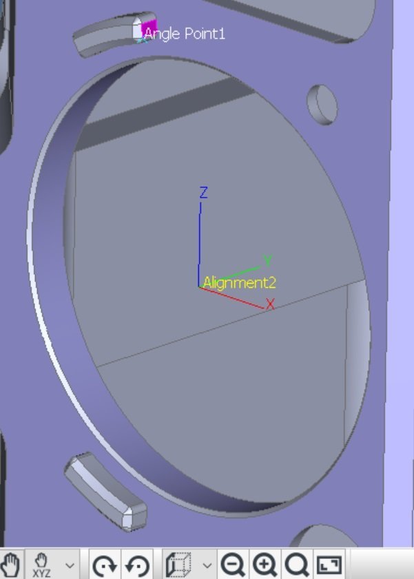

[To...] Posted June 5, 2025 Author Share Posted June 5, 2025 (edited) I used the the X, Y and Z value of the plane, along with the projection angle. When I placed a point on the surface (like I did with Radius Point) and the vector snapped so some weird angle. I think I'm close but missing something. Edited June 5, 2025 Link to comment https://qualityforum.zeiss.com/topic/23609-angle-point-special-geometry/#findComment-133263 Share on other sites More sharing options...
[Da...] Posted June 5, 2025 Share Posted June 5, 2025 I had to look this up as well. As I understand it the point is not on the same plane used for the reference. In your picture I think you would have to put the point on the chamfer plane to get that angle. Where is your angle coming from? Is it the highlighted plane? Link to comment https://qualityforum.zeiss.com/topic/23609-angle-point-special-geometry/#findComment-133265 Share on other sites More sharing options...
[To...] Posted June 5, 2025 Author Share Posted June 5, 2025 (edited) Please sign in to view this quote. On the highlight plane is facing in the +X direction, 5° off the Z axis. The angle origin is the center on the large diameter. I am using an secondary alignment at the radius center point. Edited June 5, 2025 Link to comment https://qualityforum.zeiss.com/topic/23609-angle-point-special-geometry/#findComment-133267 Share on other sites More sharing options...

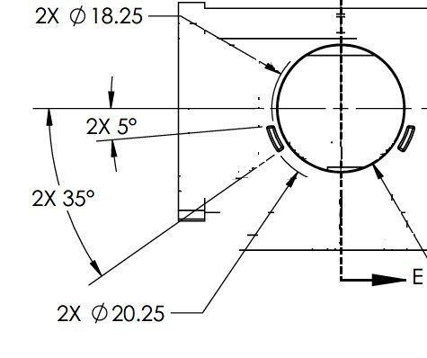

[Da...] Posted June 6, 2025 Share Posted June 6, 2025 Maybe I am thinking too simplistic, but, is the plane in the secondary alignment? If so then shouldn't the A1 or A2 give you that 5° angle? Link to comment https://qualityforum.zeiss.com/topic/23609-angle-point-special-geometry/#findComment-133299 Share on other sites More sharing options...

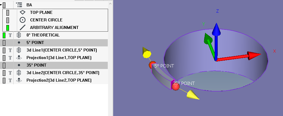

[Pe...] Posted June 6, 2025 Share Posted June 6, 2025 (edited) This could give you a couple lines to use angles between features on 0° theoretical and the projections. Or you could pull the A2 right off the projections. Edit: On second look, the edge at 5° might not even intersect the center of the circle? If that is the case then the drawing isn't constrained enough and this solution wouldn't work. Edited June 6, 2025 Link to comment https://qualityforum.zeiss.com/topic/23609-angle-point-special-geometry/#findComment-133303 Share on other sites More sharing options...
[Ma...] Posted June 6, 2025 Share Posted June 6, 2025 (edited) Please sign in to view this quote. That feature is too small to obtain plane from that. Using 3d lines would do that trick. But perhaps that point gives you angle in one step - don't know yet :-) Edited June 6, 2025 Link to comment https://qualityforum.zeiss.com/topic/23609-angle-point-special-geometry/#findComment-133305 Share on other sites More sharing options...
[Ma...] Posted June 6, 2025 Share Posted June 6, 2025 Please sign in to view this username. I think i got it figured out. If you want to get angle from center, then set origin in angle point as XYZ=0 - angle W leave at 0. Now select axis as Z. Now touch that point on the part. This should give you your angle. Again it's working like trigonometry. Specifying axis as Z it should calculate only with X and Y as delta from origin and touch point ( using ATAN(X/Y) ) Link to comment https://qualityforum.zeiss.com/topic/23609-angle-point-special-geometry/#findComment-133309 Share on other sites More sharing options...
[Ri...] Posted June 6, 2025 Share Posted June 6, 2025 Please sign in to view this quote. I would measure as two points, and construct a 3d line to the center of your choice, and perform the angle between features check between the two 3d lines. For an extra step, you can project the points and center of your choice to a plane of your choice, so that you can force them to all be on the same working plane before creating the 3d lines. A fun fact, you can also perform an angle between features with just points, as it will create the the third point of the triangle for you based on the alignment that the features were measured in, so you can technically just skip all of those steps I just said, and measure the points in an alignment of your choice, and bam. Link to comment https://qualityforum.zeiss.com/topic/23609-angle-point-special-geometry/#findComment-133317 Share on other sites More sharing options...
[To...] Posted June 6, 2025 Author Share Posted June 6, 2025 (edited) Sorry to waste everyone's time. Looking closer, the angle dimensions are the angles of end planes, not an angular location to the center of the circle. There is a general note that all undimensioned features to fall under 0.25 Profile to ABC. Would still like to hear about how an Angle Point is "supposed" to work. Edited June 6, 2025 Link to comment https://qualityforum.zeiss.com/topic/23609-angle-point-special-geometry/#findComment-133331 Share on other sites More sharing options...
