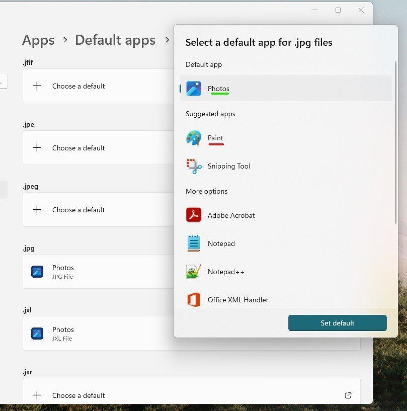

[Lu...] Posted June 10, 2025 Share Posted June 10, 2025 When I upload a .jpg photo using Plan -> measurement run info for CNC start -> select and then I click Run -> User Information the photo does not appear. Any ideas? Link to comment Share on other sites More sharing options...
[Ma...] Posted June 10, 2025 Share Posted June 10, 2025 You could execute your image browser with your file - at least we had a few programs with video Link to comment Share on other sites More sharing options...
[Ch...] Posted June 10, 2025 Share Posted June 10, 2025 Double check that the photo viewer you have set for .jpg files isn't Paint. Paint has been known to cause issues displaying within CALYPSO. Try using one of your PCs other photo view apps like Photos under Apps > Default apps. Link to comment Share on other sites More sharing options...
