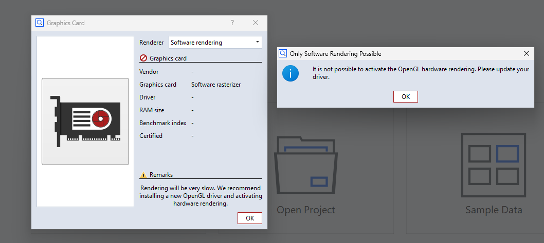

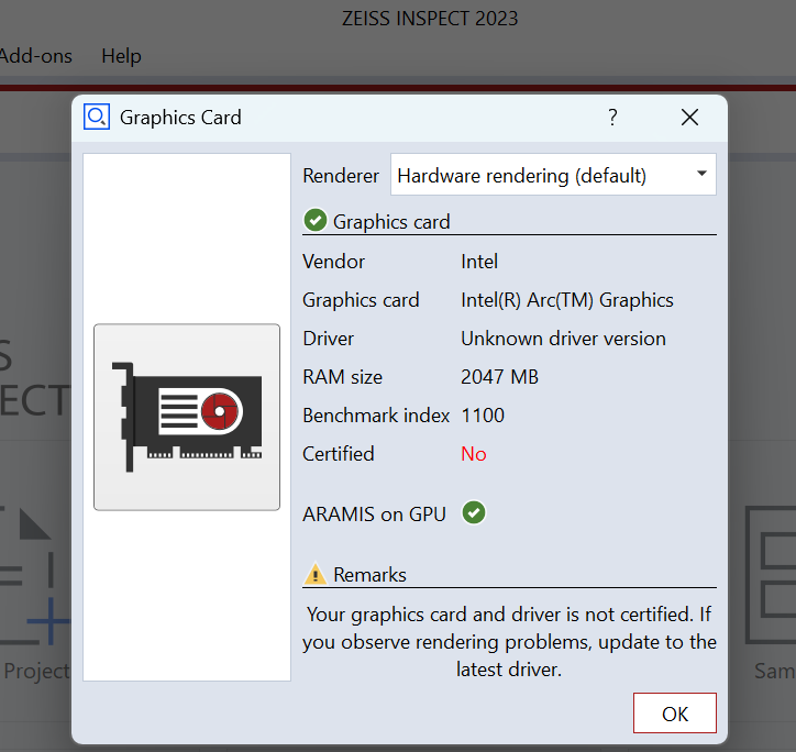

[Da...] Posted June 11, 2025 Share Posted June 11, 2025 Hello everyone, My laptop have two graphics cards, which are Integrated graphics card[Intel(R) Arc(TM) Graphics 2G] and discrete graphics card[NVIDIA RTX2000 Ada 8G], but the ZEISS INSPECT 2023 detected the Low-performance Integrated graphics card by 'Hardware rendering'. And I also have installed the ARAMIS Professional 2019, it can detect the RTX2000 Ada. Do you have any solutions of this problem? Two differents graphics cards of my pc Link to comment https://qualityforum.zeiss.com/topic/23655-zeiss-inspect-2023-cannot-detect-the-high-performance-graphics-card-of-laptop/ Share on other sites More sharing options...
[Na...] Posted June 16, 2025 Share Posted June 16, 2025 Hello Darren, could you try to deactivate the Intel Arc graphics card, maybe in the BIOS? Nanno Link to comment https://qualityforum.zeiss.com/topic/23655-zeiss-inspect-2023-cannot-detect-the-high-performance-graphics-card-of-laptop/#findComment-133811 Share on other sites More sharing options...
[Da...] Posted June 23, 2025 Author Share Posted June 23, 2025 Hello Nanno, thanks for your reply. I have deactivated it before, and 'Only Software Rendering Possible', you can find it attached snapshot. and the ARAMIS Professional 2019 also cannot detect the RTX2000 Ada after I deactivate the Inter Arc graphics card. Darren Link to comment https://qualityforum.zeiss.com/topic/23655-zeiss-inspect-2023-cannot-detect-the-high-performance-graphics-card-of-laptop/#findComment-134175 Share on other sites More sharing options...
