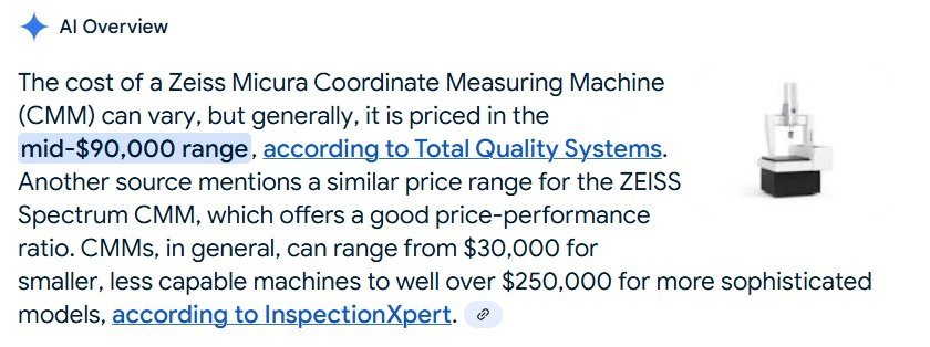

[Ow...] Posted June 11, 2025 Share Posted June 11, 2025 How clo$e ? Link to comment https://qualityforum.zeiss.com/topic/23663-how-accurate-is-ai/ Share on other sites More sharing options...
[Ro...] Posted June 11, 2025 Share Posted June 11, 2025 Haha that's way-off. If you're talking about new, you need to add another 90k to that for a Micura. That's starting price. We are a distributor of Zeiss CMMs. Around 90-100k is what you would expect to see for a Spectrum, depending on its size. Link to comment https://qualityforum.zeiss.com/topic/23663-how-accurate-is-ai/#findComment-133623 Share on other sites More sharing options...

[Je...] Posted June 12, 2025 Share Posted June 12, 2025 Well, our two Micuras (one 2021, one 2023) were both around 200k € (230k $), including the machine, the XTR-head, probe-rack, reference-ball and -probe, and 6 custom-probes, also the computer and software with options. The machine itself, without anything, is listed around 90k, that is right. Link to comment https://qualityforum.zeiss.com/topic/23663-how-accurate-is-ai/#findComment-133639 Share on other sites More sharing options...
[na...] Posted June 12, 2025 Share Posted June 12, 2025 Please sign in to view this quote. I don't know exact numbers, but around 500k, but it doesn't make much sense, if you don't add another 500k for the measuring room. Link to comment https://qualityforum.zeiss.com/topic/23663-how-accurate-is-ai/#findComment-133641 Share on other sites More sharing options...
[Dr...] Posted June 12, 2025 Share Posted June 12, 2025 I find the AI Overview does a decent job amalgamating information from lots of well-documented sources, e.g., determining the out-the-door price of a popular car model. It doesn’t do as well when it’s paraphrasing the content of a single site. Less so when that site was last updated in 2019… Less so when the AI inexplicably swaps the Contura price for the Micura price… (???) Link to comment https://qualityforum.zeiss.com/topic/23663-how-accurate-is-ai/#findComment-133655 Share on other sites More sharing options...
[Ow...] Posted June 12, 2025 Author Share Posted June 12, 2025 I knew the price wasn't right.😏 It's just one of many times an AI search was not right on many different topics. There is always a disclaimer at the bottom of every search saying that "AI responses may include mistakes". Mistakes are costly and it worries me how many children and many adults who have not developed critical thinking skills rely on them. All aside, the post wasn’t all in satire as we have a project that the Micura might come close enough in accuracy to satisfy, but it’s in the beginning stages and I won’t request a quote until we know the profit margins there. Link to comment https://qualityforum.zeiss.com/topic/23663-how-accurate-is-ai/#findComment-133657 Share on other sites More sharing options...
