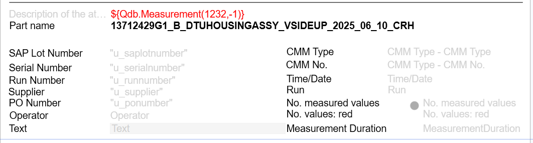

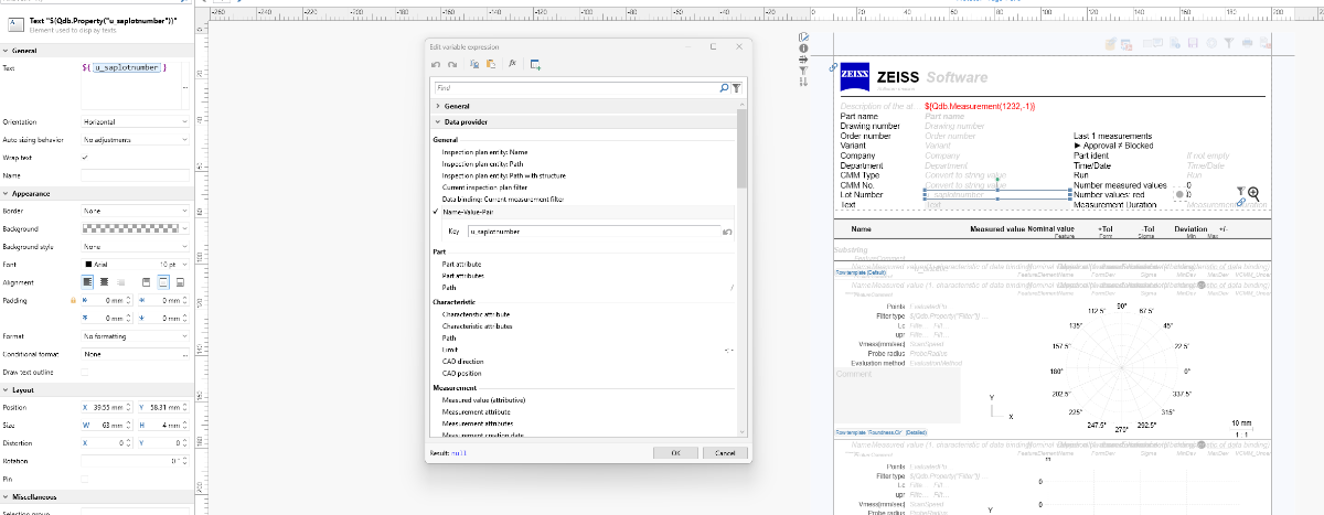

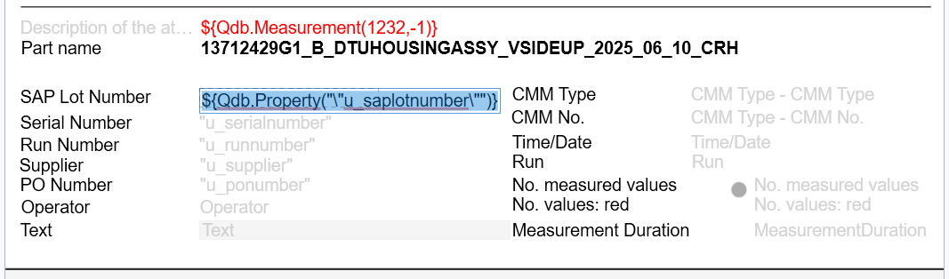

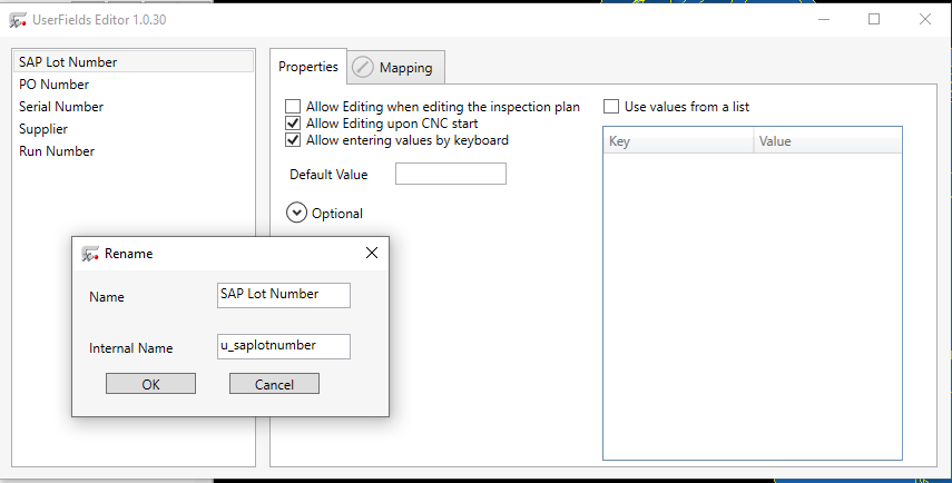

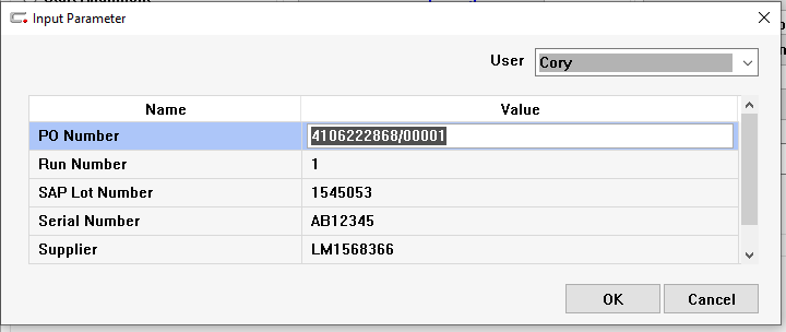

[Co...] Posted June 12, 2025 Share Posted June 12, 2025 Hi all! Wondered if anyone could assist with editing and getting the Input Parameters to show correctly in my PiWeb report. I am running Calypso 2020 and was able to get my Input Parameters updated to what I want (although I don't know how to change the order if it is possible). Now that I run a part and expect it to show up in the report, it isn't showing up. I added it to the UserFields Editor and set it as example SAP Lot Number with a name of u_saplotnumber. Then when I go to the report and edit it, I add the title SAP Lot Number and do a right click, Variable, Data Provider, General, Name-Value Pair and I type "u_saplotnumber" but it still doesn't work when I spit out a report. Any advice? I'll attach some snips that I took of what I have done and what I am doing. Thanks all! Link to comment https://qualityforum.zeiss.com/topic/23671-input-parameters-piweb-report/ Share on other sites More sharing options...
[Ri...] Posted June 12, 2025 Share Posted June 12, 2025 I'm not a fan of doing it this way. Go to the Mapping settings in the UserFields Editor, and drag each of your variables into a blank field. Pay attention to the K field that it assigns it to. Now in your text field just set it to the respective K field. ${Qdb.Measurement(20001, -1)} 1 Link to comment https://qualityforum.zeiss.com/topic/23671-input-parameters-piweb-report/#findComment-133671 Share on other sites More sharing options...

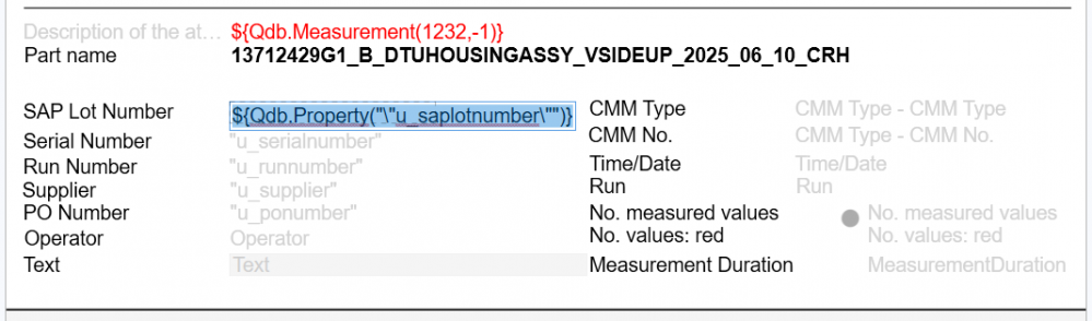

[Ky...] Posted June 12, 2025 Share Posted June 12, 2025 If I am reading this correct, and mind you I might not be, I think you have an extra set of quotation marks in the qdb.property call. It should be something like ${Qdb.Property("u_saplotnumber")}. The additional quotation marks, especially since they are escaped out, is making it look for something else. That being said, what Richard said about mapping does make things easier, assuming there isn't any sort of conflict elsewhere. 1 Link to comment https://qualityforum.zeiss.com/topic/23671-input-parameters-piweb-report/#findComment-133687 Share on other sites More sharing options...
[Da...] Posted June 12, 2025 Share Posted June 12, 2025 Use u_saplotnumber instead of "u_saplotnumber", then it will work. 1 Link to comment https://qualityforum.zeiss.com/topic/23671-input-parameters-piweb-report/#findComment-133735 Share on other sites More sharing options...
[Co...] Posted January 12 Author Share Posted January 12 Hi all, A question on my custom report topics above. Instead of calling my items u_saplotnumber, can I refer to them as something different and then assign it to a K value as long as I use whatever I name it as or does that u_ mean something specific to Calypso? I was wondering if I could name it something like "01_PartNumber" and put that in the K20001 slot. I am running into issues and wondering if that missing u_ could be why. Link to comment https://qualityforum.zeiss.com/topic/23671-input-parameters-piweb-report/#findComment-144445 Share on other sites More sharing options...
[Co...] Posted January 12 Author Share Posted January 12 Nevermind all! I figured out my own issue! You do need the u_ and I was able to make a report for everything needed! 🙂 1 Link to comment https://qualityforum.zeiss.com/topic/23671-input-parameters-piweb-report/#findComment-144453 Share on other sites More sharing options...
