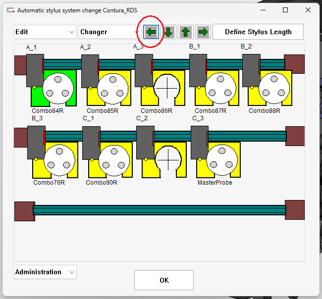

[Co...] Posted June 12, 2025 Share Posted June 12, 2025 Hi all! Back again with another question. Currently have a G2 with a MSR Mini that has 10 spots filled on it (4 on left, 6 on right). I want to remove the single holder in position #1 and replace it with a 3 styli holder which will then be my first 3 probes out of 12. Is there an easy way to do this without having to delete everything and re-create and re-locate the other 3 holders? I haven't tried it yet because I don't want to mess anything up that I can't easily come back from but I am imagining once I remove the single and replace it with a new, it is going to add it at the end (to the right) and I don't know if Calypso lets you rearrange these? Thanks! Link to comment https://qualityforum.zeiss.com/topic/23679-probe-rack-addition-editing/ Share on other sites More sharing options...

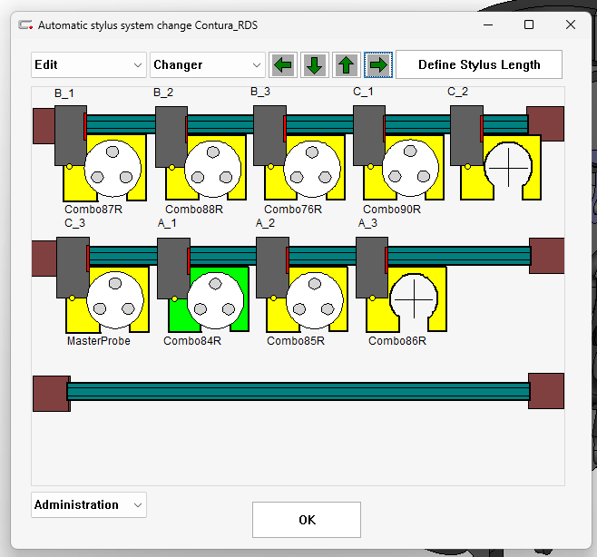

[Ri...] Posted June 12, 2025 Share Posted June 12, 2025 In the image: Deleted holders Ax.png I deleted the probe holder A1-A3 (one holder), then added a new holder and named it "A'. This placed the new holder after B and C. Then using the GREEN ARROWS you select the holder you want to move, click on the arrow indicated and the holder moves. See image: Moved Ax.png 1 Link to comment https://qualityforum.zeiss.com/topic/23679-probe-rack-addition-editing/#findComment-133717 Share on other sites More sharing options...
[Co...] Posted June 12, 2025 Author Share Posted June 12, 2025 Please sign in to view this quote. Thanks for this Richard! It looks so easy when you share this now but I have overlooked those green arrows a million times! Appreciate the screenshots and explanation! I think this will make it a breeze to swap out my single holder for a three holder and move it all the way to the left! Appreciate it! Link to comment https://qualityforum.zeiss.com/topic/23679-probe-rack-addition-editing/#findComment-133727 Share on other sites More sharing options...
[No...] Posted June 13, 2025 Share Posted June 13, 2025 Be careful however if you're using rack assignments. Whenever you delete a holder from the current rack configuration, it is removed from ALL saved rack assignments too, together with any probes that may be assigned to it. 3 Link to comment https://qualityforum.zeiss.com/topic/23679-probe-rack-addition-editing/#findComment-133749 Share on other sites More sharing options...
