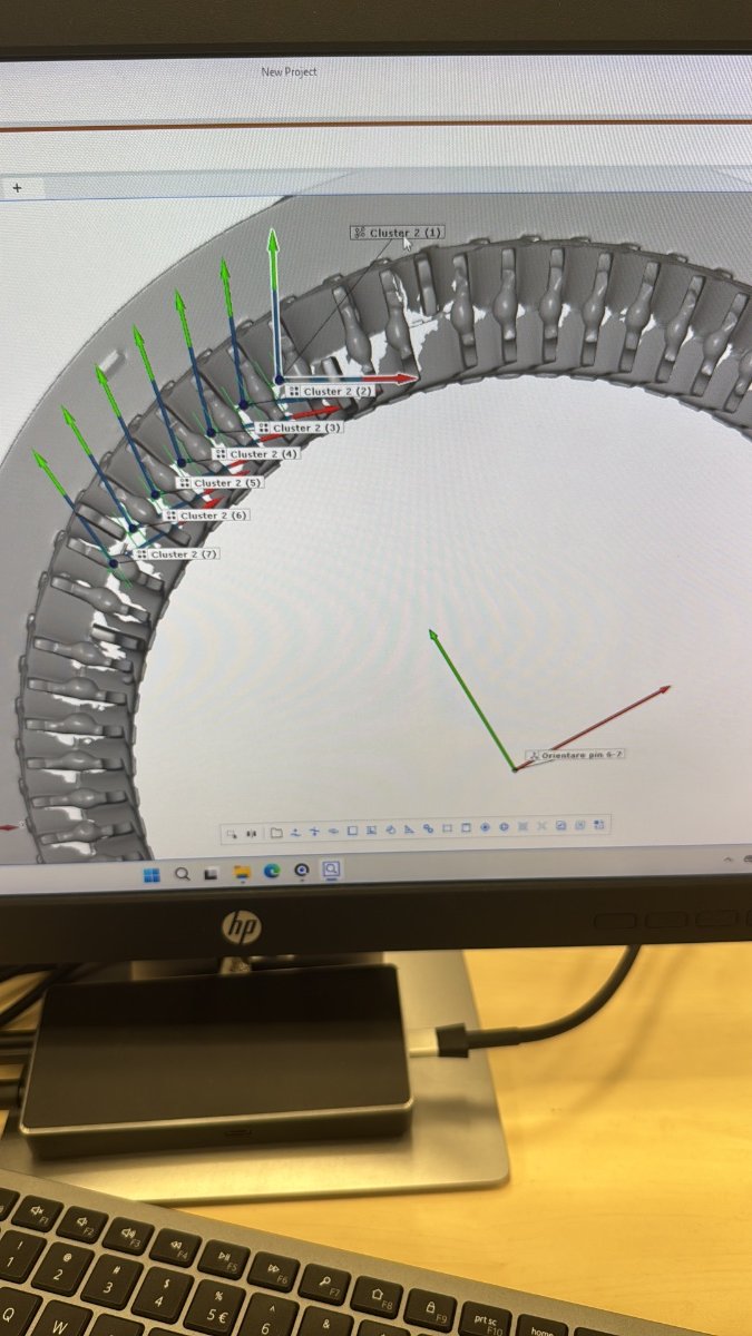

[Ta...] Posted June 13, 2025 Share Posted June 13, 2025 How can I change the orientation of the cluster based on the Coordinate system (Nominal only)? It always keeps the orientation of the Alignment. I need to use multiple Coordinate Systems and orient the cluster based on them. I am able to create and copy the Cluster but it does not help me without adapting the orientation to the Coordinate System as I need to evaluate Inner Caliper Distance. Link to comment https://qualityforum.zeiss.com/topic/23689-cluster-orientation-based-on-coordinate-system/ Share on other sites More sharing options...
[Se...] Posted June 16, 2025 Share Posted June 16, 2025 Hi, The orientation of the cluster coordinate system is computed automatically. The best option in this case is to define the caliper direction in the original inspection (for example the line to the center of rotation). This line will then included in the cluster and trasnformed accordingly. If this does not help you might contact our support to have a closer look in this particular project Cheers, Sergio Link to comment https://qualityforum.zeiss.com/topic/23689-cluster-orientation-based-on-coordinate-system/#findComment-133801 Share on other sites More sharing options...
