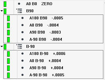

[Pe...] Posted June 13, 2025 Share Posted June 13, 2025 Hello I am seeing some odd results within our rotations and was wondering if anyone could offer some insight: This is on a contura with rds xxt. My stylus is a 1mm probe X 30 long, on a 60mm long extension, qualified as RC-CAA. I establish a Z zero at A0 B0. Then I check the same Z at different rotations and get some different values: The + or - are the Z results. This is with a fresh new stylus, with a full qualification. I tried it with a different stylus, a longer one, and got even worse results (±.0007). I tried the same test on a different cmm and got ±.0001. I don't know what to do with this or if there is anything I even can do. Link to comment https://qualityforum.zeiss.com/topic/23693-different-results-with-different-probe-rotations/ Share on other sites More sharing options...

[Ri...] Posted June 16, 2025 Share Posted June 16, 2025 Since this is with RC-CAA qualification, this is expected. The longer the stylus system the worse error will be for the qualification. It has always been stated that if you need accuracy, do not use RC-CAA, instead create the individual rotations each having their own true qualification. 1 Link to comment https://qualityforum.zeiss.com/topic/23693-different-results-with-different-probe-rotations/#findComment-133817 Share on other sites More sharing options...

[Pe...] Posted June 17, 2025 Author Share Posted June 17, 2025 Please sign in to view this quote. This is good to know. I have but two questions: 1) How would it be worse for a longer probe since the longer probe gets requalified on its own? Each probe should have its own calculations? 2) What level of accuracy can I expect from RC-CAA Calibration? This is kind of a bad question since you said the longer the probe, the worse the error, but how bad does it have to get for me to say that something is verifiably wrong with the machine? I've come in the morning more than once to the rdsprobe adapter+sensor+broken styli lying on the table so there is definitely the possibility of damage. For now, I will have to try the non-rc-caa qualification for this probe to see if there is better results. Link to comment https://qualityforum.zeiss.com/topic/23693-different-results-with-different-probe-rotations/#findComment-133895 Share on other sites More sharing options...

[Pe...] Posted June 27, 2025 Author Share Posted June 27, 2025 Well... It seems my original issue got resolved. I had new problem with my RDS. It started having an issue "ConturaG2_RDS: 395 Data transfer error" in the status window. The head began to be caught in a loop of unseating and reseating itself until it red lit, but only at a specific angle, A-30° and only when rotating from one direction, less than A-30. Zeiss remoted in and ran some sort of RDS calibration. And now when I perform the same test to see if there is a mismatch between angles: .0000 1 Link to comment https://qualityforum.zeiss.com/topic/23693-different-results-with-different-probe-rotations/#findComment-134467 Share on other sites More sharing options...
