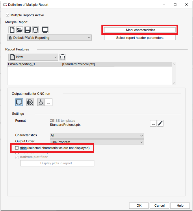

[Lu...] Posted June 14, 2025 Share Posted June 14, 2025 Hello, I can't figure out how to hide a characteristic on a report. I want the characteristic to be measured, but I don't want it to appear on the report. I tried turning on "marking" (characteristics settings editor) for these characteristics, and they still displayed on the report. Thanks Link to comment https://qualityforum.zeiss.com/topic/23697-hide-characteristic-on-report/ Share on other sites More sharing options...
[Ma...] Posted June 14, 2025 Share Posted June 14, 2025 For old report you use right click and mask. On PiWeb you have to go to settings, check "Hide marked" and then next button on right top where you set characteristic - not sure if enabled or disable ( or what's there ) 1 Link to comment https://qualityforum.zeiss.com/topic/23697-hide-characteristic-on-report/#findComment-133795 Share on other sites More sharing options...
[Ch...] Posted June 16, 2025 Share Posted June 16, 2025 Just as Martin stated so nicely, here is the KBA guide: CALYPSO - Hiding Characteristics From Report 1 Link to comment https://qualityforum.zeiss.com/topic/23697-hide-characteristic-on-report/#findComment-133859 Share on other sites More sharing options...
