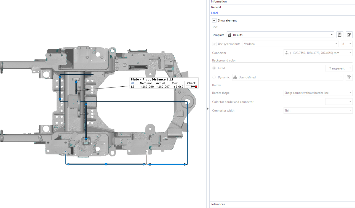

[Ca...] Posted June 16, 2025 Share Posted June 16, 2025 Hi, I'm having issues with dimensional labels not showing and I'm unsure how to resolve this. Does anyone have suggestions? Only one label is showing and the rest of the dimensions are not. Link to comment https://qualityforum.zeiss.com/topic/23701-dimension-labels-not-showing/ Share on other sites More sharing options...

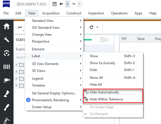

[Ch...] Posted June 17, 2025 Share Posted June 17, 2025 Just a guess, maybe you have enabled one of the automatic hide options Due to the fact that the only tolerance that is visible is outside of the tolerance it may be a good idea to check the "hide within tolerance" option Link to comment https://qualityforum.zeiss.com/topic/23701-dimension-labels-not-showing/#findComment-133867 Share on other sites More sharing options...
[Ka...] Posted June 17, 2025 Share Posted June 17, 2025 Hi, please check if the respective nominal element is visible, too The "Results" label template is a combined label, which means that for this also the base element must be visible with the "Results" label, that's why you do not see the option "Show label" in the Properties tab for the dimension itself Link to comment https://qualityforum.zeiss.com/topic/23701-dimension-labels-not-showing/#findComment-133871 Share on other sites More sharing options...
