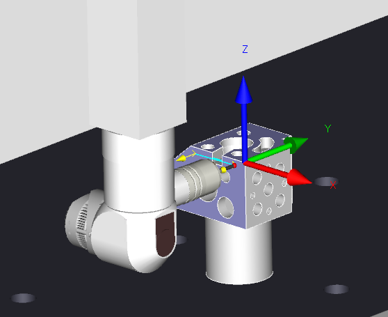

[Mi...] Posted June 16, 2025 Share Posted June 16, 2025 Hello, Zeiss forum members! I'm facing an issue while setting up the simulation in Calypso Planner 7.6. I've configured everything correctly, including the dimensions of the RDS XXT head, but when testing the stylus positioning, it does not move to the correct coordinates. Here’s what I’ve already tried without success: ✔️ Probe calibration ✔️ Configuration of RDS XXT head dimensions ✔️ Review of the stylus system definition ✔️ Verified software updates ✔️ Checked simulation settings Despite all of this, Calypso does not apply the necessary correction to position the stylus correctly. Has anyone encountered this issue and found a solution? Is there a specific adjustment I should try? I’d appreciate any help! Rauch, Miguel Link to comment https://qualityforum.zeiss.com/topic/23705-issue-with-calypso-planner-76-simulation-%E2%80%93-incorrect-coordinates/ Share on other sites More sharing options...

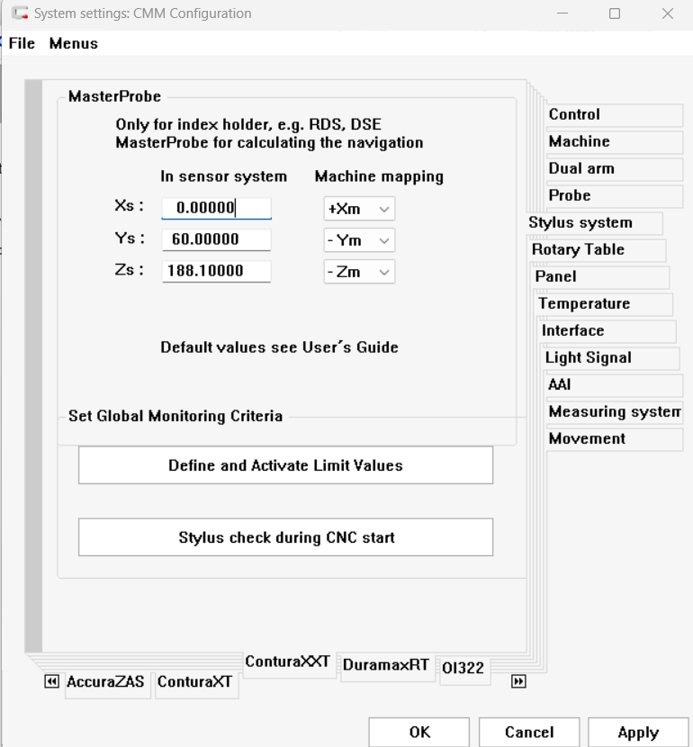

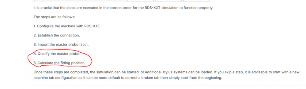

[Ch...] Posted June 16, 2025 Share Posted June 16, 2025 Hi Miguel, When you say you have configured the RDS XXT head dimensions are you using the following under Extras > Settings > CMM > Stylus System > Xs: 0 +Xm, Ys: 60 -Ym, and Zs: 188.1 -Zm as detailed in CALYPSO Planner Simulation Set Up. It is crucial that the steps are executed in the correct order for the RDS-XXT simulation to function properly. The steps are as follows: 1. Configure the machine with RDS-XXT. 2. Establish the connection. 3. Import the master probe (ssc). 4. Qualify the master probe. 5. Calculate the fitting position. Once these steps are completed, the simulation can be started, or additional stylus systems can be loaded. If you skip a step, it is advisable to start with a new machine tab configuration as it can be more default to correct a broken tab then simply start from the beginning. 1 Link to comment https://qualityforum.zeiss.com/topic/23705-issue-with-calypso-planner-76-simulation-%E2%80%93-incorrect-coordinates/#findComment-133857 Share on other sites More sharing options...
[Mi...] Posted June 17, 2025 Author Share Posted June 17, 2025 Hi Charlie, Thank you for your detailed instructions. I followed them carefully, and they worked perfectly! The setup went smoothly, and everything is functioning as expected. I really appreciate your guidance and support. Let me know if there's anything else I should keep in mind. Best regards, Miguel 1 Link to comment https://qualityforum.zeiss.com/topic/23705-issue-with-calypso-planner-76-simulation-%E2%80%93-incorrect-coordinates/#findComment-133949 Share on other sites More sharing options...

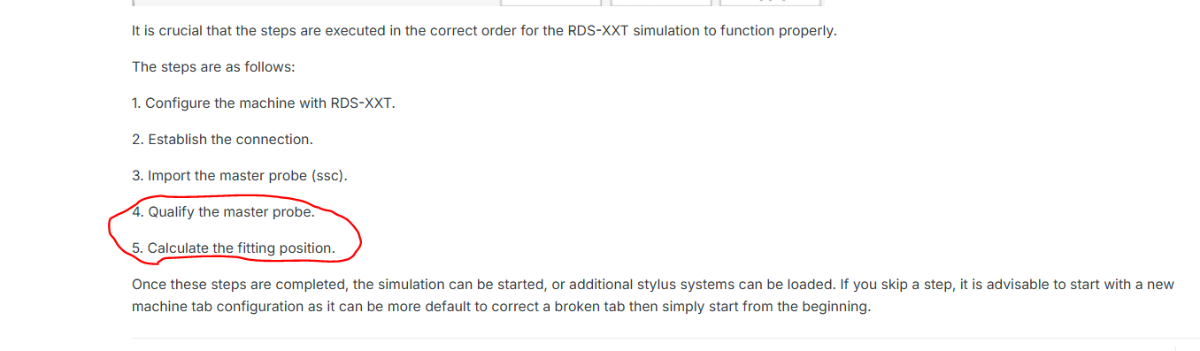

[Ji...] Posted June 18, 2025 Share Posted June 18, 2025 Please sign in to view this quote. Dear, i follow your step. It's not clear that step4 and step5 for me. Can you help explain? 4. Qualify the master probe. 5. Calculate the fitting position. Link to comment https://qualityforum.zeiss.com/topic/23705-issue-with-calypso-planner-76-simulation-%E2%80%93-incorrect-coordinates/#findComment-133953 Share on other sites More sharing options...

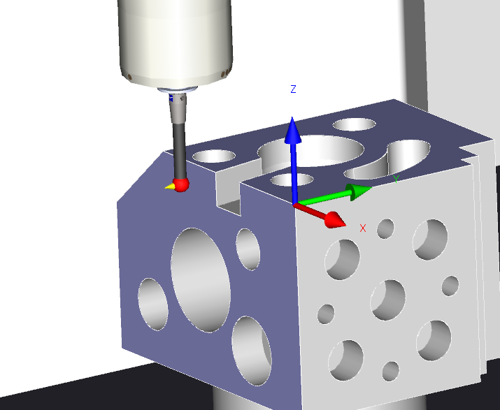

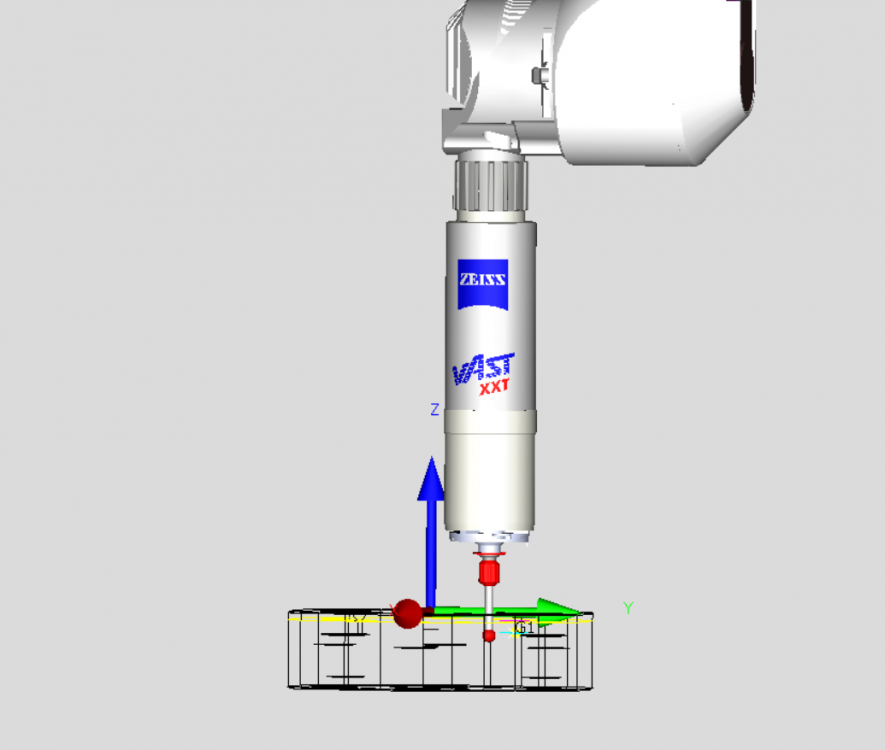

[To...] Posted June 18, 2025 Share Posted June 18, 2025 (edited) While in simulation, try going to Plan > Travel to Nominal Position. Enter X0 Y0 and Z2.5 (assuming metric) This should move the center of your MasterProbe so the tip is touching the top of your part. If not, something is off. Edited June 18, 2025 Link to comment https://qualityforum.zeiss.com/topic/23705-issue-with-calypso-planner-76-simulation-%E2%80%93-incorrect-coordinates/#findComment-134021 Share on other sites More sharing options...

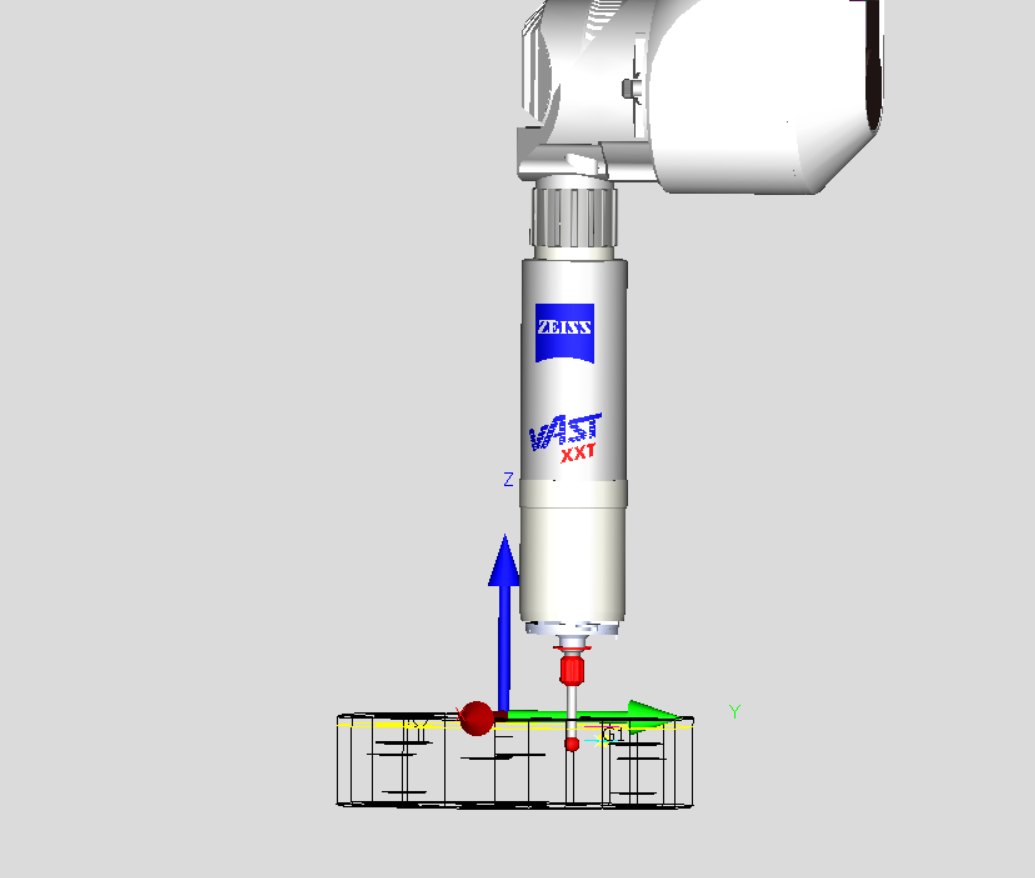

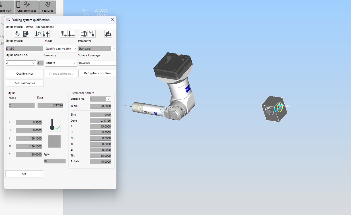

[Ch...] Posted June 18, 2025 Share Posted June 18, 2025 Make sure you have entered a radius for your MasterProbe. Then go to the qualification window and run a "ref sphere position" to qualify it along with a "fitting position". Video example: MasterProbe Qual and Fitting Position.mp4 1 Link to comment https://qualityforum.zeiss.com/topic/23705-issue-with-calypso-planner-76-simulation-%E2%80%93-incorrect-coordinates/#findComment-134039 Share on other sites More sharing options...

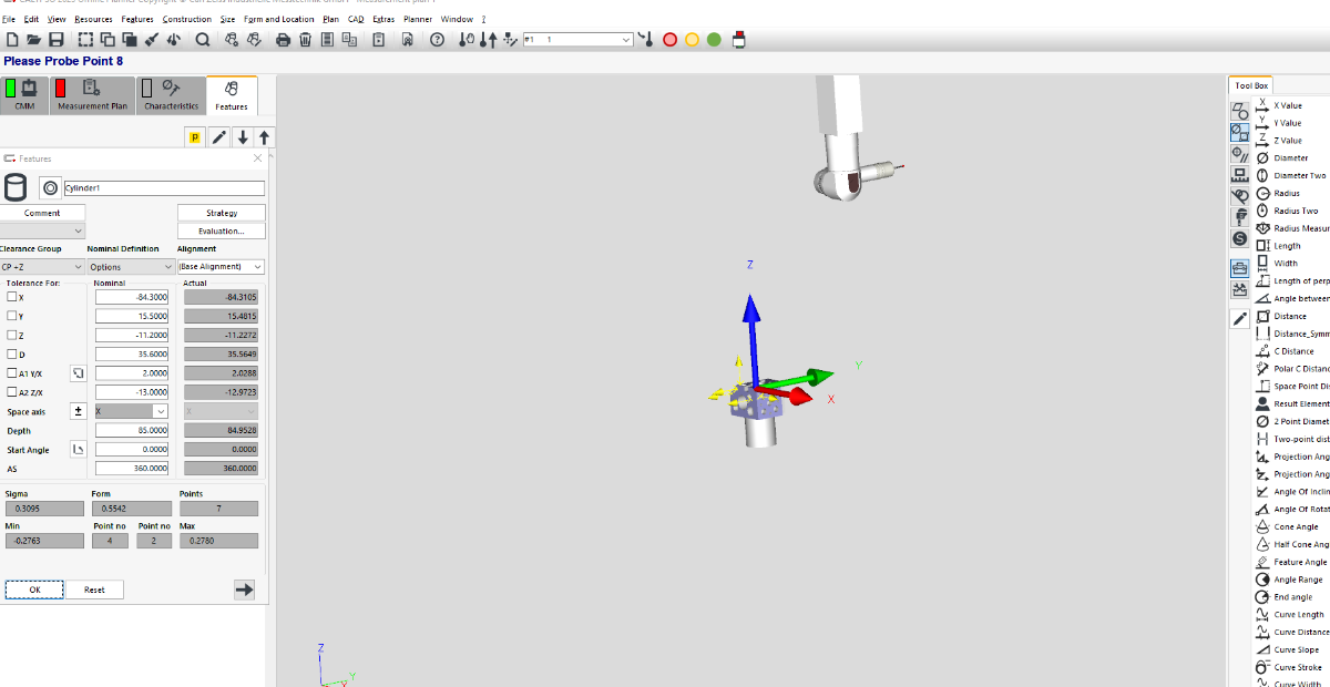

[Ji...] Posted June 19, 2025 Share Posted June 19, 2025 Please sign in to view this quote. It seems something still wrong.... Link to comment https://qualityforum.zeiss.com/topic/23705-issue-with-calypso-planner-76-simulation-%E2%80%93-incorrect-coordinates/#findComment-134067 Share on other sites More sharing options...
[Ji...] Posted June 19, 2025 Share Posted June 19, 2025 Please sign in to view this quote. Can you show the operation from the first step? I think there are still something wrong. and when it's successful, Can you also help import another probe as example? Link to comment https://qualityforum.zeiss.com/topic/23705-issue-with-calypso-planner-76-simulation-%E2%80%93-incorrect-coordinates/#findComment-134069 Share on other sites More sharing options...

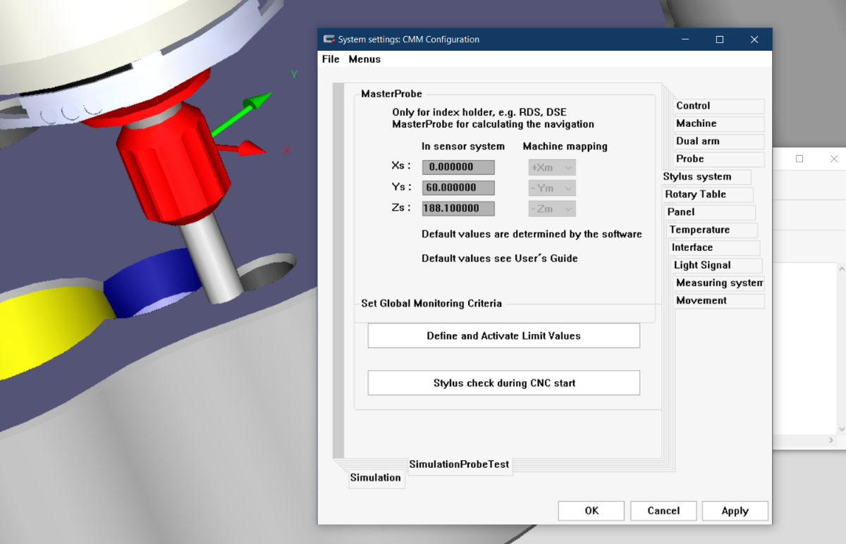

[Ri...] Posted June 19, 2025 Share Posted June 19, 2025 Version 7.4.24 (24.06.2024) The steps are as follows: 1. Configure the machine with RDS-XXT. 2. Establish the connection. - Once the connection is established Calypso automatically creates a MasterProbe. You can't delete this MasterProbe. 3. Import the master probe (ssc). - You are not allowed to import a MasterProbe SSC file, Calypso will not allow you to overwrite the MasterProbe. 4. Qualify the master probe. 5. Calculate the fitting position. If I recall correctly, I had to have a Zeiss tech remote in and fix this offline seat. Which I am at that point again because the MasterProbe SSC model has disappeared (along with several other SSC models). Most of the probes created and imported (SSC) no longer show proper contact. All of the missing probe models are still in the proper location. I have a backup of the setup, using those files fixes nothing. Absolutely no one has made any changes to the installation. Calypso just loses itself most likely from the many unknown software crashes that happen. Link to comment https://qualityforum.zeiss.com/topic/23705-issue-with-calypso-planner-76-simulation-%E2%80%93-incorrect-coordinates/#findComment-134077 Share on other sites More sharing options...
[Ch...] Posted June 19, 2025 Share Posted June 19, 2025 Here is a video from the start. There is a size limit so I can't make it much longer. You must: 1. Configure the machine with RDS-XXT making sure to add the stylus system offsets. 2. Establish the connection. 3. Import the master probe (ssc). - You must import a MasterProbe SSC 4. Qualify the master probe after entering a radius. 5. Calculate the fitting position. 6. Add any additional styli you wish. If you are having issues I would suggest creating a new configuration tab and start from the beginning. For a more detailed walk through you can reference CALYPSO planner + simulation eLearning Competence Package XXT Example Video.mp4 1 Link to comment https://qualityforum.zeiss.com/topic/23705-issue-with-calypso-planner-76-simulation-%E2%80%93-incorrect-coordinates/#findComment-134099 Share on other sites More sharing options...
[Ri...] Posted June 19, 2025 Share Posted June 19, 2025 A reboot of the PC and restart of Calypso and now I can import a MasterProbe SSC file...🤷♂️ WEIRD. Link to comment https://qualityforum.zeiss.com/topic/23705-issue-with-calypso-planner-76-simulation-%E2%80%93-incorrect-coordinates/#findComment-134101 Share on other sites More sharing options...

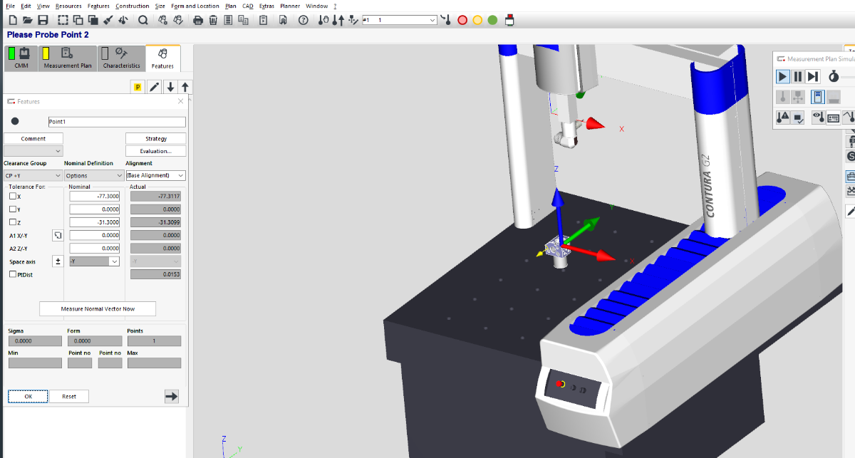

[Co...] Posted July 23, 2025 Share Posted July 23, 2025 I just want to give a big shoutout to this post right here! I had been trying to setup simulation on my Contura G2 with an RDS XXT TL3 Head and after probably 10 times...thinking I had it on the last time and seeing when I finally executed a feature that my probe went through the part and another was about an inch from the part, I was ready to SCREAM! - LOL Then I came to this post...tried again (I'm a professional simulation setter-upper if anyone needs help!) and with the message from Please sign in to view this username. everything went perfect! It was the simple step of adding my Masterprobe radius before hitting Reference Sphere Position that I was missing! Thanks Charlie and all in the forum! Have appreciate all the help getting back into Calypso! 1 Link to comment https://qualityforum.zeiss.com/topic/23705-issue-with-calypso-planner-76-simulation-%E2%80%93-incorrect-coordinates/#findComment-135565 Share on other sites More sharing options...

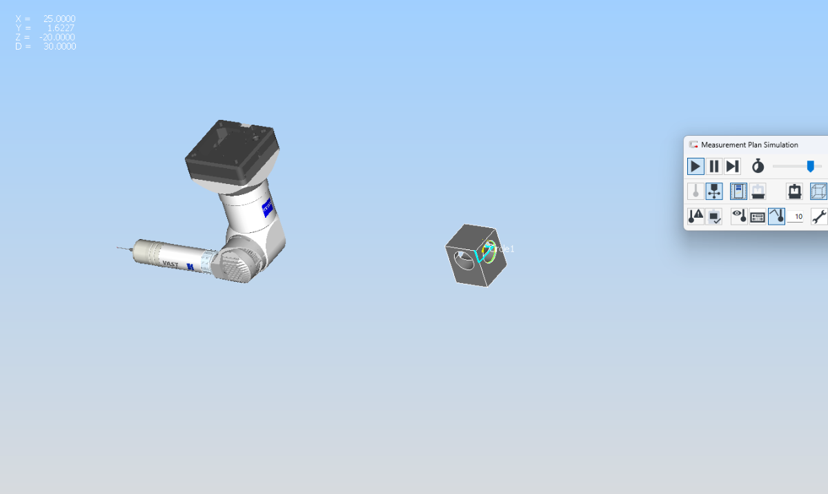

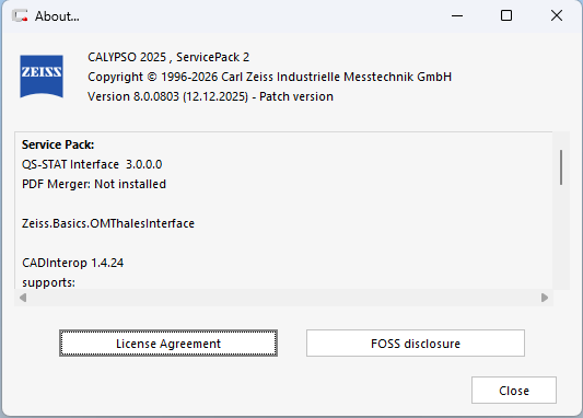

[Lu...] Posted February 17 Share Posted February 17 hi all, I follow the video steps and i add a new RDS position (A90.0_B-90 POS 2 +Y) the sylus position is way off Im Using Last version of calypso. After i do this i even try make geometry requalification but didnt solve teh issue Any help how to solve this issue??? Link to comment https://qualityforum.zeiss.com/topic/23705-issue-with-calypso-planner-76-simulation-%E2%80%93-incorrect-coordinates/#findComment-146293 Share on other sites More sharing options...
[Lu...] Posted February 18 Share Posted February 18 Hi guys i finnaly make it work thanks for the help Link to comment https://qualityforum.zeiss.com/topic/23705-issue-with-calypso-planner-76-simulation-%E2%80%93-incorrect-coordinates/#findComment-146383 Share on other sites More sharing options...
