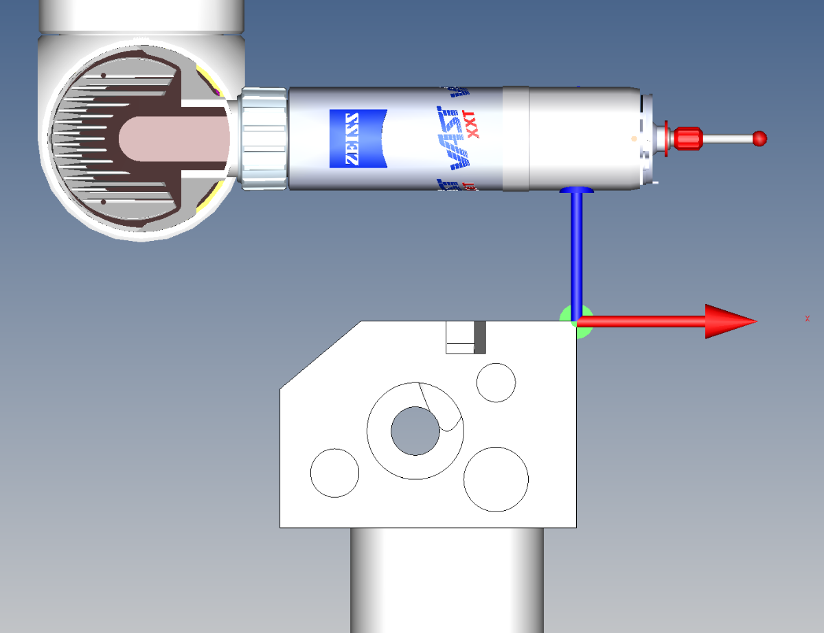

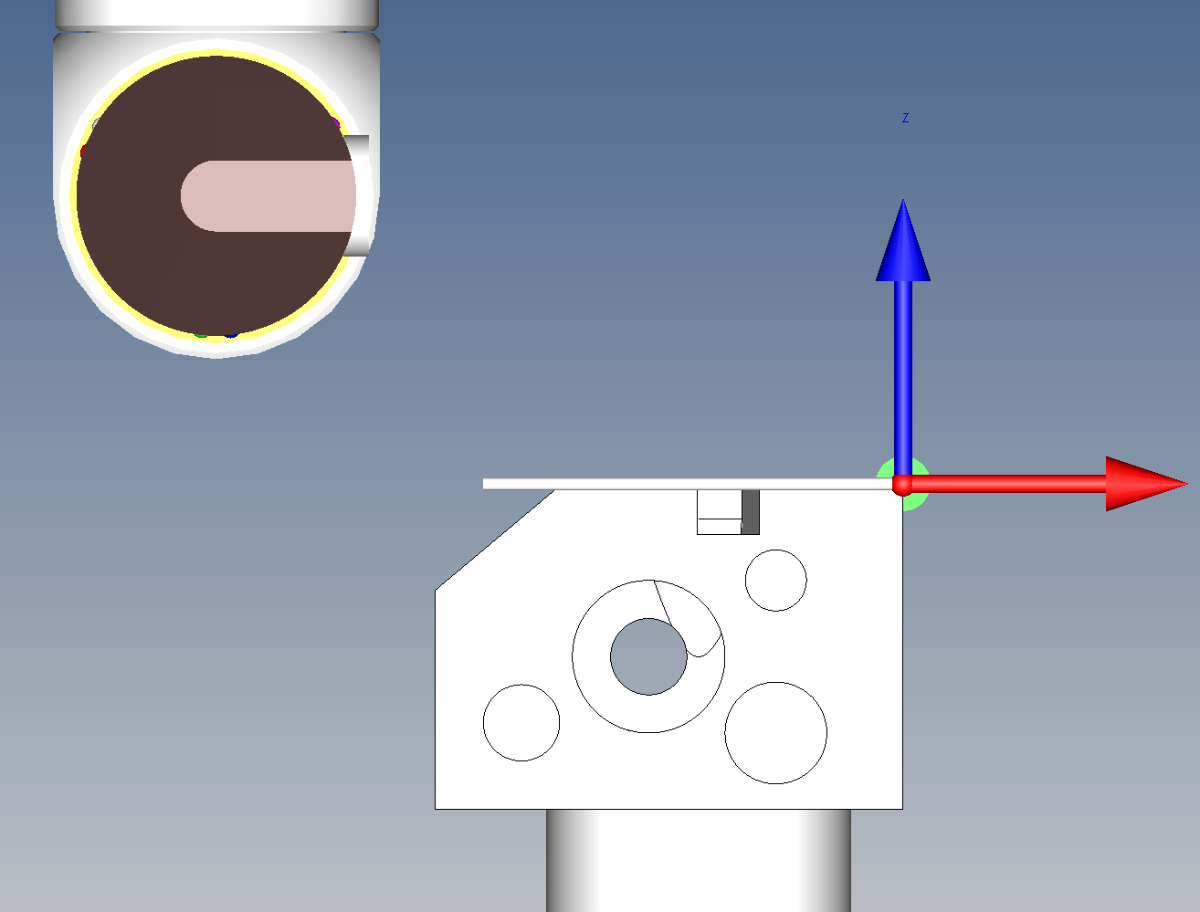

[Ra...] Posted June 16, 2025 Share Posted June 16, 2025 Recently started a new job, which I'm getting re-accustomed to Calypso. It's awesome to see names I remember from years ago. Hope you're all doing well. Setting up an offline seat now. I followed a guide for an RDS XXT, however, the stylus only shows to be in the "correct" position when I have "Show stylus" enabled, and not "Show stylus system" in the simulation menu. The only time the graphic is correct is when RDS angle is set to A0 B0. It's (probably) not a big deal, but it is bothering me. Any ideas? Calypso 2019, latest service pack. Link to comment https://qualityforum.zeiss.com/topic/23715-stylus-location-in-offline-simulation/ Share on other sites More sharing options...
[Ch...] Posted June 17, 2025 Share Posted June 17, 2025 Glad to see you back! I would suggest reviewing CALYPSO Planner Simulation Set Up to ensure your MasterProbe ssc is imported correctly and the proper offsets are entered. It is crucial that the steps are executed in the correct order for the RDS-XXT simulation to function properly. The steps are as follows: 1. Configure the machine with RDS-XXT. 2. Establish the connection. 3. Import the master probe (ssc). 4. Qualify the master probe. 5. Calculate the fitting position. Once these steps are completed, the simulation can be started, or additional stylus systems can be loaded. If you skip a step, it is advisable to start with a new machine tab configuration as it can be more default to correct a broken tab then simply start from the beginning. Link to comment https://qualityforum.zeiss.com/topic/23715-stylus-location-in-offline-simulation/#findComment-133901 Share on other sites More sharing options...
[Ra...] Posted June 17, 2025 Author Share Posted June 17, 2025 Must have done something out of order, everything's great now! Appreciate it, Ian 1 Link to comment https://qualityforum.zeiss.com/topic/23715-stylus-location-in-offline-simulation/#findComment-133935 Share on other sites More sharing options...
