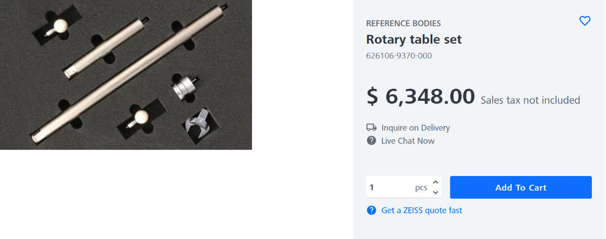

[Ke...] Posted June 17, 2025 Share Posted June 17, 2025 Question for Rotary Table users: For defining the RT Axis, I have only used the Actual Part (3d-line) or the Single Sphere method. I like these methods, because they are simple and the RT Axis is re-defined at the beginning of every program... is this excessive for in a well controlled environment? I'm thinking of picking up the Rotary Table Kit... What are the Pros & Cons of using the Invar Cylinders? I use a RT-AB on an ACCURA II Link to comment https://qualityforum.zeiss.com/topic/23731-rotary-table-definition-of-axis/ Share on other sites More sharing options...
[Ch...] Posted June 18, 2025 Share Posted June 18, 2025 I think you mean the portable or moveable kit correct? You can still measure the axis on the part I believe, I would recommend it. If the Invar Cylinders you are referring to are just extensions with conical pockets, or similar; then I imagine the only mainly the material shaft compared to a ceramic sphere and steel shaft or the (assuming steel or harder) parts you normally measure. I'd say very negligible decrease in accuracy compared to RT A/B. I've seen one use on Duramax without too much issue. What machine will this be for ? I'm sure they've done testing. If you can measure your actual part,I would recommend that. 1 Link to comment https://qualityforum.zeiss.com/topic/23731-rotary-table-definition-of-axis/#findComment-133955 Share on other sites More sharing options...

[Ke...] Posted June 18, 2025 Author Share Posted June 18, 2025 (edited) Sorry, I thought that I had uploaded the image for the RT set; I use the RT-AB on an Accura II... My presumption is that, in theory: if the RT Axis is aligned and saved, then only measurement of the part for Base Alignment would be necessary(?) Edited June 18, 2025 Link to comment https://qualityforum.zeiss.com/topic/23731-rotary-table-definition-of-axis/#findComment-134029 Share on other sites More sharing options...
