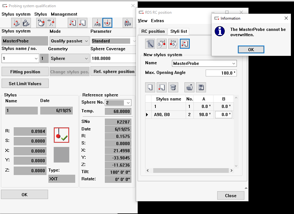

[Co...] Posted June 19, 2025 Share Posted June 19, 2025 Hi all! I just added a 3 probe holder to our Contura and was trying to locate it and my MasterProbe only has an A0°, B0° rotation. When I try to go in and add another rotation for A90°, B0° it doesn't let me and tells me that the MasterProbe cannot be overwritten. Is there a way to add more stylus systems to a MasterProbe so that I can add this rack? Thanks! Link to comment https://qualityforum.zeiss.com/topic/23751-adding-a-stylus-system-to-masterprobe-on-rds-xxt-head/ Share on other sites More sharing options...
[Ri...] Posted June 19, 2025 Share Posted June 19, 2025 You cannot do this via the RC-List function. Just rotate the stylus system to the desired rotation, click new stylus, and then qualify. 1 Link to comment https://qualityforum.zeiss.com/topic/23751-adding-a-stylus-system-to-masterprobe-on-rds-xxt-head/#findComment-134087 Share on other sites More sharing options...
[Co...] Posted June 19, 2025 Author Share Posted June 19, 2025 Thanks Richard. Yeah, that was exactly what I needed to do. Ended up getting it to work but had a little panic thinking I wasn't going to get the new 3x rack working or get the single back on. Appreciate it! 1 Link to comment https://qualityforum.zeiss.com/topic/23751-adding-a-stylus-system-to-masterprobe-on-rds-xxt-head/#findComment-134115 Share on other sites More sharing options...
