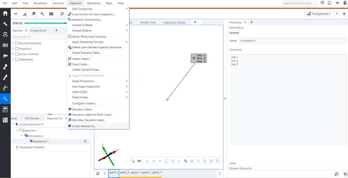

[Br...] Posted June 19, 2025 Share Posted June 19, 2025 (edited) Is there a good way to add notes inside of a program, like a Notepad type of function? Specifically, I would like to be able to add a record of scan setting inside of a program. Appreciate any assist Edited June 19, 2025 Link to comment https://qualityforum.zeiss.com/topic/23757-notes-inside-of-a-program/ Share on other sites More sharing options...
[Ja...] Posted June 20, 2025 Share Posted June 20, 2025 Hi Brian. There is a possibility to add notes to a project template such that you can see them when you are selecting the template to run the program from. Its a bit clunky but i think its a reasonable option. Hope this helps 1 Link to comment https://qualityforum.zeiss.com/topic/23757-notes-inside-of-a-program/#findComment-134123 Share on other sites More sharing options...
[Ch...] Posted June 20, 2025 Share Posted June 20, 2025 Depending on your task maybe the usage of annotation label could be a reasonable solution too. If you have templates and the note you like to take is always the same James solution could be a good idea. If not maybe annotation labels could help you. 1 Link to comment https://qualityforum.zeiss.com/topic/23757-notes-inside-of-a-program/#findComment-134129 Share on other sites More sharing options...
[Br...] Posted June 23, 2025 Author Share Posted June 23, 2025 Great suggestions, appreciate! Link to comment https://qualityforum.zeiss.com/topic/23757-notes-inside-of-a-program/#findComment-134201 Share on other sites More sharing options...
