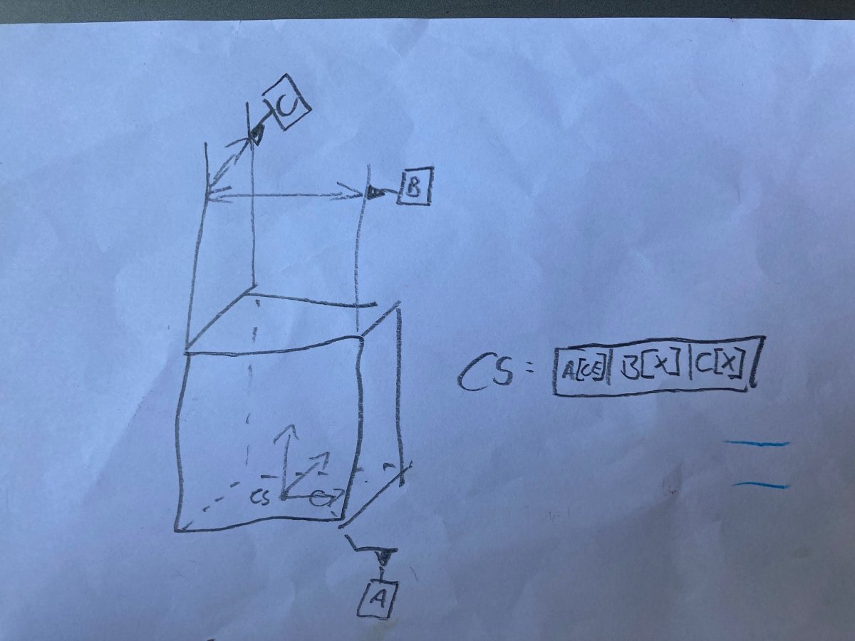

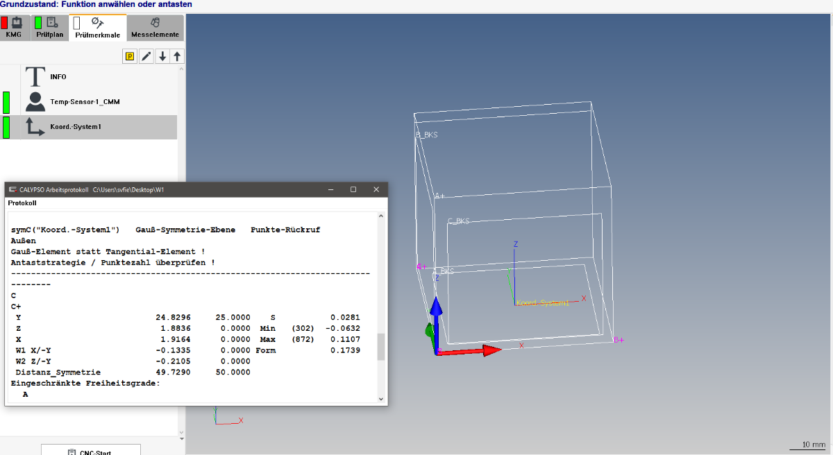

[Sv...] Posted June 23, 2025 Share Posted June 23, 2025 Hello, I have a problem with the special element symmetry plane (2x parallel planes, with minimum inscribed condition -> see feature of size as datum ISO5459). The single evaluation works so far. However, if I want to use it in a coordinate system as a secondary datum (additional constrain of the direction by a primary datum) it automatically switches to gauss element. My basic procedure in Calypso 7.6.2009: -the body is a cube and I want to have the support surface as primary datum -the constrained symmetry plane (see above) of two parallel planes form the secondary datum and the constrained symmetry of the other form the tertiary datum -Datum according to ISO5459 so the CS is in the middle of the primary datum plane -The planes are all measured individually via a grid and the symmetrical one is formed via point recall using the special element symmetry plane Does anyone have an idea why this is the case? Link to comment https://qualityforum.zeiss.com/topic/23769-special-element-symmetry-plane-as-a-secondary-datum/ Share on other sites More sharing options...
[Ha...] Posted June 24, 2025 Share Posted June 24, 2025 If I am understanding correctly, you are using a secondary alignment for a characteristic. If that is the case, you will need to change the evaluation of the feature inside the alignment in order to evaluate it as a maximum inscribed element even if the global settings have the outer tangential element selected for the form datum options. Link to comment https://qualityforum.zeiss.com/topic/23769-special-element-symmetry-plane-as-a-secondary-datum/#findComment-134295 Share on other sites More sharing options...
[Sv...] Posted June 25, 2025 Author Share Posted June 25, 2025 (edited) Hello Mr. Harter, this is not a datum system for a special caracteristic, but it is my main datum system for a scientific study (so nothing functional and gaiussian would not fit optimal). -datum A (primary): base plane of the cube (ISO5459 with A[CE]) -datum B (secondary): feature of size of two parallel side planes (ISO5459 with B[X], with the constrains perpendicular to A, size is variable) -datum C (tertiary): feature of size of the other parallel side planes (ISO5459 with C[X], with the constrains perpendicular to A and B, size is variable) -datum system: A[CE],B[X],C[X] If I now want to build up a CS here, it changes both [X]s to [G] (see German appendix of the working protocol). reason: check probing strategy / number of points! (there its outer but its th same with inner tang.-plane), lets ignore that [X],[CI] or [TI] is in Calypso the same) I have 2 “identical” opposing grids with slightly more than 450 points each. Gaussian works.... So the software can calculate something. If I now want to evaluate these symmetry planes dimensionally (using directly the features), it works with [X]/[TI] etc. even if I also lock the normal vector. Could it simply be that the constrains parallel and additionally perpendicular to A are not yet correctly implemented in my version 7.6.2009? Edited June 25, 2025 Link to comment https://qualityforum.zeiss.com/topic/23769-special-element-symmetry-plane-as-a-secondary-datum/#findComment-134305 Share on other sites More sharing options...

[Sv...] Posted August 11, 2025 Author Share Posted August 11, 2025 Please sign in to view this quote. But thats not the actual problem. It´s the constrain and the ass.criteria (or the math. targetfunct.) for the special geometry plane. What is OD or ID? Link to comment https://qualityforum.zeiss.com/topic/23769-special-element-symmetry-plane-as-a-secondary-datum/#findComment-136625 Share on other sites More sharing options...
