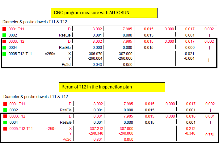

[Sa...] Posted June 30, 2025 Share Posted June 30, 2025 Hello, I'm having a different outcome after a re-measurement. When I run a 30 min program in autorun, and rerun a specific hole after I get a big difference as shown below hole T12. My method is the following: After loading the inspection plan, I use the "load measuering points" option. Then I double check that every value is correct as the autorun measurement. Check is OK, then I re-measure a specific hole T12 and get difference of 0.751mm?? Note that the piece is not moved, and it's on all programs. *I have 6 CMM's, and on other others it works just fine. Calypso 2017 Version 6.4.08 Prismo 10 Thank you in advance for sharing your thoughts. Sam Link to comment https://qualityforum.zeiss.com/topic/23819-rerun-error-between-autorun-inspectionplan/ Share on other sites More sharing options...
[Ma...] Posted June 30, 2025 Share Posted June 30, 2025 There will be problem with alignment. If you want to remeasure, then you have to run base alignment too. I wouldn't trust without running that. 1 Link to comment https://qualityforum.zeiss.com/topic/23819-rerun-error-between-autorun-inspectionplan/#findComment-134497 Share on other sites More sharing options...
[Je...] Posted July 1, 2025 Share Posted July 1, 2025 100% alignment issue. Please sign in to view this quote. 1 Link to comment https://qualityforum.zeiss.com/topic/23819-rerun-error-between-autorun-inspectionplan/#findComment-134555 Share on other sites More sharing options...
