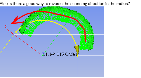

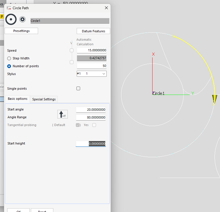

[ji...] Posted June 30, 2025 Share Posted June 30, 2025 Please see attached . Does anyone know how to reverse the circle scanning path ? For whatever reason if I scan a radius path from left to right the stylus falls off the geometry. I need to scan from right to left. Link to comment https://qualityforum.zeiss.com/topic/23823-reverse-circle-scanning-path/ Share on other sites More sharing options...
[Cl...] Posted June 30, 2025 Share Posted June 30, 2025 Feature > Strategy > Circle Path > Start Angle 0°/180° Link to comment https://qualityforum.zeiss.com/topic/23823-reverse-circle-scanning-path/#findComment-134519 Share on other sites More sharing options...
[Ma...] Posted June 30, 2025 Share Posted June 30, 2025 You can also change the space axis from +/- in the feature window. Link to comment https://qualityforum.zeiss.com/topic/23823-reverse-circle-scanning-path/#findComment-134523 Share on other sites More sharing options...

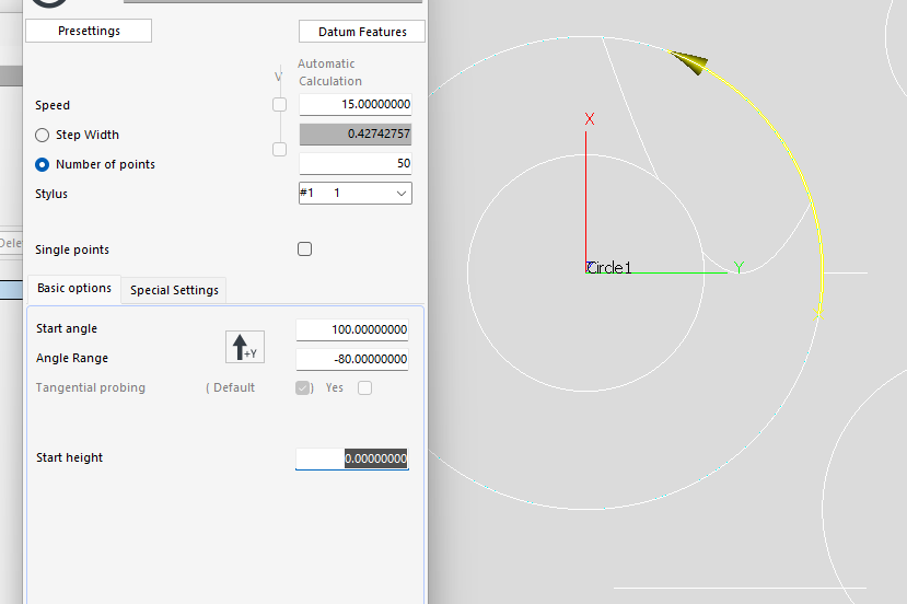

[An...] Posted August 11, 2025 Share Posted August 11, 2025 Add the angle range value to your starting position value. Then change your angle range into a negative. Link to comment https://qualityforum.zeiss.com/topic/23823-reverse-circle-scanning-path/#findComment-136593 Share on other sites More sharing options...
