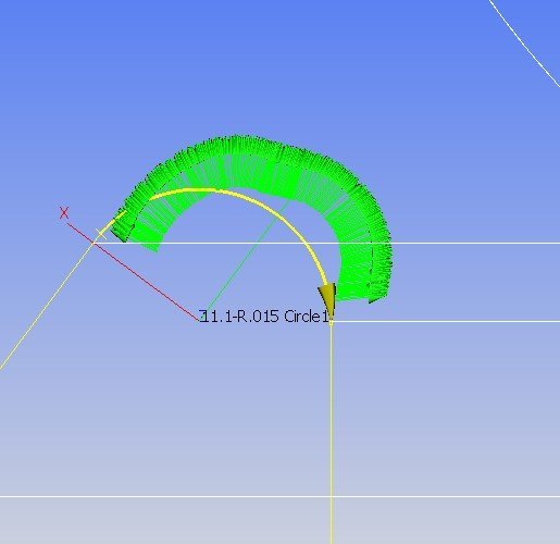

[ji...] Posted June 30, 2025 Share Posted June 30, 2025 Is there anyway to get the point-scan profile to graph on the report? The view below would be perfect for evaluating any defects on the radius. Link to comment https://qualityforum.zeiss.com/topic/23825-graph-scan-profile/ Share on other sites More sharing options...
[Cl...] Posted June 30, 2025 Share Posted June 30, 2025 (edited) Open the characteristic you want to display. Click "Graphic" in the upper-right corner. When that opens you have multiple options. I haven't used this in quite a while, and when I try to execute it in my planner, I get an error message, so I can't go into greater detail. I'm sure someone else in here can help with that. Edited June 30, 2025 Link to comment https://qualityforum.zeiss.com/topic/23825-graph-scan-profile/#findComment-134521 Share on other sites More sharing options...
[An...] Posted August 14, 2025 Share Posted August 14, 2025 This will be your best bet. CAD Evaluation. https://portal.zeiss.com/knowledge-base?id=443694 Link to comment https://qualityforum.zeiss.com/topic/23825-graph-scan-profile/#findComment-136799 Share on other sites More sharing options...
