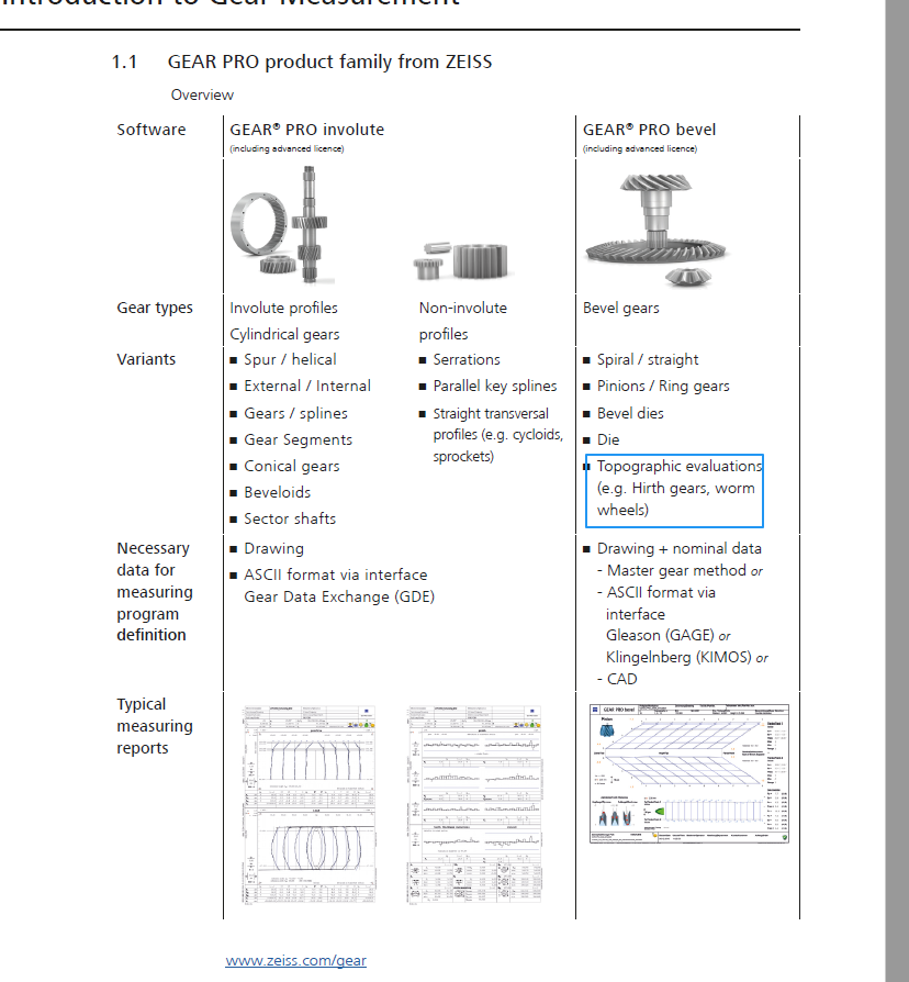

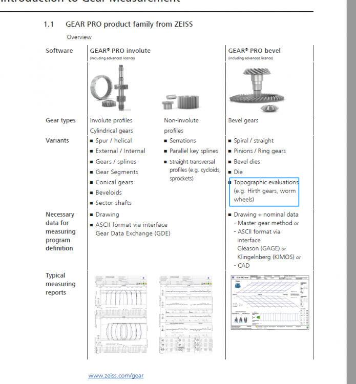

[Lv...] Posted July 1, 2025 Share Posted July 1, 2025 Does anyone use bevel option to measure hirth tooth? I saw the manual can display the Topographic for hirth and worm wheel! Link to comment https://qualityforum.zeiss.com/topic/23833-gear-pro-bevel-can-measure-hirth-tooth/ Share on other sites More sharing options...
[Ro...] Posted July 1, 2025 Share Posted July 1, 2025 This solution describes a topographical evaluation against nominal data. Nominal data either as ASCII point cloud data or as CAD file. If you have nominal data in that format you can realize a topographical nominal/actual comparison similar to what is done for bevel gears. An example printout is also visible in your screenshot on the lower right side. 1 Link to comment https://qualityforum.zeiss.com/topic/23833-gear-pro-bevel-can-measure-hirth-tooth/#findComment-134543 Share on other sites More sharing options...
