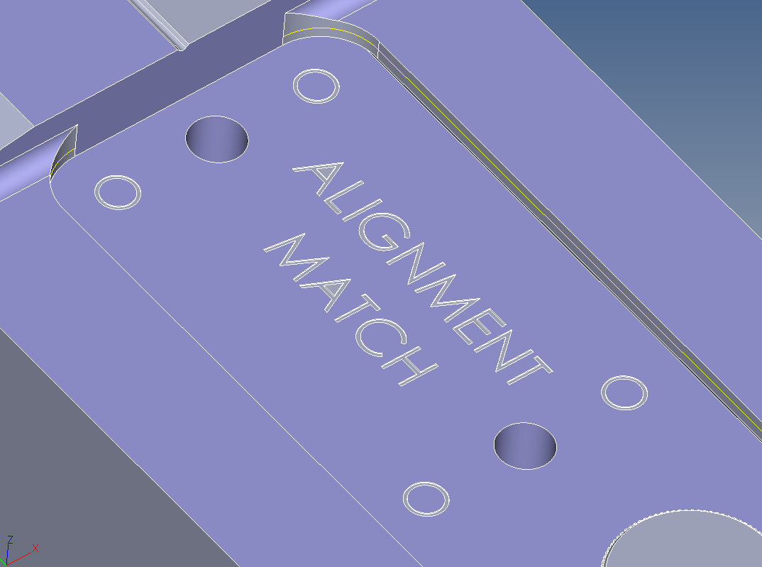

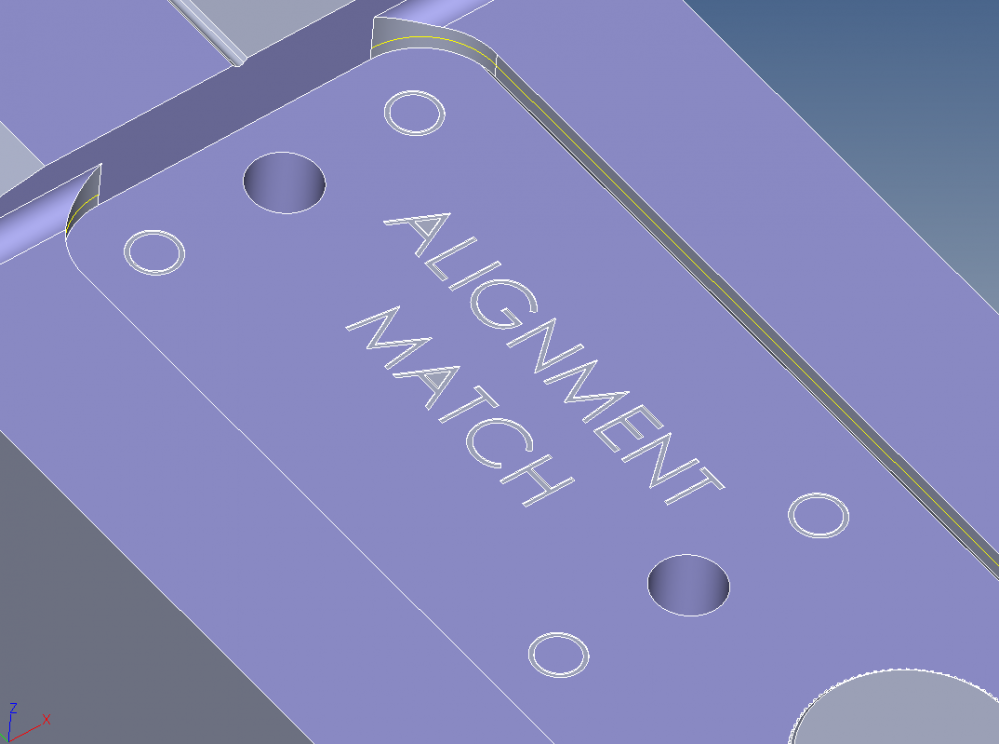

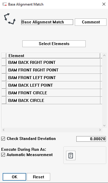

[Pe...] Posted July 3, 2025 Share Posted July 3, 2025 Hello, I have an excessively long part (55 inches) that is going to have to use a base alignment match to measure the whole thing. The part itself sits on a fixture so it was my thought that I could use the fixture itself to do the alignment match. My plan is to have 4 points (that I engrave circles around to give a target for the operators to hit) and two circles (two reamed holes) to establish the alignment match. Which sounds like it could make a perfectly stable alignment. But when setting up the match, you cant tell it that the points should define the Z level and circles would define XY and you cant define a rotation in space or a planar alignment (I am guessing that it uses some sort of best fit of all features selected). So how do I know that the manual probing of the circles aren't driving the Z and likewise the points aren't dragging XY around? In simulation, it gives a high standard deviation for the match. I can only assume that is because of the above issue, I can't click the manual points exactly where the nominal positions of points and circles are. So how bad of a deviation would be acceptable? I have set to execute as an automatic measurement after so it will run the same alignment in cnc mode to help with that. But is there a way to loop that cnc run for accuracy or is that not necessary? Link to comment https://qualityforum.zeiss.com/topic/23869-base-alignment-match-help/ Share on other sites More sharing options...
[Da...] Posted July 3, 2025 Share Posted July 3, 2025 Use the 4 points as a plane (Rotation in space), create a 2D line on the wall of the cut-out (for Planar Rotation) and then choose one of the cylinders to control X and Y. Link to comment https://qualityforum.zeiss.com/topic/23869-base-alignment-match-help/#findComment-134745 Share on other sites More sharing options...
[Pe...] Posted July 3, 2025 Author Share Posted July 3, 2025 Please sign in to view this quote. Base alignment match does not allow you to define rotations in space or planer rotations. All you can do is select from a list of features: Link to comment https://qualityforum.zeiss.com/topic/23869-base-alignment-match-help/#findComment-134747 Share on other sites More sharing options...
[Da...] Posted July 3, 2025 Share Posted July 3, 2025 How to Leapfrog alignments- alignment match.pdf This is what I have that is similar to what you are trying to do. Not exactly what you want but maybe it can help. Link to comment https://qualityforum.zeiss.com/topic/23869-base-alignment-match-help/#findComment-134775 Share on other sites More sharing options...
