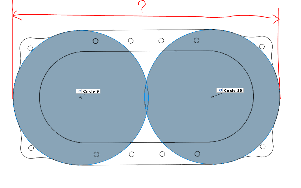

[Üm...] Posted July 7, 2025 Share Posted July 7, 2025 Hello. I have 2 circles parallel to each other. How can I query how far these circles are from each other (outside to outside). Can you help me? It is very urgent. Link to comment https://qualityforum.zeiss.com/topic/23883-how-can-i-query-the-distance-between-2-circles-from-outside-to-outside/ Share on other sites More sharing options...
[Na...] Posted July 7, 2025 Share Posted July 7, 2025 Hello Ümit, create outer disc caliper, selection is done by RMB on circles -> restore point selection outer disc caliper touching the section create "curve from 2d geometrical element" -> touch with outer disc caliper Create two point distance between Circles and add the radii values with a user defined check. It depends if you want to touch the section or touch the circumference of the fitting circles. Nanno 1 Link to comment https://qualityforum.zeiss.com/topic/23883-how-can-i-query-the-distance-between-2-circles-from-outside-to-outside/#findComment-134815 Share on other sites More sharing options...
[Du...] Posted July 9, 2025 Share Posted July 9, 2025 I would... 1.Create 2 point line between the circles, gives you a vector 2.Point Normal Intersection Point, Construct-Point-Other. Use the Line vector (create point) and then invert direction Create Point) to intersect the outer edge of the circles 3. Create out Touch Edge Distance using the original line created between the two circles as your distance vector. If your part isn't lined up to a coordinate system, then create two circles adjacent to each other and create another 2 point line between them. That will give you your edge direction Link to comment https://qualityforum.zeiss.com/topic/23883-how-can-i-query-the-distance-between-2-circles-from-outside-to-outside/#findComment-134959 Share on other sites More sharing options...
