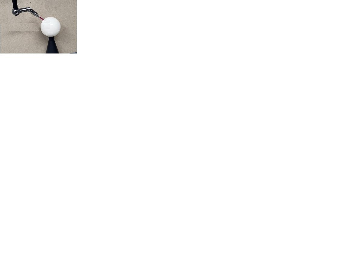

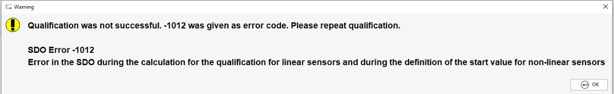

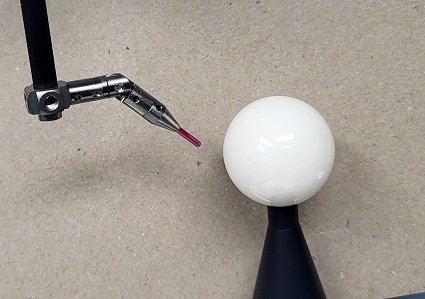

[Ca...] Posted July 8, 2025 Share Posted July 8, 2025 I am trying to qualify this style in 135 degrees taper in +Y direction but we get an error message "Qualification was not successful. -1012 was given as error code...SDO Error -1012..." We have some other spherical or ball styles at 180 degrees in star holder but not problem for Qualification in DuraMax. Link to comment https://qualityforum.zeiss.com/topic/23891-qualify-a-cylindrical-probe-spherical-bottom-end-with-a-taper-angle-in-duramax/ Share on other sites More sharing options...
[To...] Posted July 8, 2025 Share Posted July 8, 2025 Are you driving the stylus at a 45° angle Link to comment https://qualityforum.zeiss.com/topic/23891-qualify-a-cylindrical-probe-spherical-bottom-end-with-a-taper-angle-in-duramax/#findComment-134875 Share on other sites More sharing options...

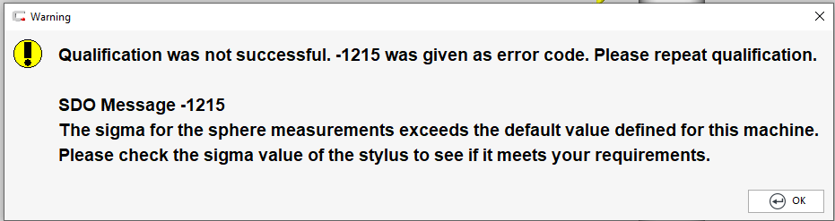

[Ca...] Posted July 8, 2025 Author Share Posted July 8, 2025 Yes, 45 degrees. The first problem was solved. The Guys did not tight the holder. Now I get this error: Link to comment https://qualityforum.zeiss.com/topic/23891-qualify-a-cylindrical-probe-spherical-bottom-end-with-a-taper-angle-in-duramax/#findComment-134877 Share on other sites More sharing options...
[Ca...] Posted July 8, 2025 Author Share Posted July 8, 2025 After repeat the Qualification ich get the sigma but 0.002... I think we must repeat the process. Link to comment https://qualityforum.zeiss.com/topic/23891-qualify-a-cylindrical-probe-spherical-bottom-end-with-a-taper-angle-in-duramax/#findComment-134879 Share on other sites More sharing options...
[Ab...] Posted July 8, 2025 Share Posted July 8, 2025 Here are some troubleshooting for error sdo message -1215 https://portal.zeiss.com/knowledge-base?id=1105583 1 Link to comment https://qualityforum.zeiss.com/topic/23891-qualify-a-cylindrical-probe-spherical-bottom-end-with-a-taper-angle-in-duramax/#findComment-134885 Share on other sites More sharing options...
