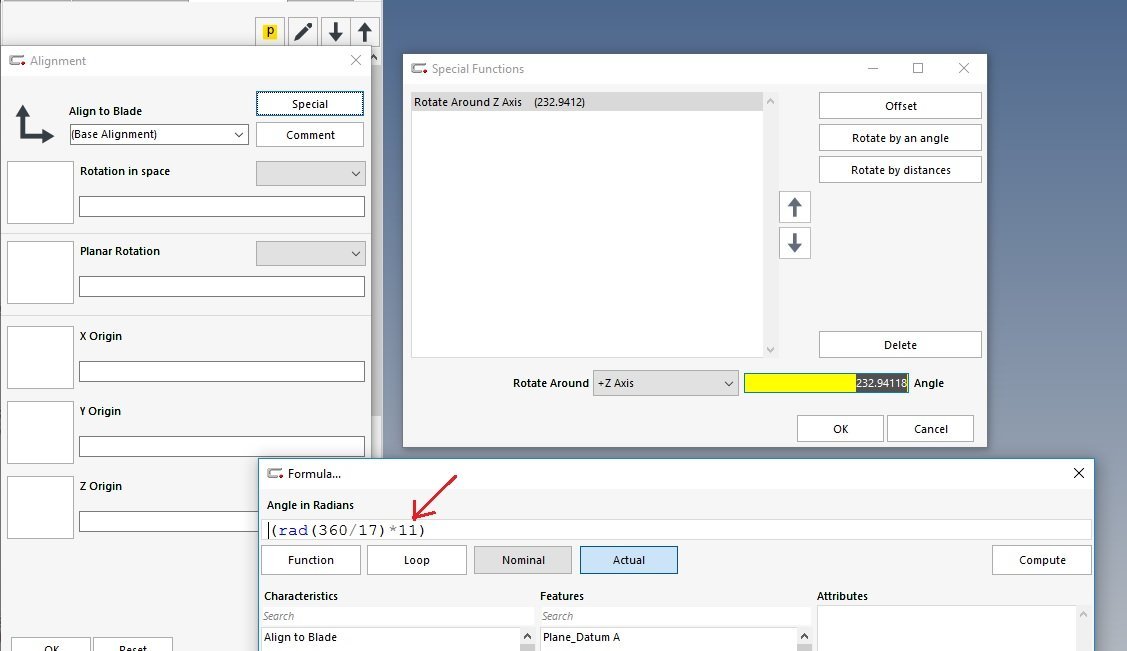

[To...] Posted July 8, 2025 Share Posted July 8, 2025 (edited) I'm measuring a turbine blade with 17 blades but I can only measure 1 blade at a time with VAST sensor. Based on which blade I am checking, I rotate the part so the timing slot is at the correct rotation. My base alignment picks up the spatial, X, Y and Z origin but not the planar. I use a secondary alignment to pick up the timing slot for the planar rotation. I am using a formula to determine which blade is being measured. So, for each new blade, I open the secondary alignment and edit the number in the formula to select which blade I am checking. In the picture below, the "11" is for blade3. I'm looking for suggestions for a prompt where I can enter the blade I want to check and have pcm edit the formula in the secondary alignment to run the appropriate blade. Blade Formula number 1 9 2 10 3 11 . . . 15 6 16 7 17 8 Edited July 8, 2025 Link to comment https://qualityforum.zeiss.com/topic/23893-operator-input-for-secondary-alignment/ Share on other sites More sharing options...
[Cl...] Posted July 8, 2025 Share Posted July 8, 2025 (edited) If I'm understanding you correctly, I think this should work. I'm no PCM expert. Below goes into the Presettings. Create a .para file with the formula number for each blade, e.g. (Blade_3 = the formula here) Blade_Number = inquireList("Which Blade are you measuring?", "Blade_1", "Blade_2", "Blade_3") selectCase Blade_Number case "Blade_3" readPCMFile(dir + "\Blade_3.PARA") endSelect Edited July 8, 2025 1 Link to comment https://qualityforum.zeiss.com/topic/23893-operator-input-for-secondary-alignment/#findComment-134893 Share on other sites More sharing options...
[Je...] Posted July 9, 2025 Share Posted July 9, 2025 I would do it like Clarke, but a bit easier: Blade_Number = inquireList("Which Blade are you measuring?", "Blade_1", "Blade_2", "Blade_3",...) selectCase Blade_Number case "Blade_3" vX=11 case "Blade_4" vX=12 endSelect Then replace the 11 in your formula with the variable vX 1 Link to comment https://qualityforum.zeiss.com/topic/23893-operator-input-for-secondary-alignment/#findComment-134907 Share on other sites More sharing options...
[To...] Posted July 9, 2025 Author Share Posted July 9, 2025 Please sign in to view this username. Please sign in to view this username. Exactly what I was looking for. Thank you. 2 Link to comment https://qualityforum.zeiss.com/topic/23893-operator-input-for-secondary-alignment/#findComment-134929 Share on other sites More sharing options...
