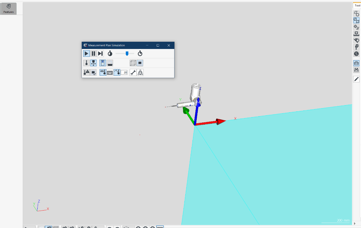

[Ji...] Posted July 10, 2025 Share Posted July 10, 2025 everyone, i found my machine is missed in simulation. What happened? 1 Link to comment https://qualityforum.zeiss.com/topic/23915-simulation-cmm-machine-missed/ Share on other sites More sharing options...
[No...] Posted July 10, 2025 Share Posted July 10, 2025 There are two typical reasons: There's no CAD model available for the machine type you selected in the CMM setup The measurement range you defined in the CMM setup doesn't match any of the available models Link to comment https://qualityforum.zeiss.com/topic/23915-simulation-cmm-machine-missed/#findComment-134997 Share on other sites More sharing options...
[Ma...] Posted July 10, 2025 Share Posted July 10, 2025 Click button 2nd row 4th from left Link to comment https://qualityforum.zeiss.com/topic/23915-simulation-cmm-machine-missed/#findComment-135003 Share on other sites More sharing options...
[No...] Posted July 10, 2025 Share Posted July 10, 2025 (edited) Please sign in to view this quote. That's only the "granite" button, showing a representation of the granite plate if there is no full CAD model available. The button for the full model is missing in the screenshot. Typically happens when no suitable model is available or none at all. Edited July 10, 2025 Link to comment https://qualityforum.zeiss.com/topic/23915-simulation-cmm-machine-missed/#findComment-135035 Share on other sites More sharing options...
[Ji...] Posted July 11, 2025 Author Share Posted July 11, 2025 Please sign in to view this quote. how tot set up the CMM CAD model.. Link to comment https://qualityforum.zeiss.com/topic/23915-simulation-cmm-machine-missed/#findComment-135093 Share on other sites More sharing options...
[No...] Posted July 11, 2025 Share Posted July 11, 2025 (edited) Please sign in to view this quote. You can't do that yourself. CMM models are provided by Zeiss (or not) and are installed with the software. They are displayed automatically if the selected CMM type and size match. If no model is displayed for your selection, there's nothing more you can do about it (except ask Zeiss if they're willing to add one for you for $$$ 😮). Edited July 11, 2025 Link to comment https://qualityforum.zeiss.com/topic/23915-simulation-cmm-machine-missed/#findComment-135125 Share on other sites More sharing options...
