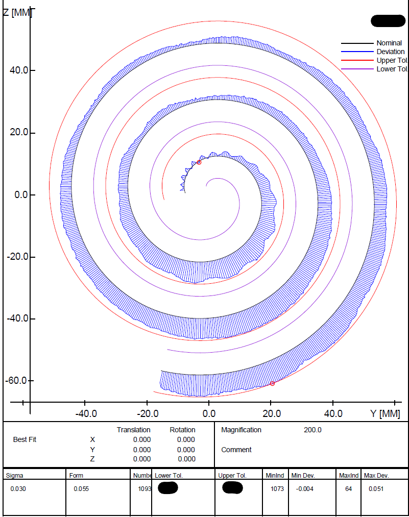

[Jo...] Posted July 10, 2025 Share Posted July 10, 2025 Hi All, I am looking to understand if it is possible to create a profile plot similar to the below curve form plot. I would like to do this without the use of CAD presentation. TIA! Link to comment https://qualityforum.zeiss.com/topic/23927-profile-plot-of-a-2d-curve/ Share on other sites More sharing options...
[Kl...] Posted July 11, 2025 Share Posted July 11, 2025 Hello Joseph PiWeb Reporting is more flexible compared to the "old" plot. I add an example pdf for radial and axial evaluation created with CALYPSO rev 7.6 Please tell me, if you need the inspection. Greetings from Germany Klaus 9.pdf Link to comment https://qualityforum.zeiss.com/topic/23927-profile-plot-of-a-2d-curve/#findComment-135083 Share on other sites More sharing options...
[Jo...] Posted July 11, 2025 Author Share Posted July 11, 2025 Thanks for the reply Please sign in to view this username. ! Do you need Piweb reporting Plus for those types of plots? Or can this be done using the free version? I would be curious to see the inspection if you can share it. Thanks, JG Link to comment https://qualityforum.zeiss.com/topic/23927-profile-plot-of-a-2d-curve/#findComment-135099 Share on other sites More sharing options...
[Kl...] Posted July 11, 2025 Share Posted July 11, 2025 Hello Joseph should run by simulation with dispersion. It's written in [mm]. Customized reports inside inspection, could be modified by standard PiWeb. Enjoy it 🙂 Klaus Spiral.zip 1 Link to comment https://qualityforum.zeiss.com/topic/23927-profile-plot-of-a-2d-curve/#findComment-135109 Share on other sites More sharing options...
