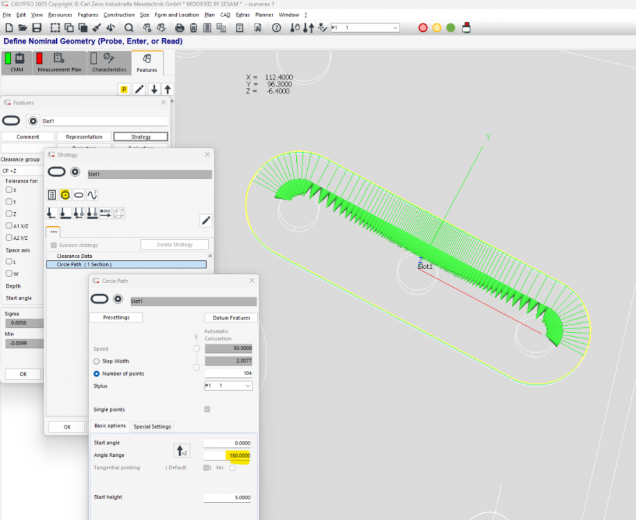

[Co...] Posted July 15, 2025 Share Posted July 15, 2025 I'm trying to just scan half of a slot(apex to apex). I cant seem to figure out how to adjust the start angle and angle range in the strategy. Any suggestions? Link to comment https://qualityforum.zeiss.com/topic/23945-scanning-just-half-a-slot/ Share on other sites More sharing options...
[Cl...] Posted July 15, 2025 Share Posted July 15, 2025 (edited) You can create and slice a nominal plane through 180° of the slot [CAD > Creating Features > Section] or just pick the potions of the curve you need and create a 2d curve. (or whatever it is apex to apex). Then recall the curve into the slot feature. Edited July 15, 2025 1 Link to comment https://qualityforum.zeiss.com/topic/23945-scanning-just-half-a-slot/#findComment-135231 Share on other sites More sharing options...
[Dr...] Posted July 15, 2025 Share Posted July 15, 2025 Unfortunately the canned Slot strategy doesn't currently accommodate incomplete slots, only full scans. Clarke's answer with a 2d Curve should be indistinguishable from what you're looking for; if you don't have Curve, you'll need to create two Circle features and a Line to gather the data piece by piece, then Recall Data Points into a slot. 1 Link to comment https://qualityforum.zeiss.com/topic/23945-scanning-just-half-a-slot/#findComment-135233 Share on other sites More sharing options...
[Ch...] Posted July 15, 2025 Share Posted July 15, 2025 I haven't tried this myself yet but CALYPSO 2025 (8.0) may allow you to define a circle path strategy with angle range instead of a slot path. Maybe worth a test depending on what dimension you are after and your version of CALYPSO. 3 Link to comment https://qualityforum.zeiss.com/topic/23945-scanning-just-half-a-slot/#findComment-135251 Share on other sites More sharing options...
