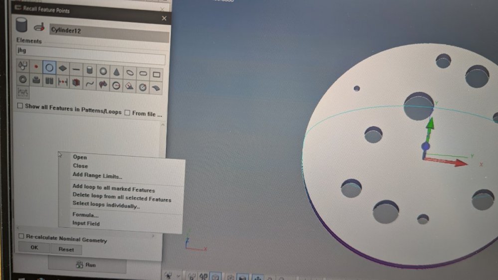

[Ra...] Posted July 29, 2025 Share Posted July 29, 2025 It is an absolute shame. I still can't get it to work to be honest. I've tried right clicking everywhere. Link to comment https://qualityforum.zeiss.com/topic/23963-recall-feature-points-from-a-single-circle-path-of-a-cylinder-high-volume-loop-or-pattern/page/2/#findComment-135879 Share on other sites More sharing options...
[He...] Posted July 29, 2025 Share Posted July 29, 2025 (edited) Please sign in to view this quote. Very strange. I'm doing the same exact thing and it works just fine. I have tried it with 6.8.2002 and 6.8.24. What service pack are you using? Edited July 29, 2025 1 Link to comment https://qualityforum.zeiss.com/topic/23963-recall-feature-points-from-a-single-circle-path-of-a-cylinder-high-volume-loop-or-pattern/page/2/#findComment-135893 Share on other sites More sharing options...
[Ra...] Posted July 29, 2025 Share Posted July 29, 2025 6.8.08. Maybe I need to update. I mean I might as well. I'll report back if IT has time today. Link to comment https://qualityforum.zeiss.com/topic/23963-recall-feature-points-from-a-single-circle-path-of-a-cylinder-high-volume-loop-or-pattern/page/2/#findComment-135897 Share on other sites More sharing options...
[Iv...] Posted July 30, 2025 Author Share Posted July 30, 2025 I'm running 7.8.12, and I can access the formula option in the Recall Feature Points. @Henrik Lindahl, I think your idea is great and I'm verifying it now. Unfortunately, I encountered an issue where my cylinder list starts at "106" instead of "1". I'm not too familiar with the PCM coding, so does anyone have any recommendations on how to have the loop start at 106? I tried variable functions/combinations within the list formula, but I could not get the loop to start at "106" properly. Any tips? Should be fairly easy. Also, what coding language does PCM most closely follow? C++, Java, Python? Link to comment https://qualityforum.zeiss.com/topic/23963-recall-feature-points-from-a-single-circle-path-of-a-cylinder-high-volume-loop-or-pattern/page/2/#findComment-136041 Share on other sites More sharing options...

[He...] Posted July 31, 2025 Share Posted July 31, 2025 Please sign in to view this quote. Do you have any gaps in your names or does it run uninterrupted from 106 to 2000+? If you have an uninterrupted series it should work if you change "Cylinder" +LOOP1 to "Cylinder" +(LOOP1+105) The brackets at important in 6.8 and I think it is the same in later versions. I'm not at my computer right now so I can't verify this but I think it will work. 1 Link to comment https://qualityforum.zeiss.com/topic/23963-recall-feature-points-from-a-single-circle-path-of-a-cylinder-high-volume-loop-or-pattern/page/2/#findComment-136075 Share on other sites More sharing options...
[Iv...] Posted July 31, 2025 Author Share Posted July 31, 2025 Thanks, Henrik! That worked perfectly. I originally tried adding that "105" index outside the loop, so it makes sense why my combinations did not work 🤦🏼♂️. But I have my cylinder interrupted in quarters—cylinder 106 to 696, 3065 to 6025, etc. While 2000+ already seems like a lot of cylinders, the actual part has about 9000 total cylinders. We are only completing a 25% sample coverage 😆 super fun stuff! Due to these interruptions and my limited knowledge in PCM. I planned to have 4 different "CylinderX's" so that I could capture each segment. But happy to hear if you have any recommendations to account for the interrupted series in the loop, I'd be interested. I'm currently implementing your suggestion into my program. I will update you guys shortly! Great thinking on the formulas in each nominal for the CylinderX feature. I mistakenly thought these were highlighted in yellow since the recall feature points were a formula. Nice touch! Thanks again for the help so far! Link to comment https://qualityforum.zeiss.com/topic/23963-recall-feature-points-from-a-single-circle-path-of-a-cylinder-high-volume-loop-or-pattern/page/2/#findComment-136109 Share on other sites More sharing options...

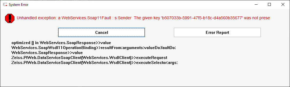

[Iv...] Posted July 31, 2025 Author Share Posted July 31, 2025 Seperate issue, but when generating the PiWeb results, I've been hit with this System Error that halts the PiWeb results from saving/opening. Just in the last couple of days, I've seen it across multiple workstations and programs. I searched the forum and couldn't find any other tips to resolve this. And in case you wonder, how I was able to verify the process without results. This error only blocks the PiWeb report; the Tables Files are still exporting out. Because these parts are so data-dense, we use a combination of the Table Files and PiWeb reports to analyze the reporting. Link to comment https://qualityforum.zeiss.com/topic/23963-recall-feature-points-from-a-single-circle-path-of-a-cylinder-high-volume-loop-or-pattern/page/2/#findComment-136123 Share on other sites More sharing options...
[He...] Posted July 31, 2025 Share Posted July 31, 2025 Please sign in to view this quote. It is not possible to separate measurements within single features. The feature would have to be separated in two different cylinders and then recalled into one. But that is a lot of work for a part like this. The PCM to create a list with gaps is quite simple. I will try to do it tomorrow or the day after that. 1 Link to comment https://qualityforum.zeiss.com/topic/23963-recall-feature-points-from-a-single-circle-path-of-a-cylinder-high-volume-loop-or-pattern/page/2/#findComment-136125 Share on other sites More sharing options...

[He...] Posted August 2, 2025 Share Posted August 2, 2025 Here is a solution for interrupted cylinder indexes. In presetting of the program a list is created with the name of each cylinder that are to be used in the pattern. This is used both in the nominal fields and in the recall formula. TestplateWithInteruptions.zip 3 Link to comment https://qualityforum.zeiss.com/topic/23963-recall-feature-points-from-a-single-circle-path-of-a-cylinder-high-volume-loop-or-pattern/page/2/#findComment-136201 Share on other sites More sharing options...

[Ke...] Posted August 5, 2025 Share Posted August 5, 2025 Please sign in to view this quote. In my experience the Soap fault usually indicates an issue with the piweb database, more commonly in older Calypso versions where it used a different format that was more prone to maxing out in size. My first check would be to make sure you have harddrive space, and after that I would suggest finding the PiwebReportingDatabases folder (usually at C:/User/Public/Documents/Zeiss/Calypso X.x/workarea), and inside there finding the database file for a program that is seeing the error. Move that file elsewhere (dont delete it, for retention purposes), and run the program to see if that resolves the issue. 1 Link to comment https://qualityforum.zeiss.com/topic/23963-recall-feature-points-from-a-single-circle-path-of-a-cylinder-high-volume-loop-or-pattern/page/2/#findComment-136299 Share on other sites More sharing options...
