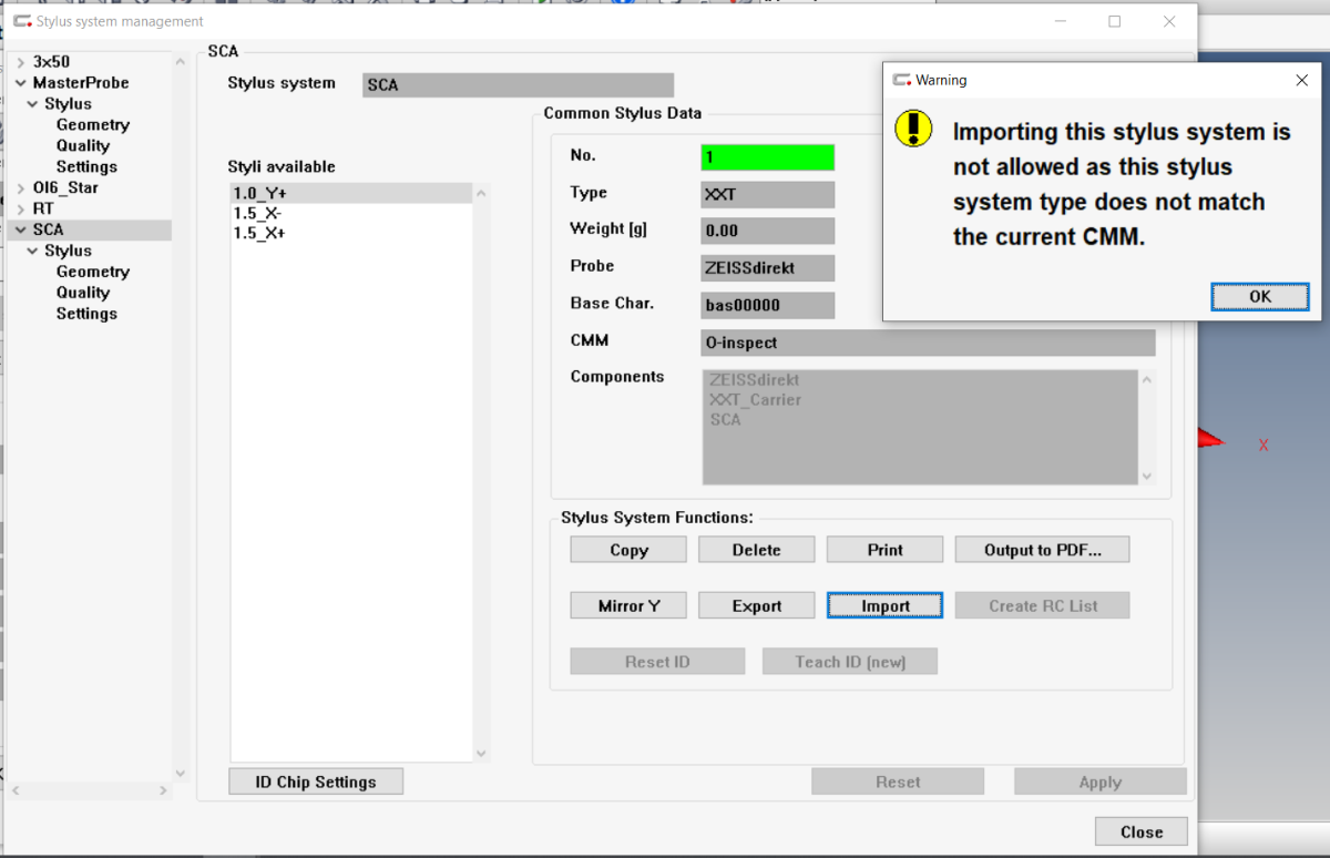

[Cl...] Posted July 22, 2025 Share Posted July 22, 2025 Trying to set-up my planner for an O-inspect-543. Planner is not allowing me to import the camera or DotScan. I get this message when I try? I set the machine and probe type correctly. Link to comment https://qualityforum.zeiss.com/topic/23989-o-inspect-planner/ Share on other sites More sharing options...

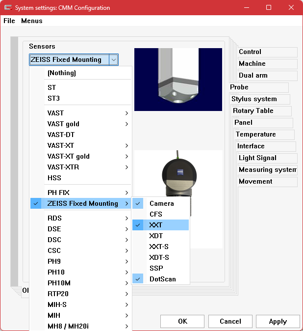

[Ed...] Posted July 22, 2025 Share Posted July 22, 2025 I add them under CMM settings. Link to comment https://qualityforum.zeiss.com/topic/23989-o-inspect-planner/#findComment-135531 Share on other sites More sharing options...
[Cl...] Posted July 23, 2025 Author Share Posted July 23, 2025 Ah. I was choosing CFS by mistake. Thanks Edgar! Link to comment https://qualityforum.zeiss.com/topic/23989-o-inspect-planner/#findComment-135575 Share on other sites More sharing options...
