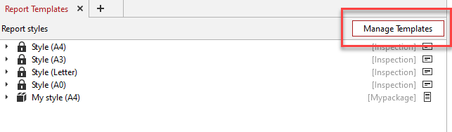

[Ro...] Posted November 24, 2020 Share Posted November 24, 2020 The goal is add existing report page template "Title - With 3D model" to the Report Style "MCAE - ROBERT Templates". There is possible add it to the Package but not inside the group "MCAE - ROBERT Templates". The easiest intuitive way drag&drop does not work. drag and drop.mp4 Manage template.mp4 Link to comment https://qualityforum.zeiss.com/topic/24-how-to-add-existing-report-page-template-to-the-existing-report-style-in-the-package/ Share on other sites More sharing options...
[Ch...] Posted December 7, 2020 Share Posted December 7, 2020 Dear Robert, This task is a bit tricky in 2020 - what you want is to override your report templates in the end.. so you need a function with the same name: "Overwrite Report Template" in the beginning when wanting to add report pages / templates via rmb to the report style that is already contained in a package. I attached a screen video shows how this works: 1673709609_editreporttemplatespackage.mp4 Link to comment https://qualityforum.zeiss.com/topic/24-how-to-add-existing-report-page-template-to-the-existing-report-style-in-the-package/#findComment-66 Share on other sites More sharing options...

[Ch...] Posted April 14, 2021 Share Posted April 14, 2021 Dear Han, Thank you for the feedback, packages replaced the skins and both of them are used to store templates. The advantage of the new packages is that you can see now what is contained in the package, share them more easy and have control on its version, to mention some. As we give more access/insight into template management this raises its complexity as you said. I just reviewed my last video, and saw that the template managing was actually complicated - it is more easy so you can add templates to packages where you create them. For sure we do not have the aim to provide within a new release facelifts only, but features. Thereby regularly customer feedback and wishes are taken into account, too. As in this case to long term users the workflow has changed. - We already adressed this to get an improved workflow for the next software version 2021. I assume you gained the update training in the Training Center and the Whats New documentation in the Direct Help of the GOM Software, which is giving insight into new Versions of the Software. Link to comment https://qualityforum.zeiss.com/topic/24-how-to-add-existing-report-page-template-to-the-existing-report-style-in-the-package/#findComment-477 Share on other sites More sharing options...
