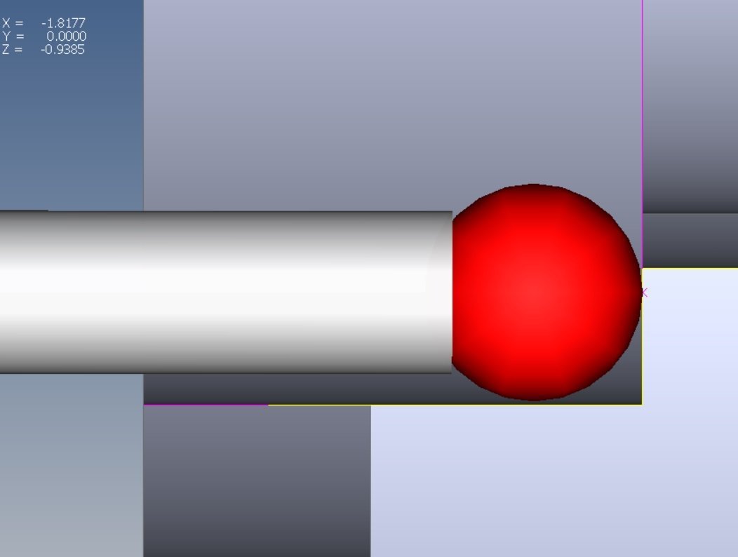

[To...] Posted July 25, 2025 Share Posted July 25, 2025 Looking for suggestions for settings on a self-centering point. In the pic below, view is from -Y) I am using a 0.8 stylus to measure the depth of a step that is 0.5 wide. Though this will be done with VAST Gold head, sometimes when using a star probe on an XXT, there is a tendency for the probe to glance of the step and slide past the step. I'm thinking a self-centering point with some force towards the side wall, along with force in the probing direction might help. I am also taking a point on the side wall to help control the location of the point on the step, so I can get as close as possible. I am also considering lowering the probing dynamic. How would you guys approach this? Link to comment https://qualityforum.zeiss.com/topic/24035-self-centering-point-suggestions/ Share on other sites More sharing options...

[To...] Posted July 25, 2025 Author Share Posted July 25, 2025 Please sign in to view this username. Seems like a touch point would still calculate to the tip, but I will try both and compare. Link to comment https://qualityforum.zeiss.com/topic/24035-self-centering-point-suggestions/#findComment-135737 Share on other sites More sharing options...
[Ni...] Posted July 25, 2025 Share Posted July 25, 2025 I'd personally just try a single point with the feature aligned on the nearest surfaces with the probing dynamic turned down to 12.5% Link to comment https://qualityforum.zeiss.com/topic/24035-self-centering-point-suggestions/#findComment-135741 Share on other sites More sharing options...

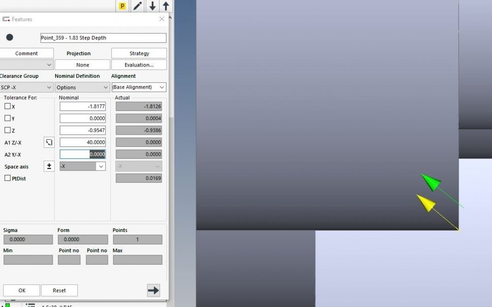

[Ke...] Posted July 29, 2025 Share Posted July 29, 2025 Although I am loathe to do any trial and error with a 0.8mm, it may be worth experimenting with the clamping of the machine axis during self centering, or using the "own selection" to set the directional forces. Adding a bit of downward force will likely help keep the probe from slipping off. My screenshot is from a +Z point in an empty program, so the Fz is simply -200 by default Link to comment https://qualityforum.zeiss.com/topic/24035-self-centering-point-suggestions/#findComment-135887 Share on other sites More sharing options...
[To...] Posted July 29, 2025 Author Share Posted July 29, 2025 I had trouble with using "Own Selection". No matter which values I used, it would slide off the step. I ended up using a touch point but modified the vector to come at an angle less than 45° and used "Probe in Normal Direction". Haven't confirmed the results yet. 1 Link to comment https://qualityforum.zeiss.com/topic/24035-self-centering-point-suggestions/#findComment-135901 Share on other sites More sharing options...

[Ri...] Posted July 29, 2025 Share Posted July 29, 2025 If you are going to probe in the direction, I would personally feel safer using mid-point, and just offsetting the probe radius manually. I'd be nervous of incorrect vector compensation. 1 Link to comment https://qualityforum.zeiss.com/topic/24035-self-centering-point-suggestions/#findComment-135909 Share on other sites More sharing options...
[To...] Posted July 29, 2025 Author Share Posted July 29, 2025 (edited) Please sign in to view this username. I did both and got the same exact result. Touch point reports to closest primary axis, which is X, so vector doesn't matter, as long as more X than Z. Checked depth in Z direction with .5 probe and result was within .0002". I'm going home and taking my ball with me. Edited July 29, 2025 2 Link to comment https://qualityforum.zeiss.com/topic/24035-self-centering-point-suggestions/#findComment-135927 Share on other sites More sharing options...
