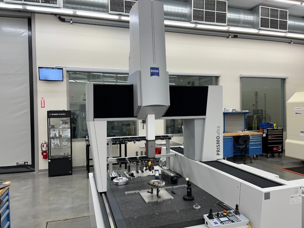

[Ch...] Posted July 25, 2025 Share Posted July 25, 2025 Can anyone with a Prismo Ultra verify if this picture is a size 7/10/5 or a 16/30/10. I think I know the answer, but I'd like to have someone verify it for me. I'm inheriting this machine from an affiliate, but all the info I have is just this picture. I need to rearrange one of my labs and I need to know how much floor space to clear out. Prismo Ultra.jfif Link to comment https://qualityforum.zeiss.com/topic/24039-is-this-a-prismo-ultra-7105-or-163010/ Share on other sites More sharing options...
[Ri...] Posted July 25, 2025 Share Posted July 25, 2025 It would be closer to a 7/10/5 than a 16/30/10. You can count the bolt holes as they are 200mm spacing. Link to comment https://qualityforum.zeiss.com/topic/24039-is-this-a-prismo-ultra-7105-or-163010/#findComment-135753 Share on other sites More sharing options...
[Ch...] Posted July 25, 2025 Author Share Posted July 25, 2025 That was my theory. And the letters on the bridge more closely match what the 7/10/5 looks like on Zeiss's website Link to comment https://qualityforum.zeiss.com/topic/24039-is-this-a-prismo-ultra-7105-or-163010/#findComment-135755 Share on other sites More sharing options...

[To...] Posted July 25, 2025 Share Posted July 25, 2025 my vote is 9/13/7 1 Link to comment https://qualityforum.zeiss.com/topic/24039-is-this-a-prismo-ultra-7105-or-163010/#findComment-135761 Share on other sites More sharing options...

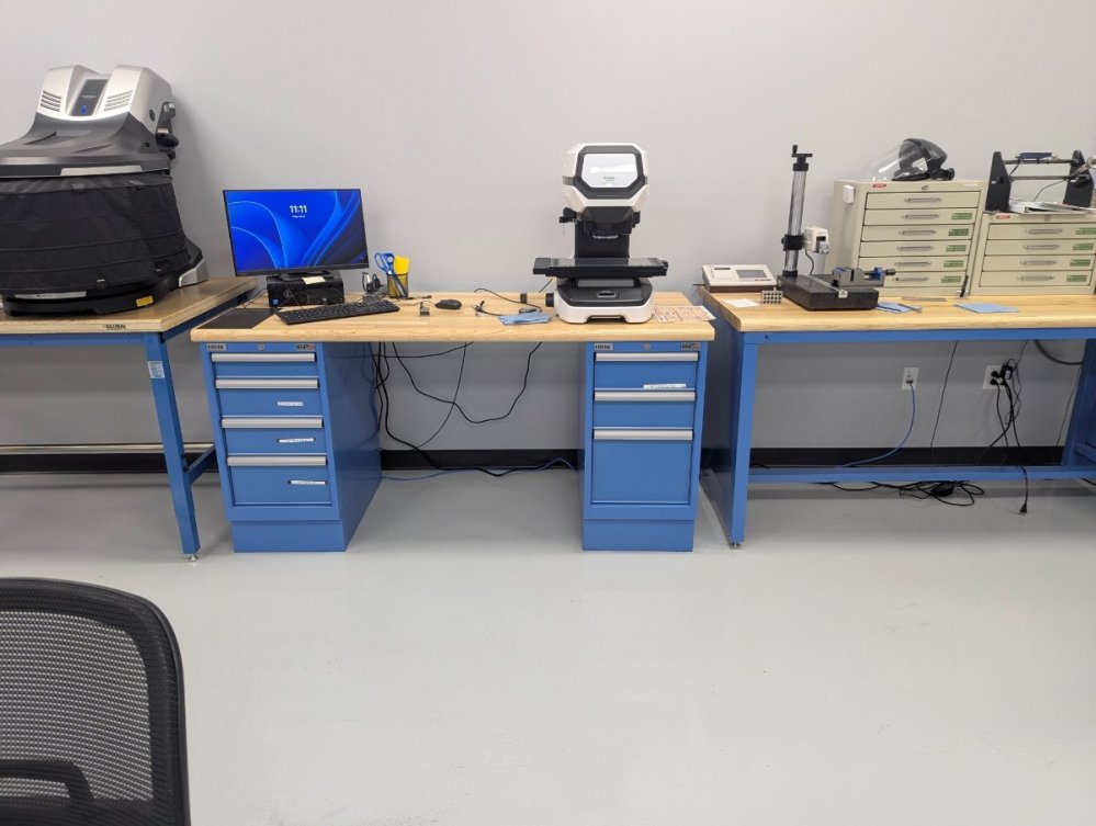

[Ch...] Posted July 25, 2025 Author Share Posted July 25, 2025 You could be right. It will look good next to my blue Lista workbench just like you have in the background. We'll match with you Tom. 1 Link to comment https://qualityforum.zeiss.com/topic/24039-is-this-a-prismo-ultra-7105-or-163010/#findComment-135763 Share on other sites More sharing options...
[Cl...] Posted July 25, 2025 Share Posted July 25, 2025 Keyence LM-X on the bench. Is this in Europe? Link to comment https://qualityforum.zeiss.com/topic/24039-is-this-a-prismo-ultra-7105-or-163010/#findComment-135765 Share on other sites More sharing options...
[Ch...] Posted July 25, 2025 Author Share Posted July 25, 2025 Nope, this is mine. Right here in the cornfields of America. I really like the LMX. It doesn't work for some applications but is great if you got the right part for it. 1 Link to comment https://qualityforum.zeiss.com/topic/24039-is-this-a-prismo-ultra-7105-or-163010/#findComment-135769 Share on other sites More sharing options...
[Ri...] Posted July 25, 2025 Share Posted July 25, 2025 Not the pizza oven. 😭 Link to comment https://qualityforum.zeiss.com/topic/24039-is-this-a-prismo-ultra-7105-or-163010/#findComment-135775 Share on other sites More sharing options...
[Ch...] Posted July 25, 2025 Author Share Posted July 25, 2025 I love my pizzazz. Don't tell Zeiss I got the Keyence VL instead of the GOM stuff. Link to comment https://qualityforum.zeiss.com/topic/24039-is-this-a-prismo-ultra-7105-or-163010/#findComment-135777 Share on other sites More sharing options...

[Ni...] Posted August 1, 2025 Share Posted August 1, 2025 We just got a 9/12/6 Contura. I believe our sensor rack can hold 7 or 8 of the probe sockets on each level so no way this is a 16(X) otherwise it'd be able to fit like 12+ pockets on each level of the rack. 1 Link to comment https://qualityforum.zeiss.com/topic/24039-is-this-a-prismo-ultra-7105-or-163010/#findComment-136177 Share on other sites More sharing options...
