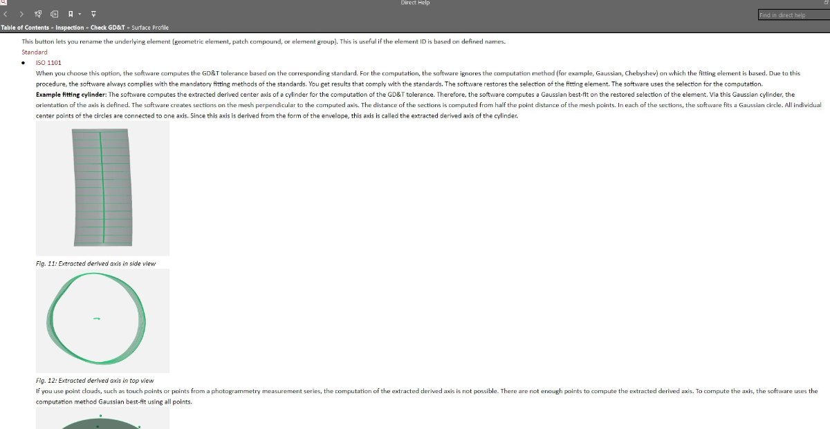

[Ti...] Posted July 25, 2025 Share Posted July 25, 2025 Question: Does anyone know the calculation difference b/w the two? Not a guess, but really know what is going on? The problem: I am testing 2025 Zeiss xray from 2021 GOM and some of our big programs went from 2:30min calculation times to 13:00min calculation times. After some analysis, I found it is due to ASME no datum surface profiles taking up the balance of the difference. I ran a 20 mesh study of ASME vs ISO and 95% of the profiles measure almost identical. The profile that did not measure identical had datums and measured 50% larger in ISO. I have 15 surface profiles in this program and there are plenty of other profiles with datums that measure the same. I am going to run the part in pcdmis with ASME vs ISO and see what I get on the CMM. Curious if anyone has definitive knowledge on the math behind the two. Thanks. Link to comment https://qualityforum.zeiss.com/topic/24045-asme-vs-iso-surface-profile-calculation/ Share on other sites More sharing options...

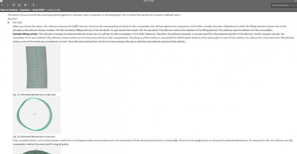

[Ti...] Posted July 27, 2025 Author Share Posted July 27, 2025 I tend to think that profile is measured in ISO and ASME the same way. 2x the worst point on the surface. I say this b/c profile of a line does not have an ISO vs ASME selection for the standard in GOM and the below explanation seems to be discussion how they differ if you select a cylinder for your surface profile...we do not select geometric features for our profiles we create separate surface patches to which you cannot apply a guassian or chebychev filter. The surface is where it is no matter what. Link to comment https://qualityforum.zeiss.com/topic/24045-asme-vs-iso-surface-profile-calculation/#findComment-135797 Share on other sites More sharing options...
[Ch...] Posted July 28, 2025 Share Posted July 28, 2025 The main difference between the two standards is what you have to do when your actual data is bigger than the nominal. Typically approaches are * measuring the distance to the nearest CAD triangle => ISO * interpolate the CAD so that the size between actual and nominal is comparable and afterwards compute the distance to the interpolated CAD => ASME In 2025 we have to change the computation algorithm due to rare problems with the old approach. We have expecting slightly longer computation times but nothing in the area of 5 times longer. In our internal test we do not found such increase in computation time, but in our internal test we do not found commutation times that are factor 5 or higher. Therefore if possible please provide the project via your local partner to allow us to have an deeper look on the performance issues. Of course we can sign a NDA if needed. Best regards Christoph Schult Link to comment https://qualityforum.zeiss.com/topic/24045-asme-vs-iso-surface-profile-calculation/#findComment-135801 Share on other sites More sharing options...
