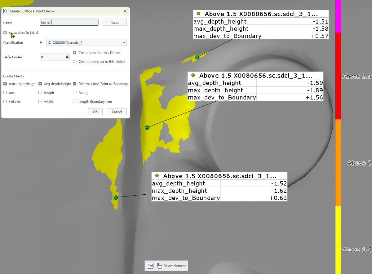

There was an App in 2023 to "Create Surface Defect Checks" which would create a deviation label for every deviation island in a surface defect classification.
we upgraded to 2025 and then realized this script is no longer compatablee (unless SDCL in legacy mode?)
if you're using 2023

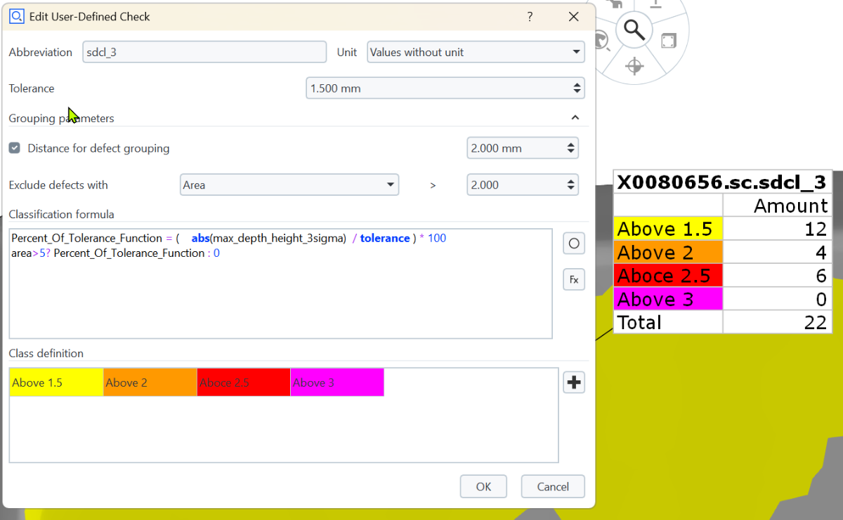

These were the parameters I used for the classification formula (basically how far above the 1.5mm tolerance is it)
This is the user defined dialog prompt & results:
you can patch the original add on to extract other attributes in the SDCL table (max_depth_heigh(3sigma)) pretty easily.
I used to use it with kiosk mode to auto label the OOT areas,
I believe I copied the code in the add on and added it as an external module so I could access it through the kiosk interface easier..
here was the function I wrote in "Custom Patches"
