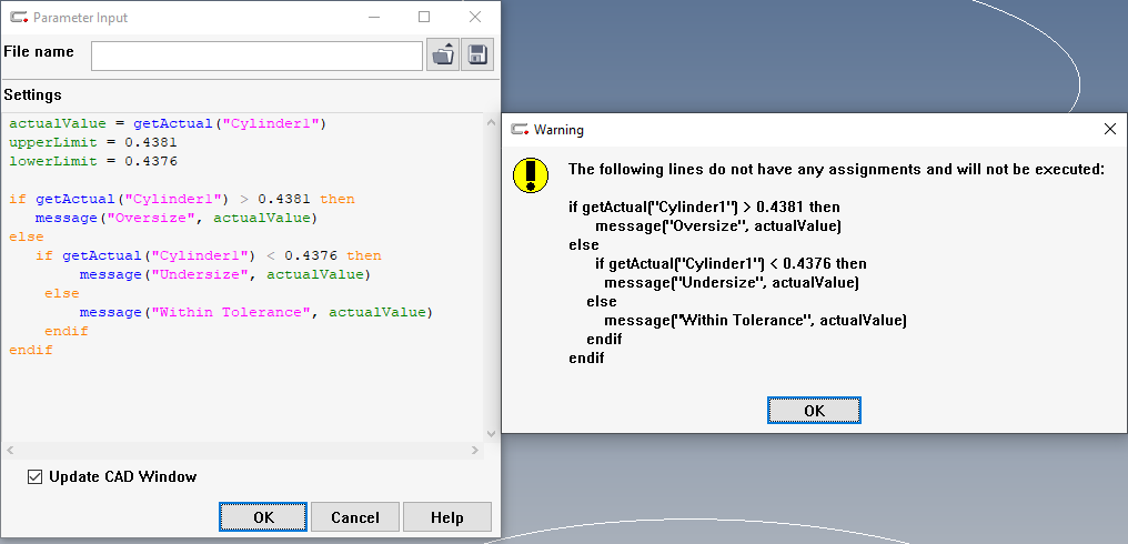

[Ch...] Posted July 30, 2025 Share Posted July 30, 2025 (edited) Forgive me for my green ignorance: My company recently obtained a PCM license for the various part families we produce. I was taught how to use it specifically in the case of changing sizes and tolerances of features, but this is a VERY simple Parameter that was created for me and sent down from corporate. I am hungry to learn how to properly use PCM and unlock its true potential. So, I have been messing around with it for a few days with some basic parameters in order to learn how the PCM Syntax works, but I am running into a problem with probably a simple solution that I seem to be missing. Can anyone tell me what I am doing wrong? P.S. I know that I should probably go to the PCM course, but I would need to convince management to fly me out of state for training. So, for now I am attempting to self-learn by trial and error. Suggestions and reference material are welcome! Edited July 30, 2025 extra letter Link to comment https://qualityforum.zeiss.com/topic/24069-learning-pcm/ Share on other sites More sharing options...
[Ch...] Posted July 30, 2025 Share Posted July 30, 2025 (edited) getActual needs .diameter at the end, otherwise well done I suggest taking official Zeiss course- then read through many topics here. good luck. getActual can have many 'instance variables', such as .x,.y,.z,.radius,.diameter, etc. Edited July 30, 2025 1 1 Link to comment https://qualityforum.zeiss.com/topic/24069-learning-pcm/#findComment-135969 Share on other sites More sharing options...
[Ke...] Posted July 30, 2025 Share Posted July 30, 2025 (edited) It looks like you didnt tell it what "actual" you are looking for, IE getActual("Cylinder1").diameter. Additionally, I would suggest looking into using caseSelect as opposed to nested If-Else statements. Nested If-Else are very difficult to scale up, and very easy to create conditions where they do not work, accidentally. There is also a very good in-depth PCM manual included in the installation of your software, along with a number of other manuals. They can be found in C:\Program Files (x86)\Zeiss\CALYPSO X.x\userinfo\manuals Edited July 30, 2025 1 Link to comment https://qualityforum.zeiss.com/topic/24069-learning-pcm/#findComment-135971 Share on other sites More sharing options...
[Ke...] Posted July 30, 2025 Share Posted July 30, 2025 Additionally, you dont necessarily need to convince them to fly you out, Zeiss does offer PCM training in a live online format. Link to comment https://qualityforum.zeiss.com/topic/24069-learning-pcm/#findComment-135977 Share on other sites More sharing options...

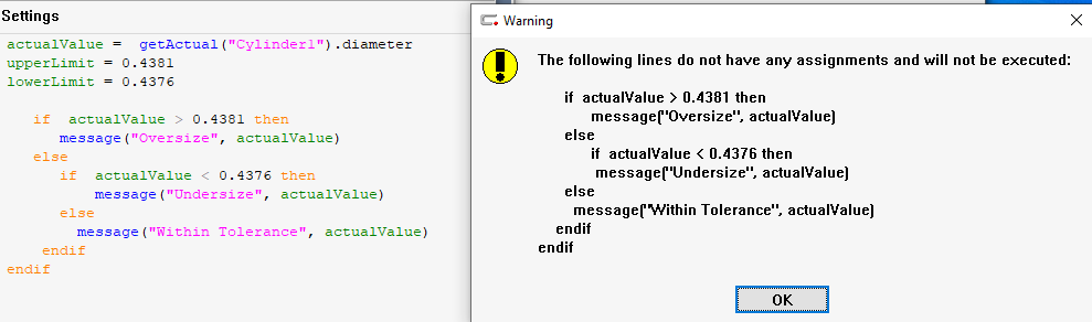

[Ch...] Posted July 30, 2025 Author Share Posted July 30, 2025 I appreciate the quick responses! I've added .diameter to the assignment and it still gives me the same error. I tested the same getActual("Cylinder1").diameter in the feature's diameter box as a formula and it works. Any ideas on why it is ignoring the assignments within PCM parameter? It appears to be structured correctly, even verifying with the PCM Manual that Please sign in to view this username. suggested. I had also swapped the extra "getActuals" with the assignments already set. actualValue = getActual("Cylinder1").diameter upperLimit = 0.4381 lowerLimit = 0.4376 if actualValue > 0.4381 then message("Oversize", actualValue) else if actualValue < 0.4376 then message("Undersize", actualValue) else message("Within Tolerance", actualValue) endif endif Link to comment https://qualityforum.zeiss.com/topic/24069-learning-pcm/#findComment-135997 Share on other sites More sharing options...
[Ke...] Posted July 30, 2025 Share Posted July 30, 2025 Try actualValue = getActual("Cylinder1").diameter upperLimit = 0.4381 lowerLimit = 0.4376 if actualValue > 0.4381 then message("Oversize", actualValue) else if actualValue < 0.4376 then message("Undersize", actualValue) else message("Within Tolerance", actualValue) endif endif Link to comment https://qualityforum.zeiss.com/topic/24069-learning-pcm/#findComment-135999 Share on other sites More sharing options...

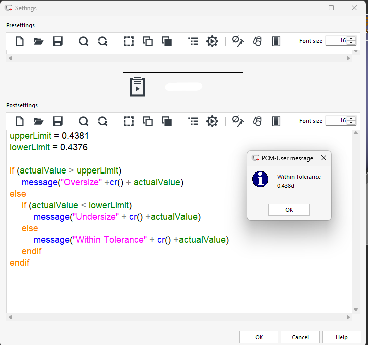

[Ri...] Posted July 30, 2025 Share Posted July 30, 2025 (edited) One thing I would suggest is that you do not need "then" in the code. In addition, I would strongly suggest to enclose comparisons inside of parentheses. actualValue = getActual("Cylinder1").diameter upperLimit = 0.4381 lowerLimit = 0.4376 if (actualValue > upperLimit) message("Oversize" +cr() + actualValue) else if (actualValue < lowerLimit) message("Undersize" + cr() +actualValue) else message("Within Tolerance" + cr() +actualValue) endif endif Edited July 30, 2025 1 Link to comment https://qualityforum.zeiss.com/topic/24069-learning-pcm/#findComment-136001 Share on other sites More sharing options...

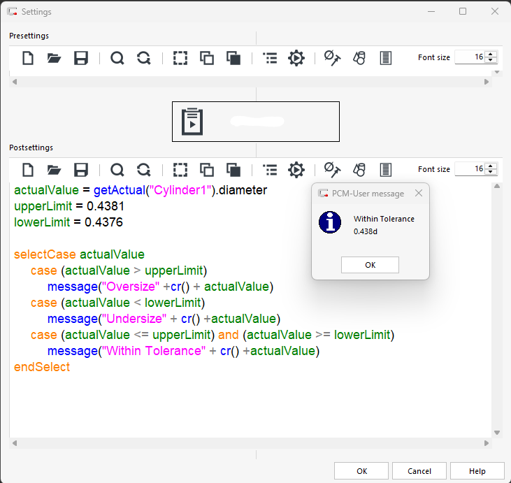

[Ri...] Posted July 30, 2025 Share Posted July 30, 2025 (edited) But as Kevin said, selectCase would be much cleaner and easier to manage. actualValue = getActual("Cylinder1").diameter upperLimit = 0.4381 lowerLimit = 0.4376 selectCase actualValue case (actualValue > upperLimit) message("Oversize" +cr() + actualValue) case (actualValue < lowerLimit) message("Undersize" + cr() +actualValue) case (actualValue <= upperLimit) and (actualValue >= lowerLimit) message("Within Tolerance" + cr() +actualValue) endSelect Edited July 30, 2025 2 1 Link to comment https://qualityforum.zeiss.com/topic/24069-learning-pcm/#findComment-136003 Share on other sites More sharing options...
[Ch...] Posted July 30, 2025 Author Share Posted July 30, 2025 Putting the code into post-settings made it function, and I used the selectCase example since it is a lot easier to understand and visualize. My only other question is what are the differences between "Plan->Advanced->Parameter", the PCM Editor, and Pre/post settings? The post and presetting's are kind of self-explanatory to a degree, but that same code can't be placed into "Parameter" with success. Is the Majority of PCM used within Post and presetting's? Sorry for asking the obvious, but I am just trying to come away from this having learned as much as I can regarding my issue to prevent it from happening again. Link to comment https://qualityforum.zeiss.com/topic/24069-learning-pcm/#findComment-136009 Share on other sites More sharing options...
[Ch...] Posted July 30, 2025 Share Posted July 30, 2025 That is where you 'should' declare your variables. You may notice at time when typing PCM into a random field, sometimes NUM=123 the NUM doesnt turn green as if its a variable, declaring your variables in Plan->Adv->Parameter helps with this. Where the majority of PCM is used is highly dependent on the situation, some people use it everywhere , pre/post ; features and outside of program. 1 Link to comment https://qualityforum.zeiss.com/topic/24069-learning-pcm/#findComment-136011 Share on other sites More sharing options...
[Ri...] Posted July 30, 2025 Share Posted July 30, 2025 I didn't even notice that the code was being placed in the Parameter section. Oops. Yeah, makes sense why you were seeing issues. I would strongly advise to always declare variables inside of the Parameter section. If you are declaring them inside of the Pre/Post settings of a feature, characteristic, or measurement plan, you can potentially run into issues where they do not exist in the measurement plan until that portion is executed. 1 1 Link to comment https://qualityforum.zeiss.com/topic/24069-learning-pcm/#findComment-136013 Share on other sites More sharing options...

[No...] Posted August 4, 2025 Share Posted August 4, 2025 The Parameter section is executed before the measurement plan does even start. So its only meaningful purpose is to store variable declarations that need to exist before the first PCM statement is executed. It's not an absolute necessity to use it, but as the others mentioned, it's recommended. Apart from that, every element (features, characteristics, even conditions and the whole measurement plan) has pre- and post settings. Pre is for code to be executed before the element (e.g. to set a tolerance variable used in a formula in the element) and post is for code that runs after the element (when measuring results are available). 1 Link to comment https://qualityforum.zeiss.com/topic/24069-learning-pcm/#findComment-136221 Share on other sites More sharing options...
