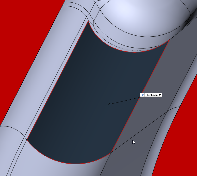

[TH...] Posted July 30, 2025 Share Posted July 30, 2025 I have a curved surface seen in the image attached. I want to generate a line/series of points that are the lowest on the surface (lowest Z-locations). I have a symmetric surface on the other side of the part, and would want to do the same thing and then find the widths between each pair of points. How can I go about creating these points on the surface? I tried creating equidistant inspection points on the surface which look promising but I can't confirm if they are the lowest points on the surface. Any help would be appreciated. Link to comment https://qualityforum.zeiss.com/topic/24073-line-of-lowest-points-on-a-surface/ Share on other sites More sharing options...
[Ra...] Posted July 30, 2025 Share Posted July 30, 2025 There's a few ways to go about this. If you have curve: You can do multiple curves on each surface at the same heights. Then use the minimum/maximum coordinate feature to get the lowest associated point that corresponds with the axis you choose. Then distance those points. If you don't: You could use circles at the same heights, then do a caliper distance, toggling between maximum and minimum to suit your needs. Link to comment https://qualityforum.zeiss.com/topic/24073-line-of-lowest-points-on-a-surface/#findComment-135995 Share on other sites More sharing options...
