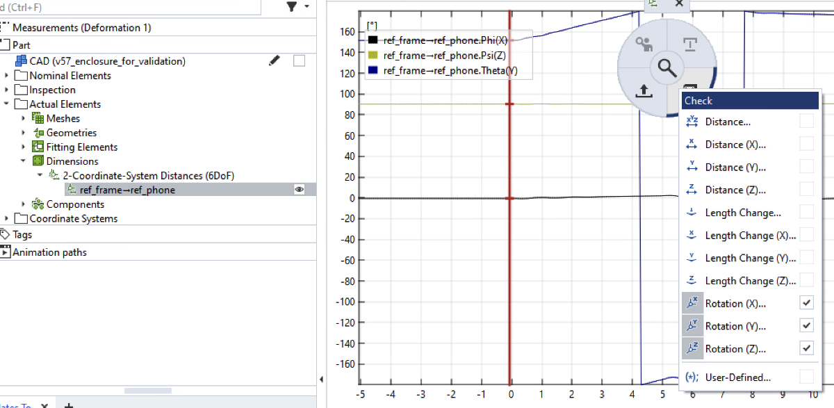

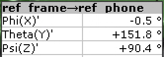

[Fr...] Posted July 31, 2025 Share Posted July 31, 2025 I have set up a 2 coordinate system distance. And I would like to measure the rotations from my reference frame to local frame. The outputs are three angles phi, theta, psi. I would like to know are those angles extrinsic Euler angles? If so, what are the rotation sequence? Can someone point me to the corresponding user guide/documentations? Link to comment https://qualityforum.zeiss.com/topic/24087-what-are-the-rotation-sequence-of-the-euler-angles-measured-from-2-coordinate-system-distances-6dof/ Share on other sites More sharing options...
[Be...] Posted August 18, 2025 Share Posted August 18, 2025 Hi, the angles are extrinsic euler angles (means: the coordinate axis stays fixed after applying the rotations). The coordinate system for evaluation is usually your first coordinate system and the evaluation (rotation) order is: Y - X - Z Keep in mind: Usually you have two possible solutions how you can achieve the rotational state (only one possible calculation result is displayed)! Hope this helps?! Regards, Link to comment https://qualityforum.zeiss.com/topic/24087-what-are-the-rotation-sequence-of-the-euler-angles-measured-from-2-coordinate-system-distances-6dof/#findComment-136891 Share on other sites More sharing options...
