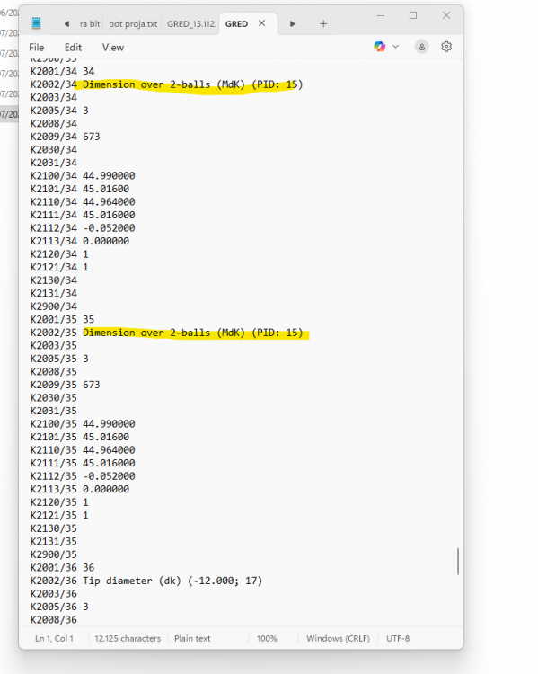

[Em...] Posted July 31, 2025 Share Posted July 31, 2025 (edited) I have a DFQ file that contains two identical characteristics, which is not allowed in our data. How can I split-delete one row of characteristics in the DFQ file export? Edited July 31, 2025 Link to comment https://qualityforum.zeiss.com/topic/24091-gearpro-qdas-export-have-two-charactheristics-mdk/ Share on other sites More sharing options...
[Ro...] Posted July 31, 2025 Share Posted July 31, 2025 Hi Emiljan, please provide your .act for giving an answer to that point. Thank you. Link to comment https://qualityforum.zeiss.com/topic/24091-gearpro-qdas-export-have-two-charactheristics-mdk/#findComment-136079 Share on other sites More sharing options...
[Em...] Posted July 31, 2025 Author Share Posted July 31, 2025 Hi Roman, thanks for the quick reply if I understood correctly ".act" I add an explanation. GearPRo generates a dfq.file in which it write the two rows with same name (Mdk characteristics), but our Q-DAS database cannot proces them beacause the file contains two rows with the same name. I would like Generate the dfq.file whith only one row of the Mdk. or did you mean to send the qdf file? Thank you. Link to comment https://qualityforum.zeiss.com/topic/24091-gearpro-qdas-export-have-two-charactheristics-mdk/#findComment-136081 Share on other sites More sharing options...

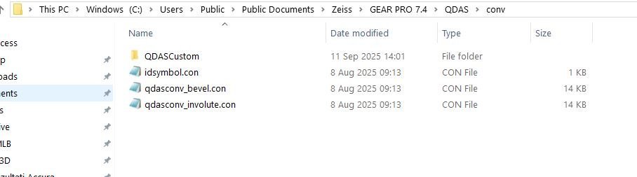

[Ro...] Posted August 1, 2025 Share Posted August 1, 2025 Good morning, can you please also share your "qdasconv_involute.con" from the folder "C:\Users\Public\Documents\Zeiss\GEAR PRO 7.x\QDAS\conv". If I export as dfd/dfx with the latest GEAR PRO 2025 (7.4) version I get only one characteristic "Dimension over 2 balls" as expected. Your GEAR PRO version is 2024 (7.2.0000), correct? Link to comment https://qualityforum.zeiss.com/topic/24091-gearpro-qdas-export-have-two-charactheristics-mdk/#findComment-136135 Share on other sites More sharing options...
[Em...] Posted August 1, 2025 Author Share Posted August 1, 2025 good morning to you too yes, we are using 7.2 and I have modified "qdasconv_involute.con" a little, I am sending both. Thank you. qdasconv_involute.con qdasconv_involute_original.con Link to comment https://qualityforum.zeiss.com/topic/24091-gearpro-qdas-export-have-two-charactheristics-mdk/#findComment-136137 Share on other sites More sharing options...

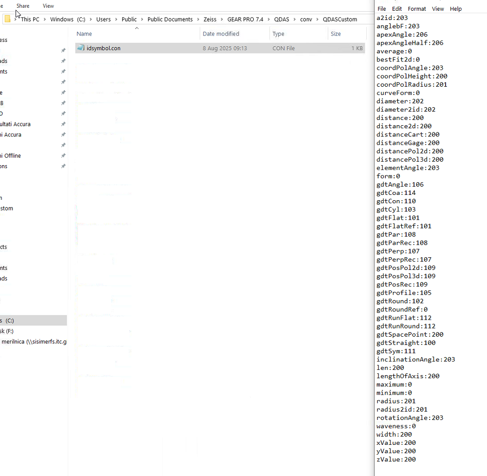

[Ro...] Posted August 1, 2025 Share Posted August 1, 2025 Is it possible that you have in the subfolder "C:\Users\Public\Documents\Zeiss\GEAR PRO 7.x\QDAS\conv\QDASCustom" a second .con? With your .con I get only one MdK value in the .dfq as you expect. In both versions 7.2 and 7.4 (I use the latest versions from the ZEISS Portal). Maybe you download the latest version and try again. I can´t find a software bug. Link to comment https://qualityforum.zeiss.com/topic/24091-gearpro-qdas-export-have-two-charactheristics-mdk/#findComment-136139 Share on other sites More sharing options...

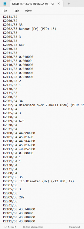

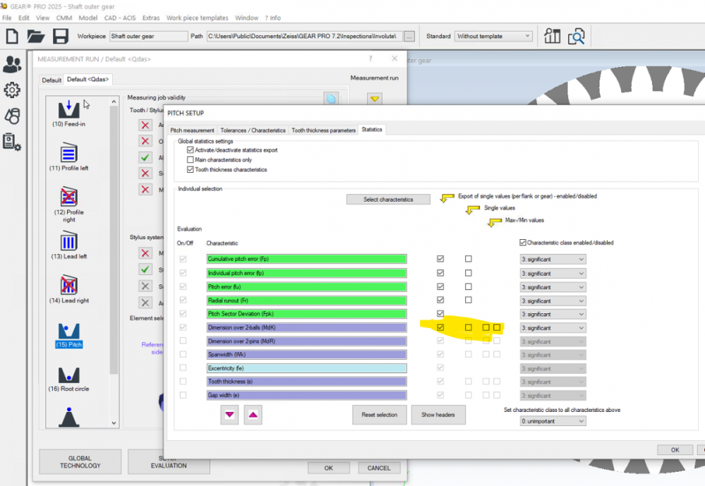

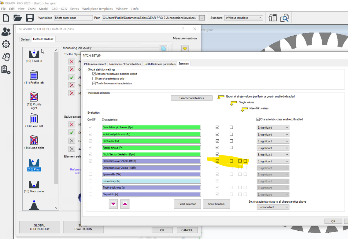

[Em...] Posted September 11, 2025 Author Share Posted September 11, 2025 I installed GearPro 2025 and it works the same – two outputs for Mdk. I reached the function where I can partially modify or disable the output (picture), but this characteristic always results in a double output... I'm losing patience. Link to comment https://qualityforum.zeiss.com/topic/24091-gearpro-qdas-export-have-two-charactheristics-mdk/#findComment-138231 Share on other sites More sharing options...
[Ro...] Posted September 11, 2025 Share Posted September 11, 2025 Have you checked if there is a .con in this folder? "C:\Users\Public\Documents\Zeiss\GEAR PRO 7.x\QDAS\conv\QDASCustom" Link to comment https://qualityforum.zeiss.com/topic/24091-gearpro-qdas-export-have-two-charactheristics-mdk/#findComment-138233 Share on other sites More sharing options...
[Em...] Posted September 11, 2025 Author Share Posted September 11, 2025 only this Link to comment https://qualityforum.zeiss.com/topic/24091-gearpro-qdas-export-have-two-charactheristics-mdk/#findComment-138235 Share on other sites More sharing options...
[Ro...] Posted September 11, 2025 Share Posted September 11, 2025 And one subfolder higher you have only one qdas_involute.con Link to comment https://qualityforum.zeiss.com/topic/24091-gearpro-qdas-export-have-two-charactheristics-mdk/#findComment-138237 Share on other sites More sharing options...
[Em...] Posted September 11, 2025 Author Share Posted September 11, 2025 two file Link to comment https://qualityforum.zeiss.com/topic/24091-gearpro-qdas-export-have-two-charactheristics-mdk/#findComment-138239 Share on other sites More sharing options...

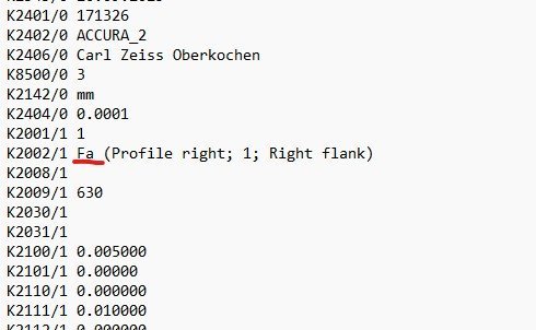

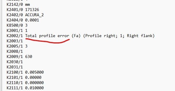

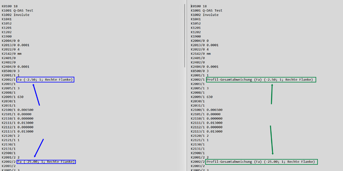

[Em...] Posted September 26, 2025 Author Share Posted September 26, 2025 Hi our support team created the program, and we only run it. They don't have experience with Q-DAS export. Now, I created the program from begining using our Gear Pro 2025, and it no longer outputs two Mdk values :). However, I now have a different issue 🙂 The output has changed... there are no longer characteristic names, only symbols... and Q-DAS database again detects this as duplication. I would like to have the output with full characteristic names again — how can I do that? Link to comment https://qualityforum.zeiss.com/topic/24091-gearpro-qdas-export-have-two-charactheristics-mdk/#findComment-139017 Share on other sites More sharing options...

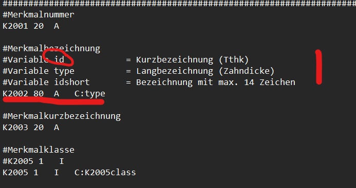

[Ro...] Posted October 1, 2025 Share Posted October 1, 2025 You have to modify the qdasconv_involute.con again. K2002 80 A C:type => .... C:id Link to comment https://qualityforum.zeiss.com/topic/24091-gearpro-qdas-export-have-two-charactheristics-mdk/#findComment-139289 Share on other sites More sharing options...

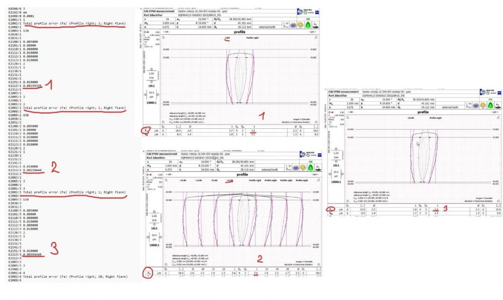

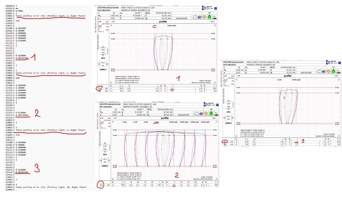

[Em...] Posted October 3, 2025 Author Share Posted October 3, 2025 Thank you, everything is working now. I had to write the "type" 🙂. However, I have another problem: 😅 I'm using a measuring strategy with a "twist" - three heights, and it generates the same name repeatedly. This causes an issue in the Q-DAS database, which flags the duplicate names and doesn't work properly. How can I fix this? Link to comment https://qualityforum.zeiss.com/topic/24091-gearpro-qdas-export-have-two-charactheristics-mdk/#findComment-139469 Share on other sites More sharing options...
[Ro...] Posted October 9, 2025 Share Posted October 9, 2025 Hi, sorry I can´t answer your phenomenon? I just tested the exports with "C:type" (green in the screenshot) and "C:id" (blue). In both cases the height of the twist measurement position is included in the DFD file. Something seems to be really strange in your qdasconv_involute.con. Maybe you use the orginial one which GEAR PRO provides with every installation? Link to comment https://qualityforum.zeiss.com/topic/24091-gearpro-qdas-export-have-two-charactheristics-mdk/#findComment-139773 Share on other sites More sharing options...
