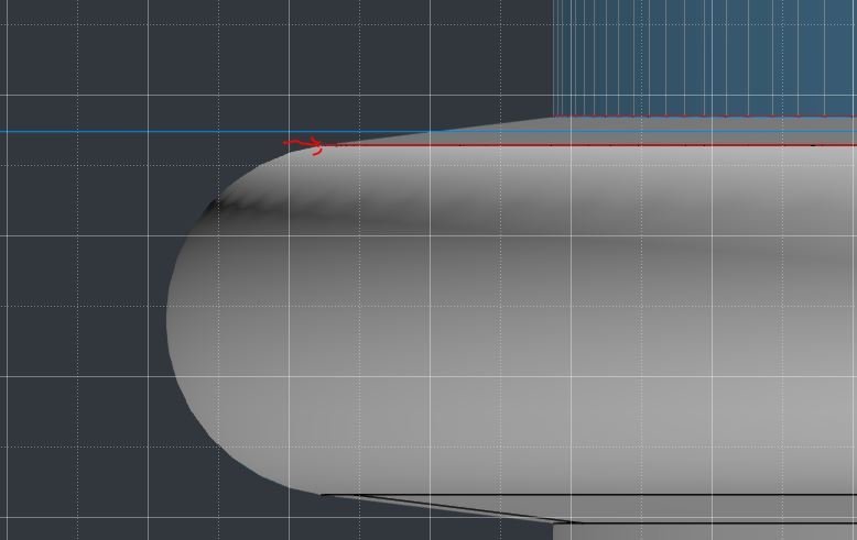

[Br...] Posted July 31, 2025 Share Posted July 31, 2025 (edited) Anyone know how I get a plane to lay at the bottom of this section (at upper tangent from the large radius)? The default is obviously going to place it in the middle of the section shown. I have played around with Meas principle, but struggling to find an answer, as the initial build is nominal at mid-height. Any assist appreciated, as always Edited July 31, 2025 add pic Link to comment https://qualityforum.zeiss.com/topic/24093-plane-on-angled-section/ Share on other sites More sharing options...
[Na...] Posted July 31, 2025 Share Posted July 31, 2025 Hi Brian, there is a radius entry curve, which looks like it would fit this application: https://techguide.zeiss.com/en/zeiss-inspect-2025/article/cmd_curve_create_radius_entry_curve.html Link to comment https://qualityforum.zeiss.com/topic/24093-plane-on-angled-section/#findComment-136089 Share on other sites More sharing options...
