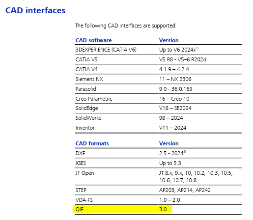

[Lu...] Posted July 31, 2025 Share Posted July 31, 2025 Hello Pat, It sounds like you need a QIF import license. I would recommend reaching out to your aftermarket sales rep for more information and/or a quote. Additionally, you'll need to make sure that the QIF files you need to import are compatible with CALYPSO 7.4. From CALYPSO 7.4 release notes: Hope this helps. 1 Link to comment https://qualityforum.zeiss.com/topic/24095-model-as-qif/#findComment-136097 Share on other sites More sharing options...
[Pa...] Posted July 31, 2025 Author Share Posted July 31, 2025 Certainly gets me moving in a direction. Thanks Lucas. 1 Link to comment https://qualityforum.zeiss.com/topic/24095-model-as-qif/#findComment-136103 Share on other sites More sharing options...
