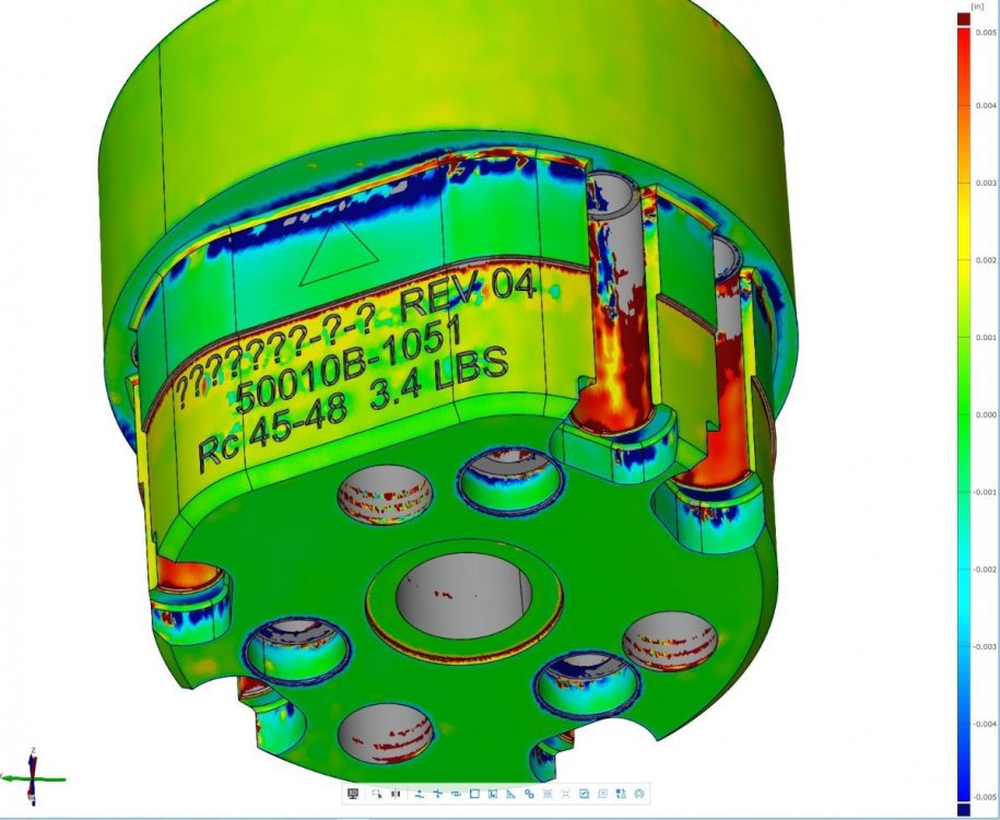

[Se...] Posted July 31, 2025 Share Posted July 31, 2025 HOW TO SPOT AND FIX FAKE PATCHES (NOT TRUE MATERIAL CONDITION) ON SOME AREAS IN SURFACE COMPARISON IN ZIESS INSPECT 2025. IF YOU SEE ATTACHED SNAPSHOT, YOU CAN SEE THERE ARE LOTS OF FAKE BLUE PATCHES WHICH ARE NOT TRUE. I TRIED CHANGING VALUES ON MAXIMUM ERROR BUT THATS NOT THE SOLUTION. PLEASE LET ME KNOW HOW TO SOLVE THIS ISSUE. THANKS Link to comment https://qualityforum.zeiss.com/topic/24097-fake-patches-on-surface-comparison/ Share on other sites More sharing options...
[Ri...] Posted July 31, 2025 Share Posted July 31, 2025 Do you see this same issue on CAD Evaluation on Actual? Link to comment https://qualityforum.zeiss.com/topic/24097-fake-patches-on-surface-comparison/#findComment-136117 Share on other sites More sharing options...
[Be...] Posted August 19, 2025 Share Posted August 19, 2025 Have you tried to disable the flag 'Collect local deviation peaks' (Expert parameters)? If this removes the "problems" and you have ensured that the sampling of the CAD is 'good' enough for detecting local deviation peaks stay with this setting. If you need to keep this setting ('Collect local deviation peaks') you can try to adjust the settings for the 'Max. opening angle' and the allowed 'Max deviation of normals'. Regards Link to comment https://qualityforum.zeiss.com/topic/24097-fake-patches-on-surface-comparison/#findComment-136993 Share on other sites More sharing options...
