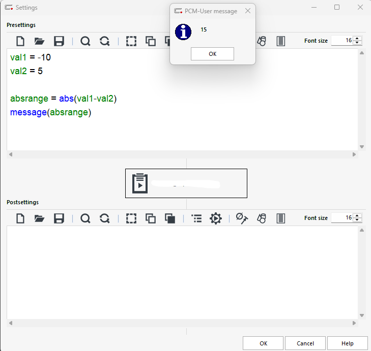

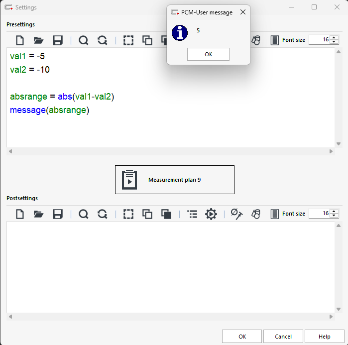

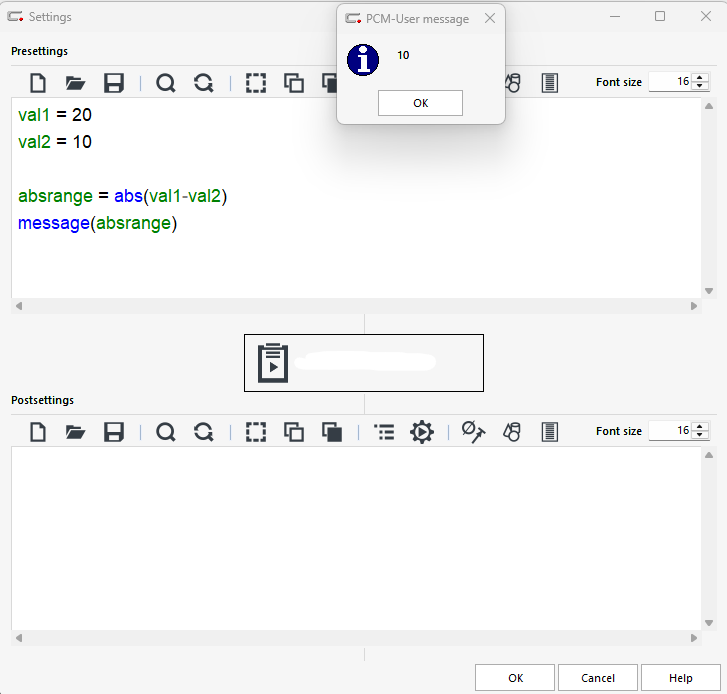

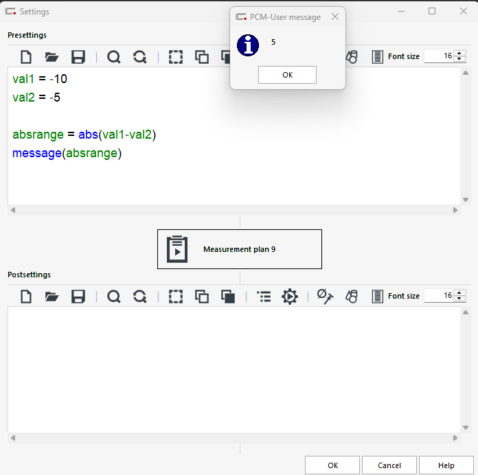

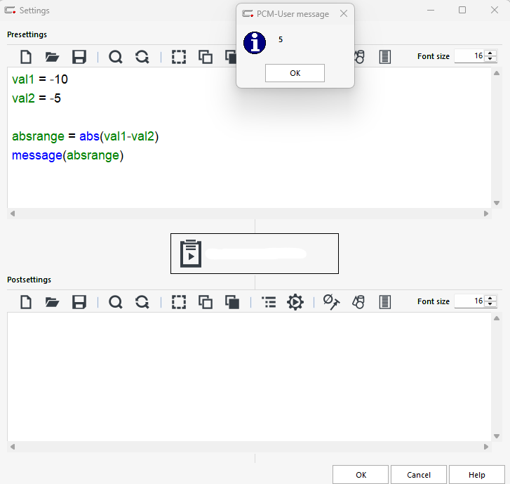

[Ri...] Posted August 1, 2025 Share Posted August 1, 2025 I think it should just be: val1 = 5 val2 = -10 absrange = abs(val1-val2) Link to comment https://qualityforum.zeiss.com/topic/24107-calculate-range-from-negative-max-and-min-values/#findComment-136189 Share on other sites More sharing options...
[Ri...] Posted August 1, 2025 Share Posted August 1, 2025 2 Link to comment https://qualityforum.zeiss.com/topic/24107-calculate-range-from-negative-max-and-min-values/#findComment-136191 Share on other sites More sharing options...

[To...] Posted August 4, 2025 Author Share Posted August 4, 2025 (edited) Richard, in all of your test values, you inadvertently filled the Max (absolute) value as val1, so when you calculated the abs(val1 - val2), the math always works. In the first example val1 = -10 and val2 = -5. However, -5 is greater than -10. I think Mark might be onto something. Edited August 4, 2025 Link to comment https://qualityforum.zeiss.com/topic/24107-calculate-range-from-negative-max-and-min-values/#findComment-136237 Share on other sites More sharing options...

[Ri...] Posted August 4, 2025 Share Posted August 4, 2025 Please sign in to view this quote. Tom, There are no issues swapping which one is val1 and which one is val2. 2 Link to comment https://qualityforum.zeiss.com/topic/24107-calculate-range-from-negative-max-and-min-values/#findComment-136241 Share on other sites More sharing options...
