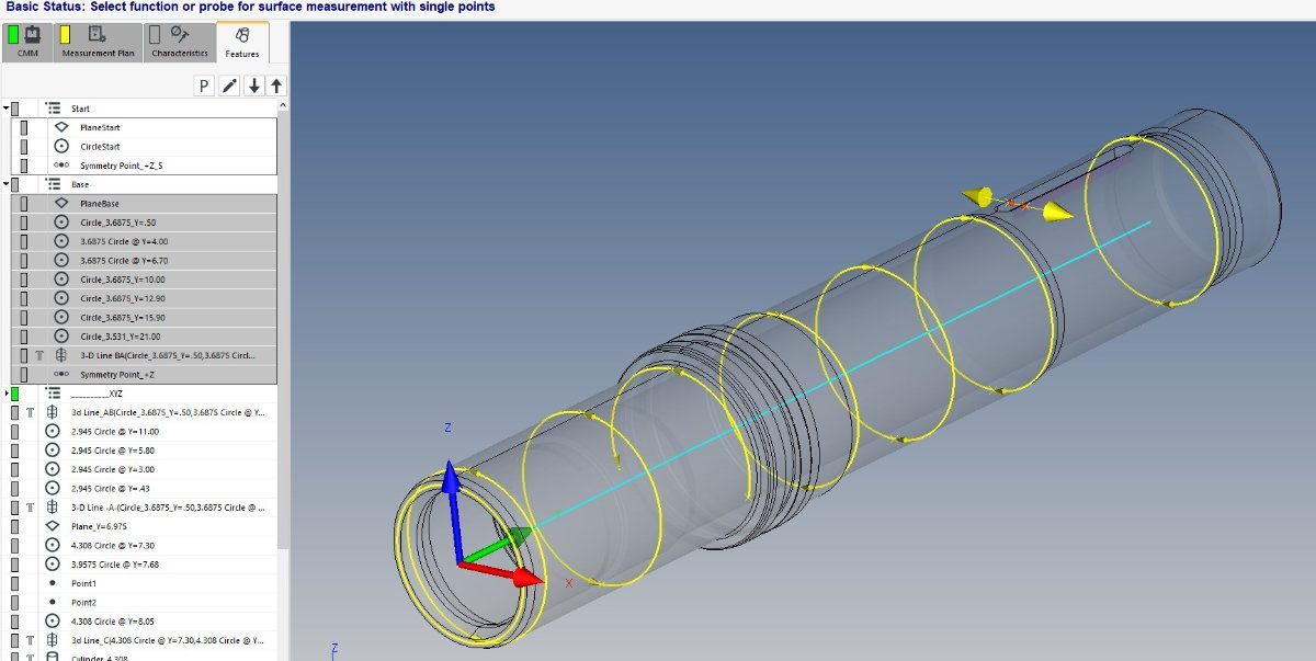

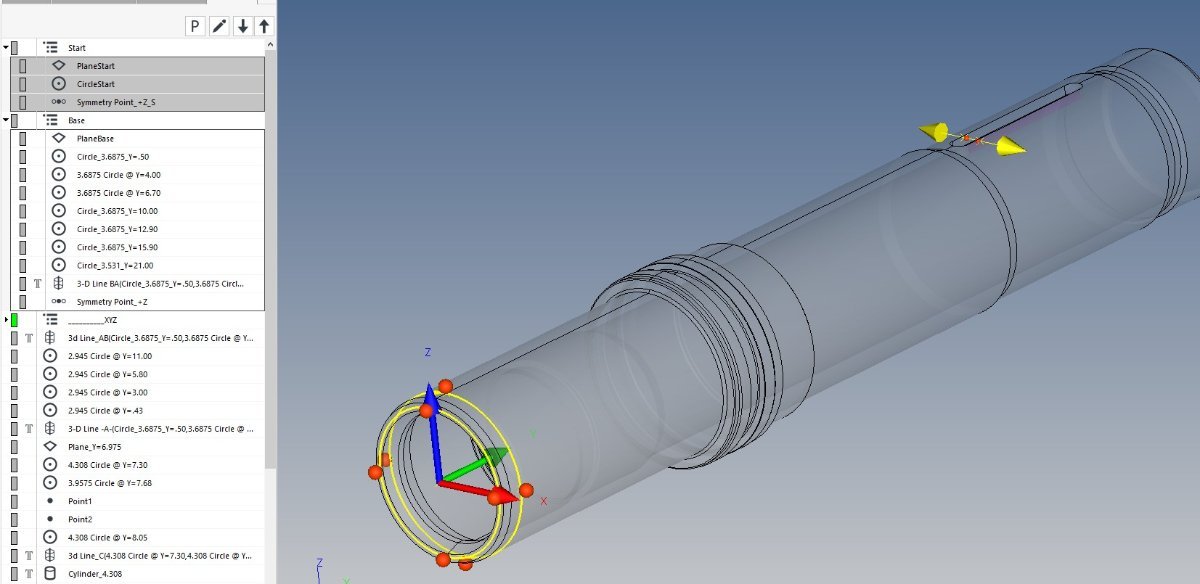

[Du...] Posted August 7, 2025 Share Posted August 7, 2025 start alignment are generally much simpler alignments than the base alignments, usually easier to reach features or features that are quicker to manually probe. in the attached screenshots my base alignment and start are similar but in the start alignment i use a single circle. Link to comment https://qualityforum.zeiss.com/topic/24161-base-alignment-vs-start-alignment/#findComment-136501 Share on other sites More sharing options...

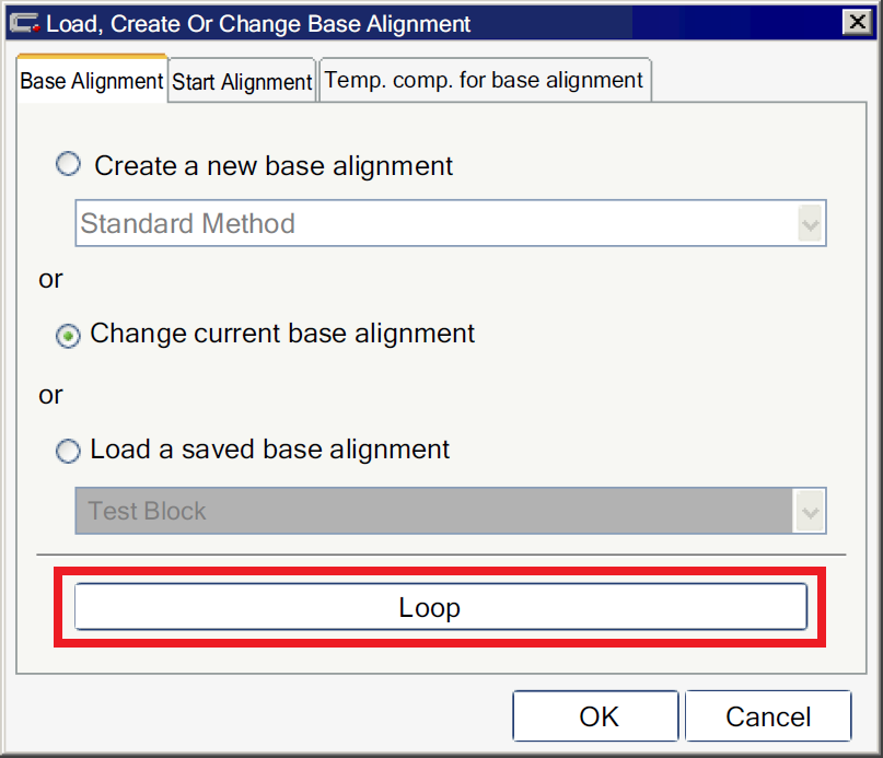

[La...] Posted August 14, 2025 Author Share Posted August 14, 2025 (edited) Please sign in to view this quote. Thank you for the reply. I've been seeing others mention loops, I wasn't sure how to properly do them and was wondering if you'd be able to explain the basics of how to properly do a loop on a base alignment if you don't mind. Edited August 14, 2025 1 Link to comment https://qualityforum.zeiss.com/topic/24161-base-alignment-vs-start-alignment/#findComment-136787 Share on other sites More sharing options...
[Ma...] Posted August 14, 2025 Share Posted August 14, 2025 (edited) No problem. What LOOPs do in base alignment is - machine runs base alignment from previous known origin and vectors ( start alignment and other methods ). Now machine knows a new position of origin and vectors and is preforming new base alignment from that new position. For enabling loops you go program alignment window and click "LOOP" button. Basic formula for stopping loop prematurely is "baseSystem().valueA<0.05" where value "0.05" is maximum allowed movement. So you can define 10 loops, but with this it can stop earlier. For details look into manual for your version and look for "Iteratively adapting the base alignment". <- this works only for base alignment One thing to note - if you want this iterative loop for alignment in a program ( not base or start align. ) then looping features won't bring this correction. It runs on same place X times as defined in a loop. Edited August 14, 2025 2 Link to comment https://qualityforum.zeiss.com/topic/24161-base-alignment-vs-start-alignment/#findComment-136791 Share on other sites More sharing options...
