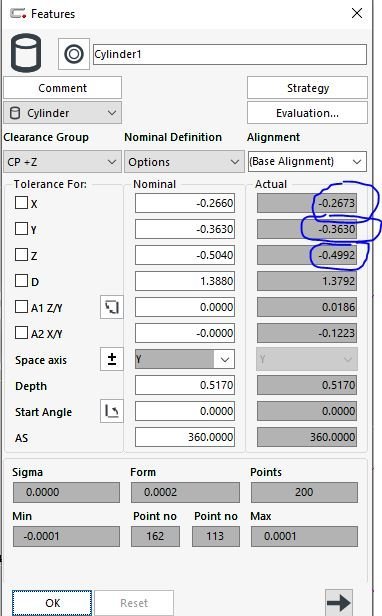

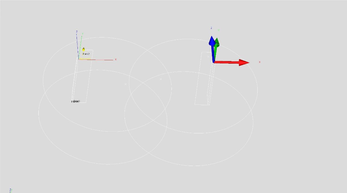

[Qu...] Posted August 11, 2025 Share Posted August 11, 2025 Hello everyone, I am trying to run two of the same parts in the same program. The reason being it is a small part and instead of having needing a lot of fixtures, I am trying to have one fixture with 2 pieces instead of one. The problem being is when I try to create a new alignment for the second part, the result are usually bad. Is there a problem with my approach or is it an alignment issue? The example I attached is a rough alignment I am testing out ( I did try to set up a complete DRF before and the results are still bad) I also made sure the two CAD are still separated and not merged into one. Thank you. Link to comment https://qualityforum.zeiss.com/topic/24181-having-two-models-in-the-same-program/ Share on other sites More sharing options...

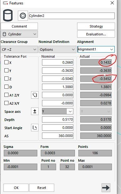

[Ma...] Posted August 11, 2025 Share Posted August 11, 2025 Is it mirrored part or just turned around Z axis? As far as i know you can not have more models used as "workpiece" - you would need to merge it. From your initial screenshot you have something bad in alignment1 - perhaps wrong primary plane. If your cylinder2 is used in alignment1 then it should have correct A1,A2 and location. Are you sure you are using correct evaluation ( like tangential )? Link to comment https://qualityforum.zeiss.com/topic/24181-having-two-models-in-the-same-program/#findComment-136647 Share on other sites More sharing options...

[Ma...] Posted August 12, 2025 Share Posted August 12, 2025 Don't get me wrong, but your actuals for Cylinder2 in Alignment1 doesn't match with nominals -> something wrong is in Alignment1. You should have similar actuals as for Cylinder1 in Base Alignment. This is have nothing to do with models. Models will be in play for surface profile with selected face. Link to comment https://qualityforum.zeiss.com/topic/24181-having-two-models-in-the-same-program/#findComment-136657 Share on other sites More sharing options...
[Qu...] Posted August 12, 2025 Author Share Posted August 12, 2025 That is what I am trying to figure out. My Alignment 1 is the same set up as the other alignment. However the results are still off. Link to comment https://qualityforum.zeiss.com/topic/24181-having-two-models-in-the-same-program/#findComment-136689 Share on other sites More sharing options...

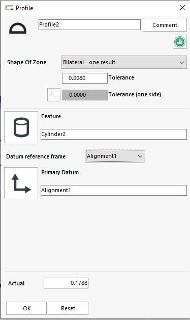

[Ha...] Posted August 18, 2025 Share Posted August 18, 2025 From what I'm gathering about the setup, I don't recommend going this route if you're getting bad results. Like Mark had mentioned, I would create a program for a single part and set up the pallet that way. This is robust compared to what is being attempted here. If you really do need it set up in the way that's described, the closest idea I can think of is to use the LOS POS option, which defines the alignment of each piece. However, you will need to create copies of the part program for each location on the pallet. https://portal.zeiss.com/knowledge-base?id=444321 Link to comment https://qualityforum.zeiss.com/topic/24181-having-two-models-in-the-same-program/#findComment-136933 Share on other sites More sharing options...
